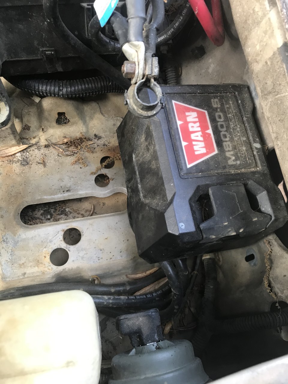

    i have mine in the inner curve of the fender behind the battery. battery needed an extended platform to sit on but theres enough space and it looks clean

    Mine is in the same location.

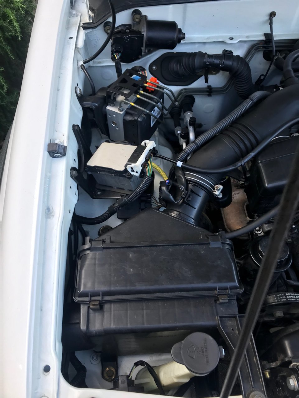

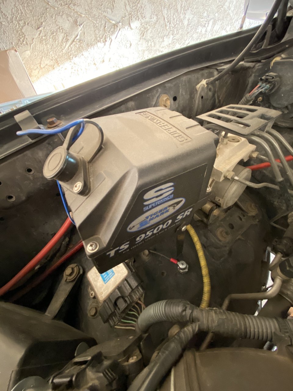

    Not a Warn winch. I remote mounted the controller under the hood and added a wireless controller to it.

    Closer shot of controller
    wourkrsd[OP] likes this.

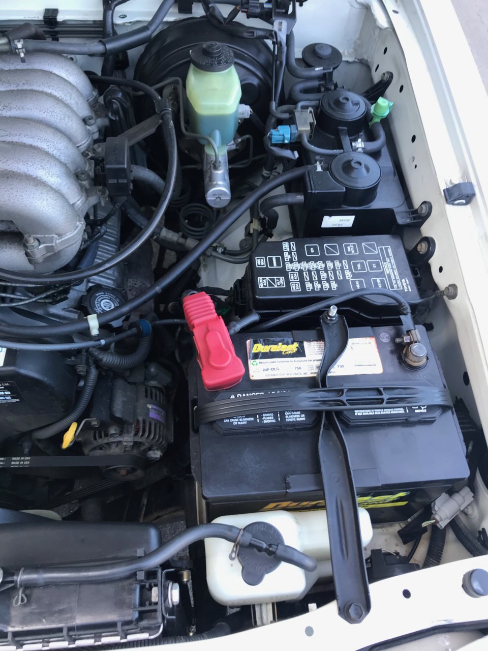

    That looks great and mine would probably fit there too, but I have a big OEM box of something-ness there...possibly the cruise control!?

    My truck is fully loaded. Cruise is on other side. ABS pump is next to controller.
    Not sure what is in your rig.
    Any pictures?

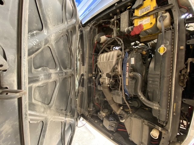

    You are correct, the cruise control is right where Toyrunner has mounted his winch control. I’m guessing that th box with what looks like brake lines running to it is the ABS? The newer the trucks the busier it get under the hood.

    I guess there are always changes going on year to year with these trucks. My cruise is on other side

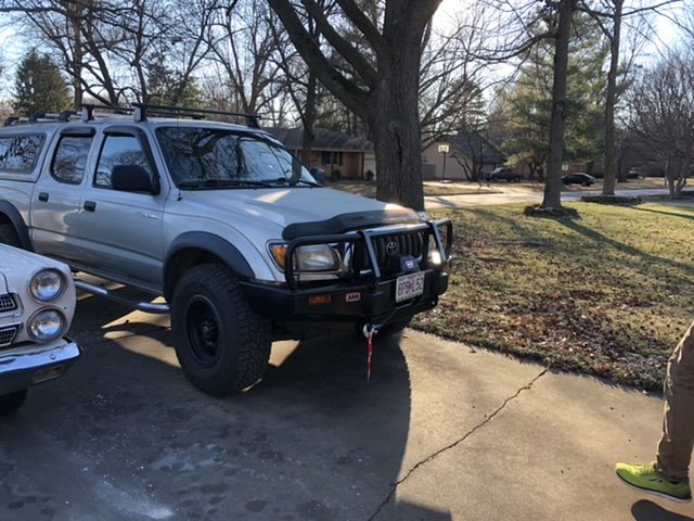

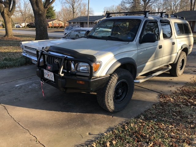

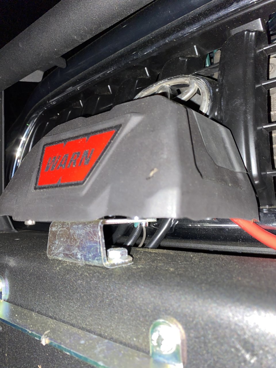

    The arb bumper is designed for you to mount it straight to it. I didn’t have to drill anything. It sits nicely right there in front of the grill.

    Thanks, I hear what ur saying...and almost every pic of a gen 1 with a warn shows the controller mounted to the bumper.
    As you know products change, and for whatever reason the holes on top of the bumper are left-right when the Warn controller mounts are front-back....I "know" its a little thing, but thought I would get some input from members to see how they did it b4 I have to drill into my brand new $$ ARB.
    Again little things...1st world problems...have too much time right now so everything gets a bit more analysis ;)

    Here’s a pic of where mine is. I don’t have an ARB but so have the same winch. It’s tucked in between the battery and fender. The battery is out right now due to me putting a new engine in. 01E609BD-CDA3-4245-ACEF-99C144E2ED26.jpg

    Thanks for taking/posting the pic, now I see what you're talking about.
