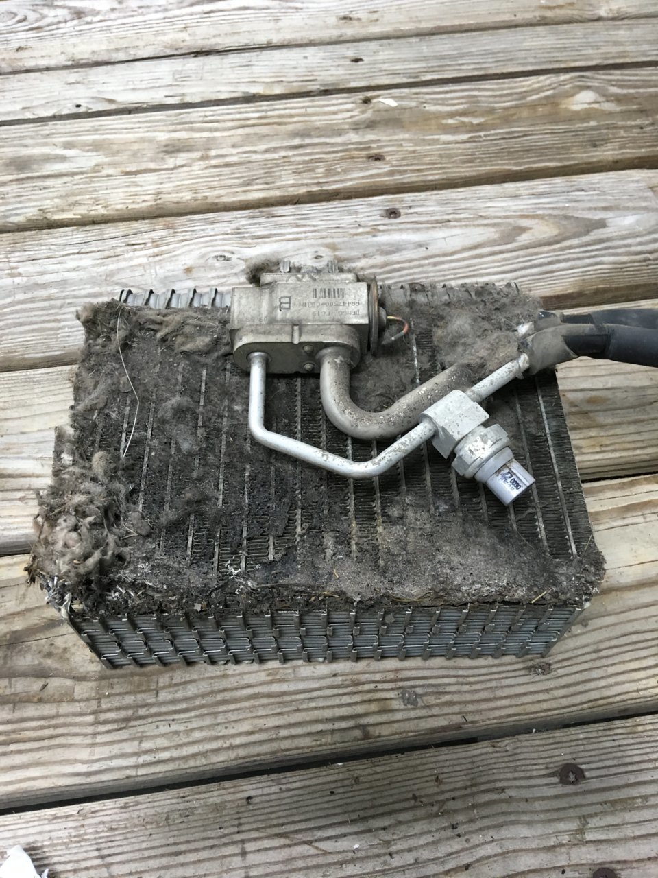

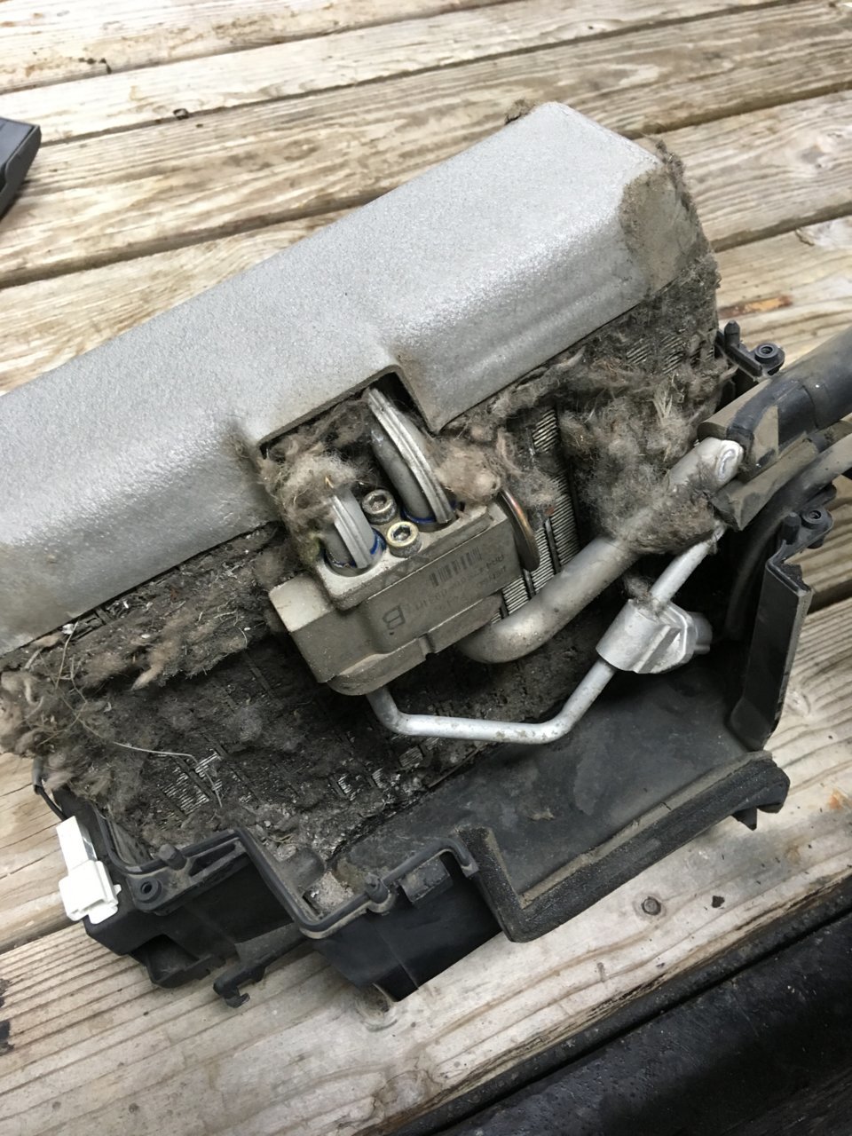

    Hate to say it but all the spray bombs in the world won’t fix the smell in the long run. Depends on what is in your dash. If you have access to an a/c machine you can remove the evaporator core and clean it fairly easily. I wish our trucks had a cabin air filter. This is what mine looked like at 250k miles. You could replace all the carpet and everything in your interior, but if you skip this step, you’re pissing in the wind.

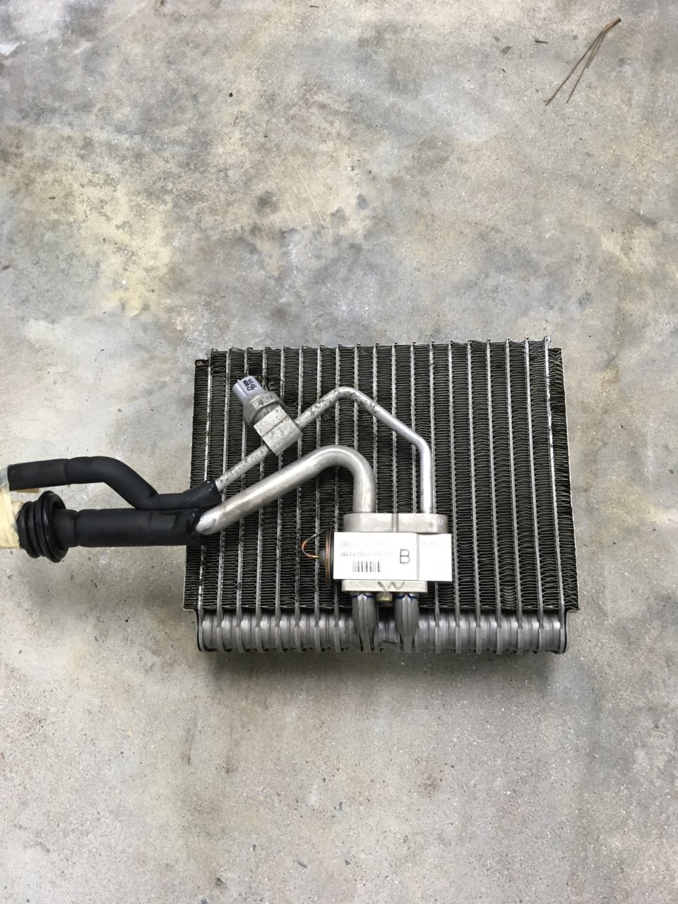

    Did you clean or replace? :eek:
    Either way dramatic difference. I replaced mine for a leak, wasn’t nearly as clogged and I’m not sure I could get to it for cleaning without disassembling.

    I just cleaned it, and put it back in. Really I had no problems with it, replacing the blower motor I noticed how dirty it was, so I removed it and cleaned it. It’s by far one of the easiest evaporator cores to come out. I’m used to pulling the entire dashboard out on the fords I work on.

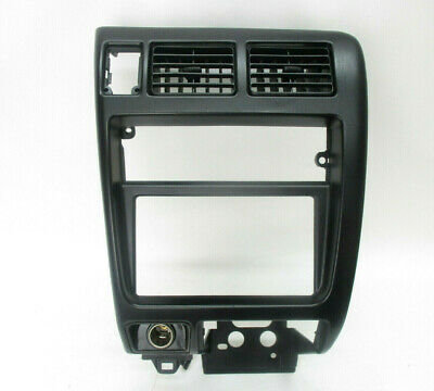

    Another easy thing to do is remove and clean the black stereo bezel. Once it's off you can clean the inside of the middle two vents and also the ducting behind it. Smokers dust is thick and sticky, every bit you can remove will help.
