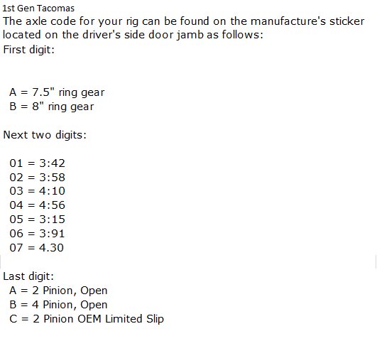

    I have two 95.5 ext cab 4x4s, one with 2.7 and one with 3.4L. The 2.7 has 4:10 and the 3.4 has the 3:91 gears. The 3.4 one also has manual lockouts. It gets about 1-2 mpg better than the 4 cyl.
    3.4L has 260,000 and the 2.7 about 165,000. 2.7 needs injectors rebuilt, but both will run a long time yet. 3.4 is the smoothest engine I have ever owned. I feel it's a great match for the truck.
    I prefer my 3.4 just due to the fact I do some light towing with it. In a basically flat state like Florida, I think I'd be fine with the 2.7 IF it had at least the 4:10, but preferably the 4:56 gear set. Of course tire diameter will also affect that, but I have 15" (Winter A/Ts) and 16" (Summer street) for both my trucks.
    Before you ask:
