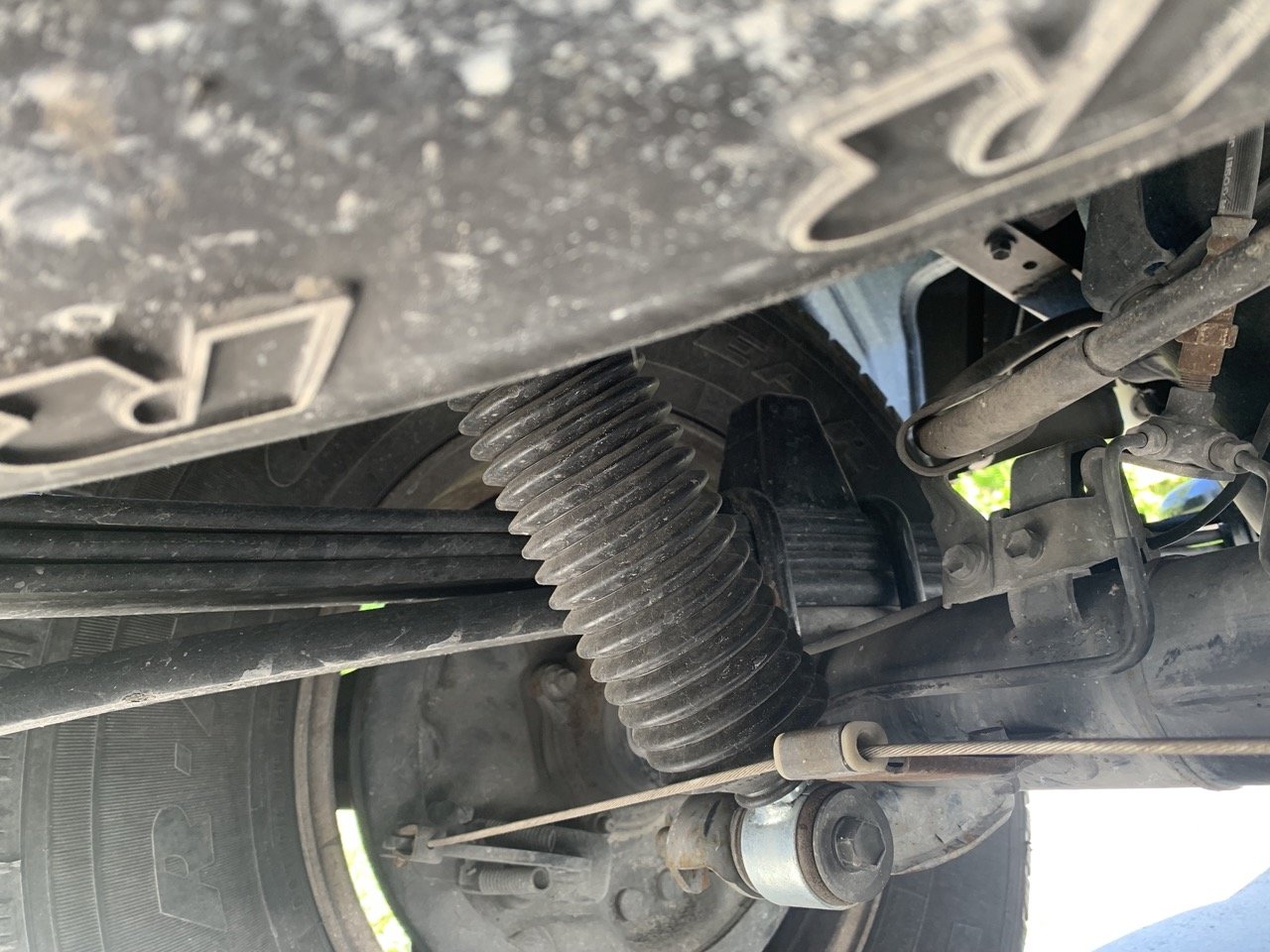

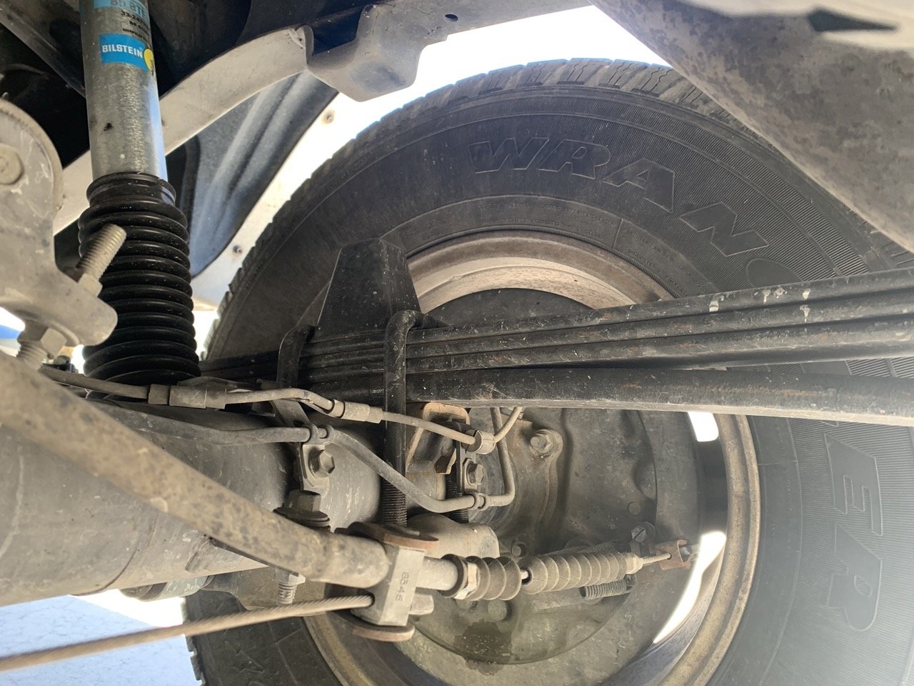

    OP, how is the arc of those leafs holding up after a year? I too am looking at general spring. I can tell from your install pics the arc is definitely better than flat stock.

    It's been about 5 months, and they seem to be about the same as when they were installed. I put Billstein 6112's on the front about 6 weeks ago which helped balance the truck out. Here are photos from today:

    Looks good, thank you!
