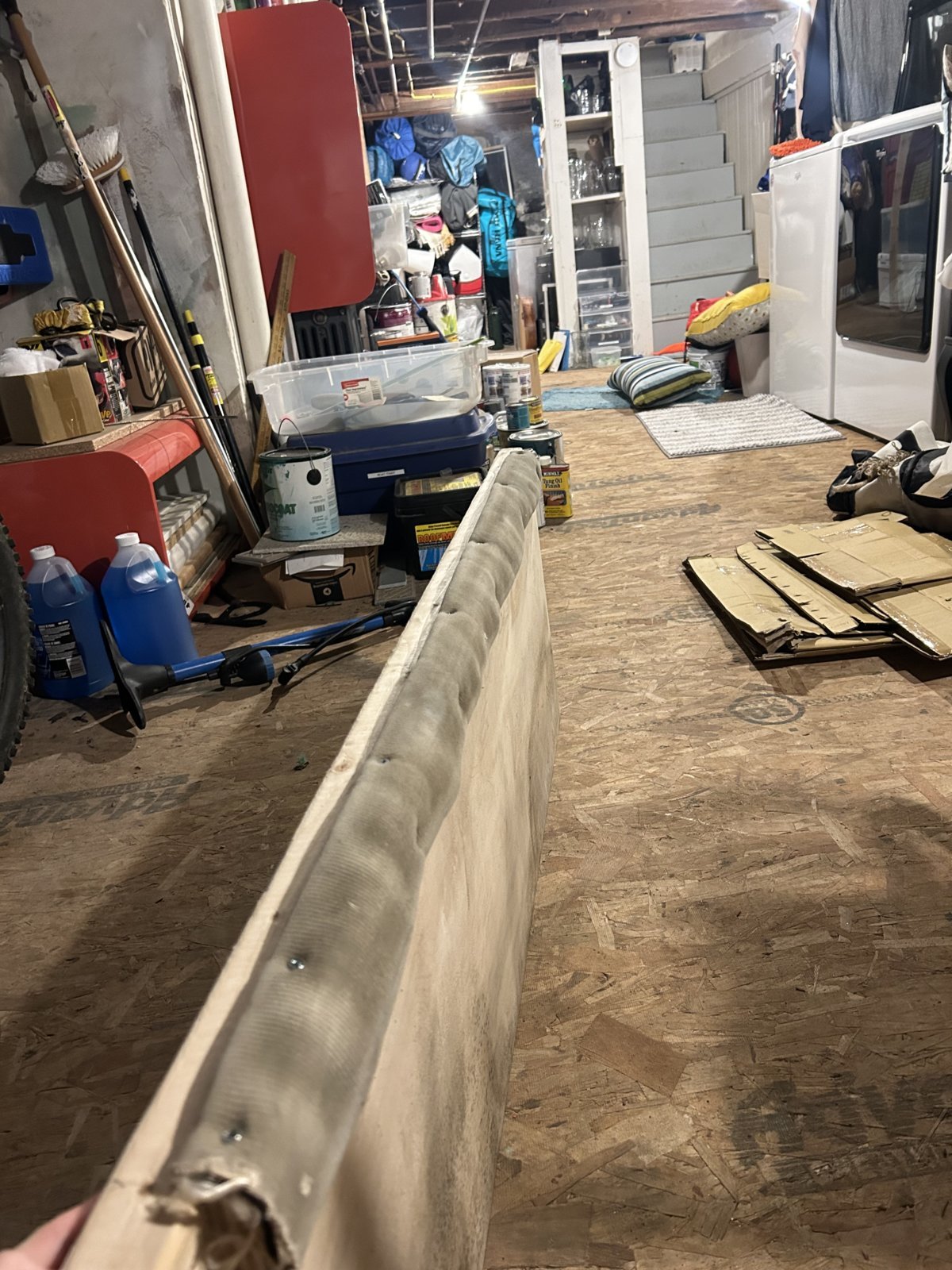

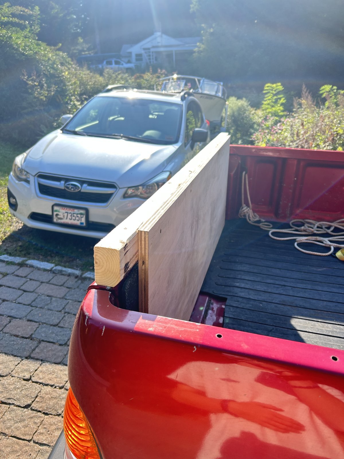

    Figured I would post in case people want to do something similar: using old scrap wood i raised the tailgate around 2 inches which is enough for every bike I have tried. I recommend adding fire hose like I did or a pool noodle to help protect your bike, if your pad is not super cushioning I found the wood to chafe the tailgate pad a little. If you do this make sure the wood that is on the backside of the tailgate is a little bit shorter than the tailgate otherwise you will have trouble closing it. Hope this helps someone.
