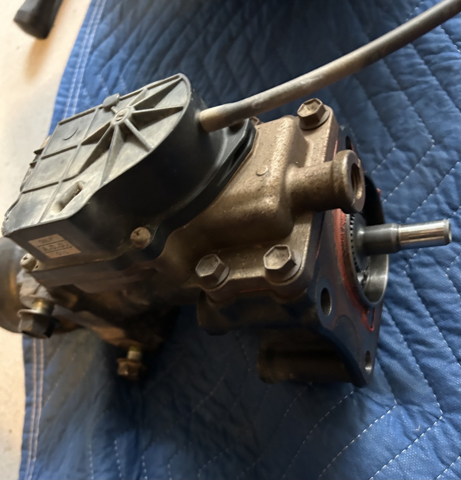

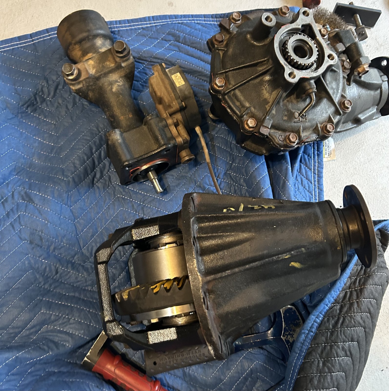

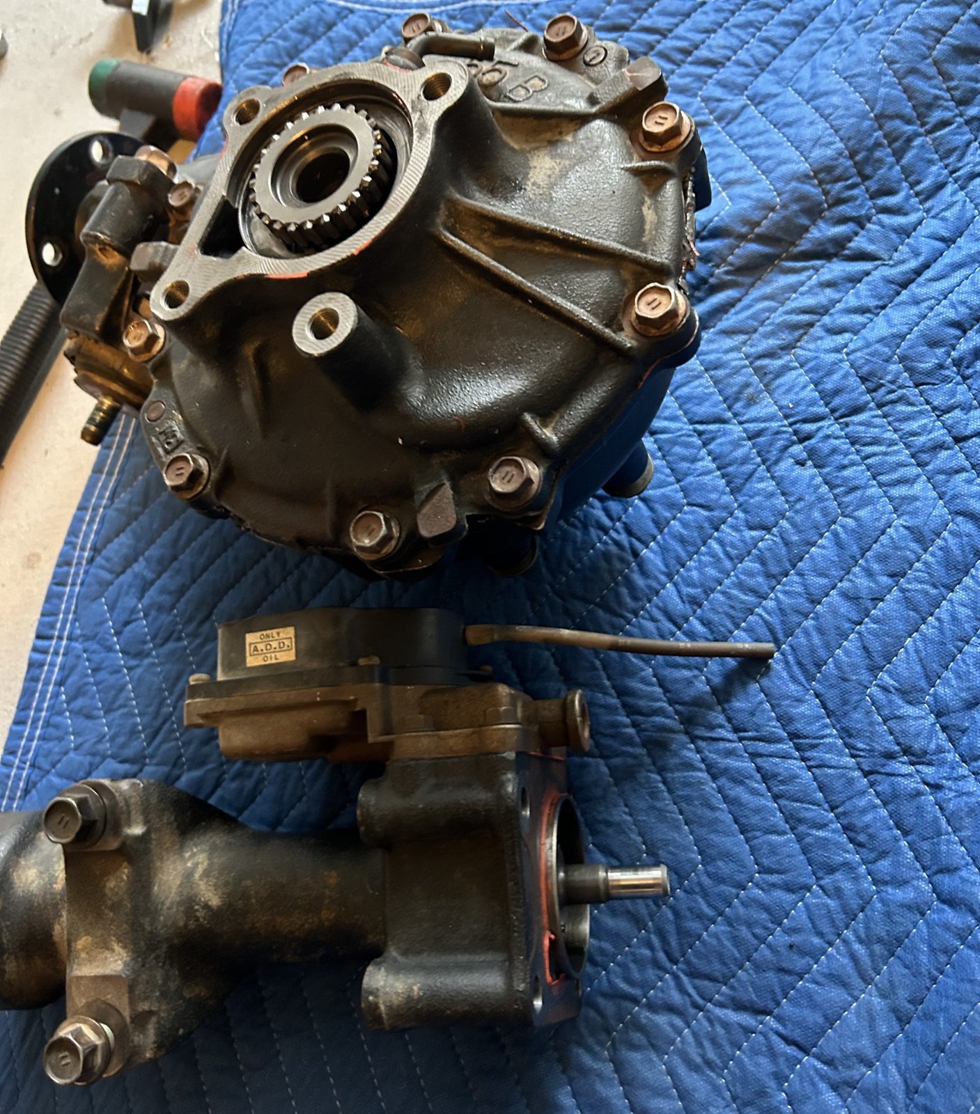

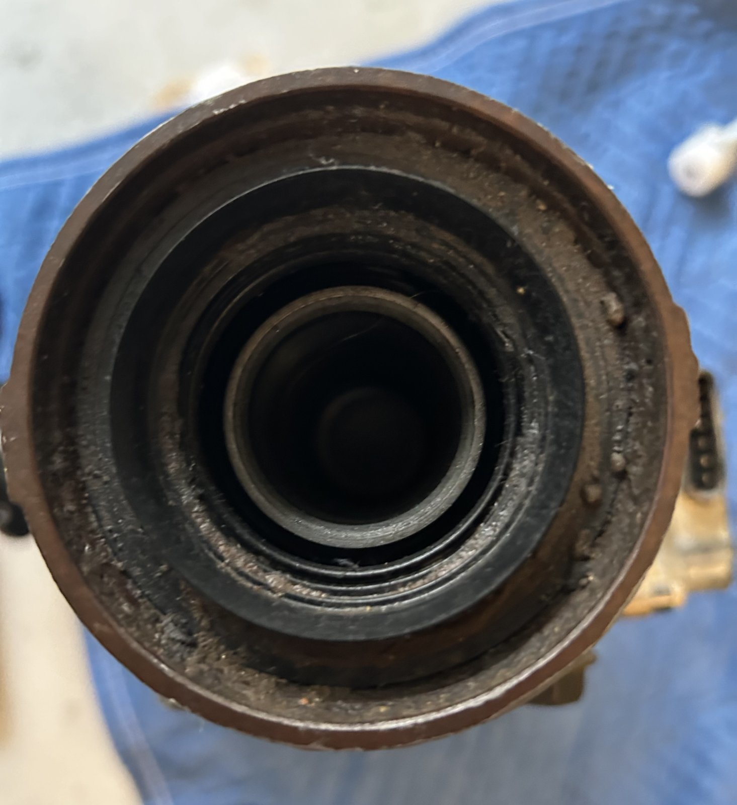

    4.88 F/R and rear TrueTrac is in the diffs now just gotta look up DIYs to determine what’s left needed to do and if more parts are needed
    -installation
    -reconnecting the ADD tube to the clamshell (sealant)
    -verifying the ADD on this thing works (going to do manual delete later not now)
    -possibly replacing outermost seal at ADD tube because it looks old and hasn’t been replaced
    -carbide scraper and brakleen to mating surfaces
    not sure if I’m gonna do rear first and remove front halfshaft for safety
    or go for the front as well at the same time which glancing at the truck looks a bit harder to do than rear.
    (potential disassemble front suspension, pop out CV axles, etc)
    I don’t anticipate desperately needing 4X within the next month but you never know.
    looks like I’m missing bolts that hold the ADD tube onto the clamshell. I’ll see what dealer cost is. New would be faster than donating the ones on my truck and rushing sealant to cure.
    rear install seems like unbolt bearings and space the hubs out with spare sockets to allow for removing third member, not necessarily requiring further parts replacement if careful to not damage anything like seals, etc

    stopped by dealer to order up 4 bolts attaching tube to front diff
    “Toyota red FIPG” for it is $22 a tube
    I wonder how critical that is or if I can use something I already have like RTV.
    I also have VW silicone sealant that the Germans use on a lot of stuff to include diffs, but I’m guessing RTV is better as it can smear on
    as opposed to VW where that black silicone sealant is typically being laid down in a 3mm bead with long cure time
