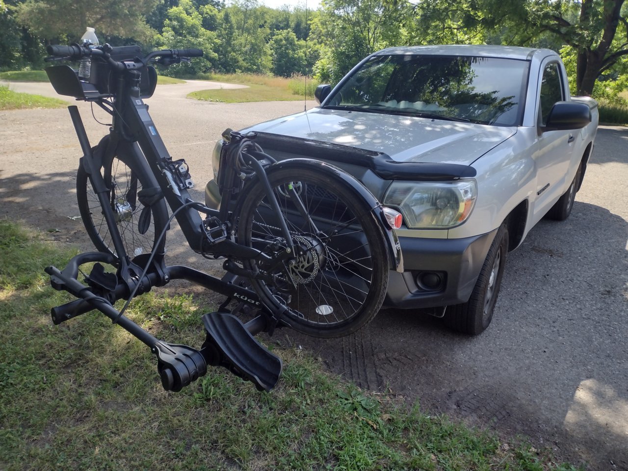

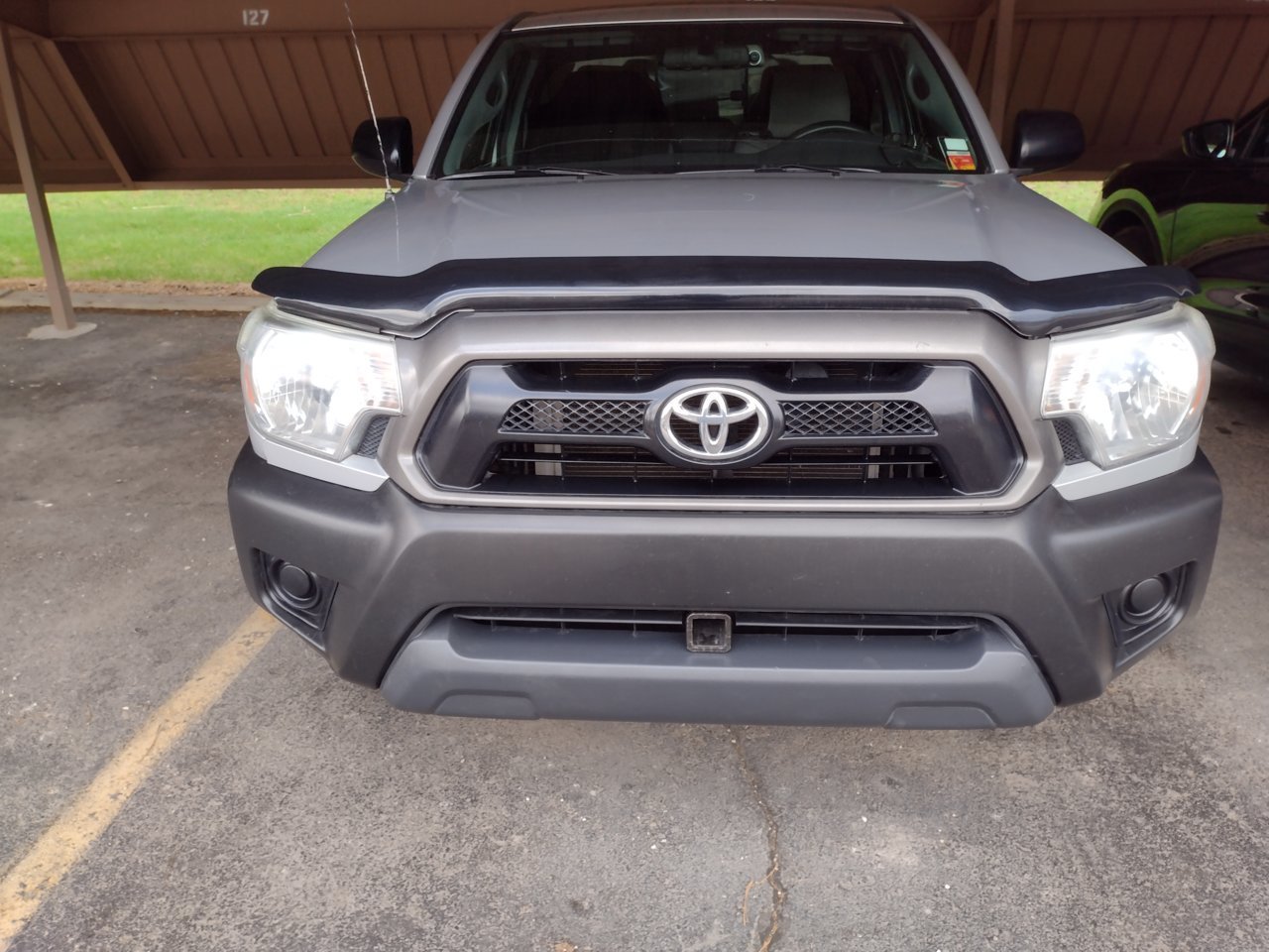

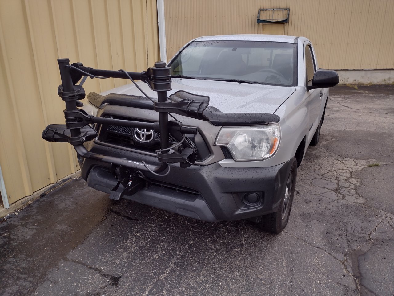

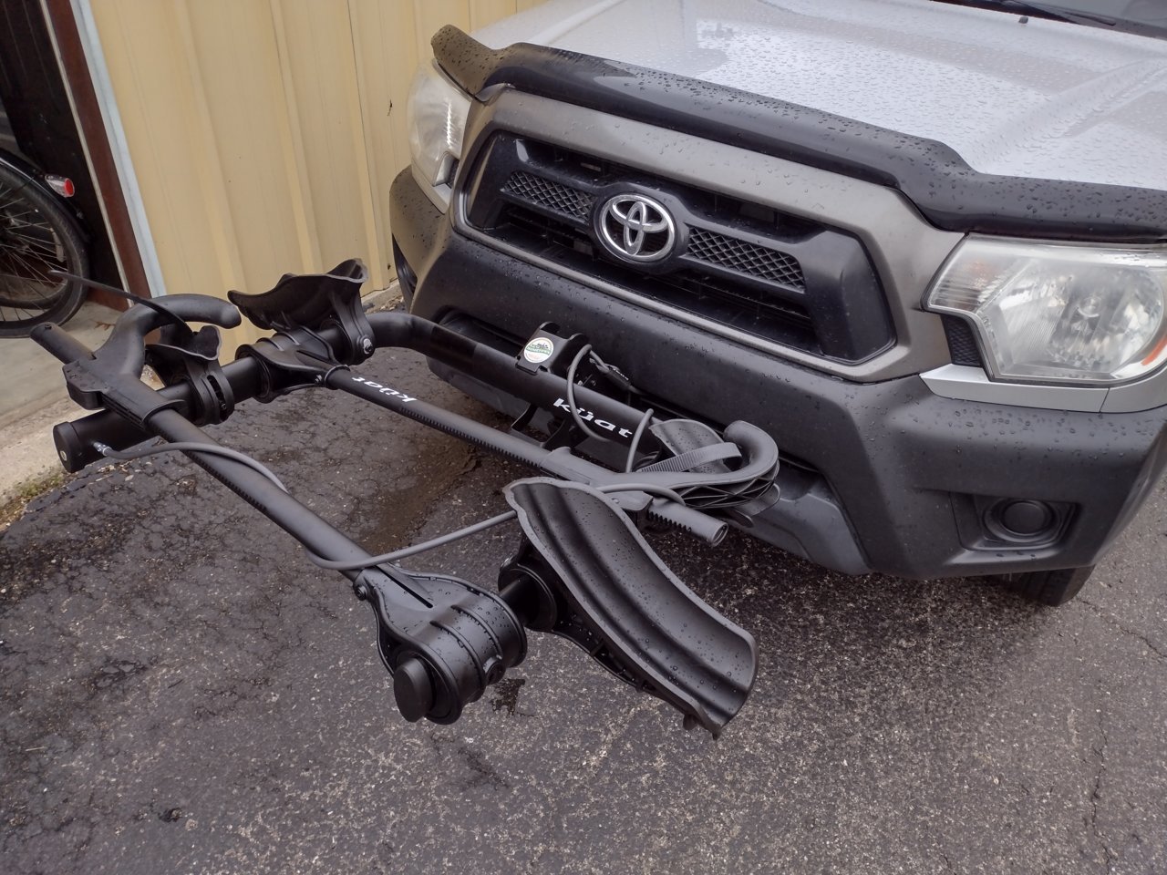

    I’ve been living with the 4xInnovations Front Hitch for Gen 2 Tacomas since spring22. Solid and heavy piece of steel. Great welding. You can see in the pics how I’m using it so far. Other intended uses are many.
    Anyone else with a front hitch? How are you using yours? Show pics please!
    I’ve been asked twice now if the hitch came from the factory. When not in use I usually keep a rubber cover on it.
    New Kuat 2 place bike rack. Sits too high. Need a hitch drop.
    Ok, I admit I really only wanted this thing up front so I can tell people “Stop looking at my rack… hey eyes up here”. Seriously, people used to carry bikes in front in the 1970s all the time behind the land yacht station wagons and other sofas on wheels. They used racks that hooked into the hood latch I believe.
    Can’t see it here but I have the 10” hitch drop at this point. Now with no bike on and the rack folded up, only about 6-8” is visible when driving.

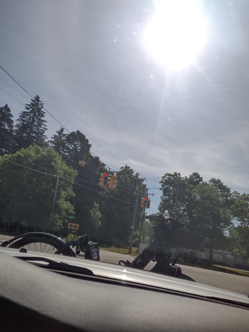

    This is my view with the 10” hitch drop and bike loaded. Taking the seat off helps a lot.

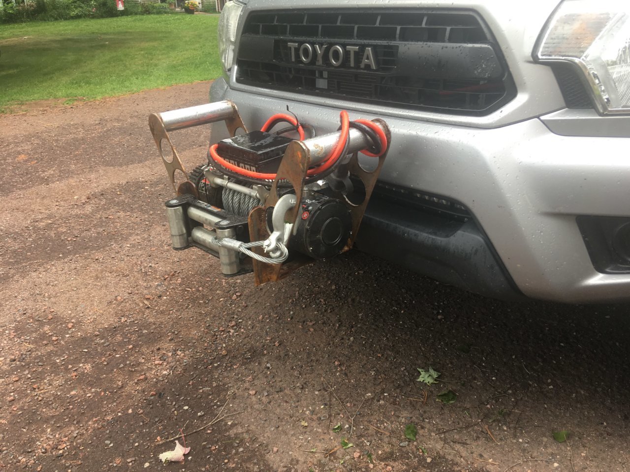

    KJbYeRBjTlrPdepkXmaygfW3NYw9-tlfk_MbYsOw_c66fac9aa44f45a9610eaad2ae960535a2049fcb.jpg
    I've only used mine for my winch. Mine is from Mobtown, RIP.

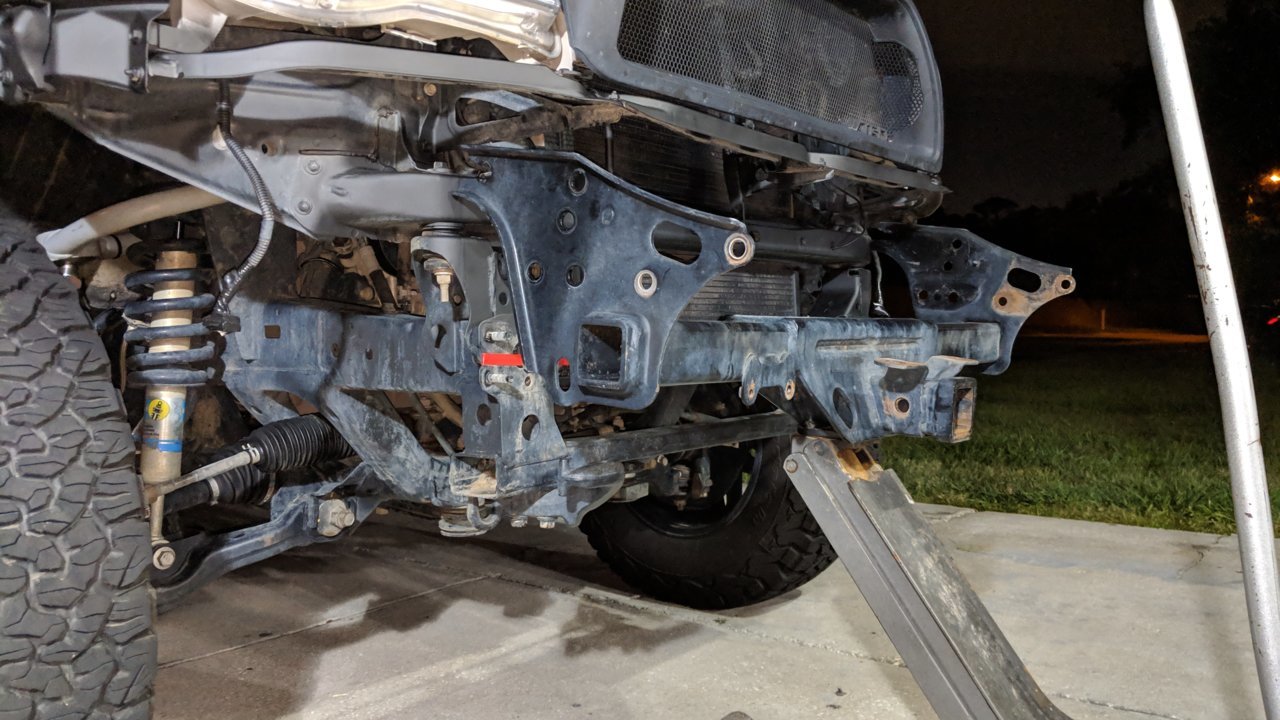

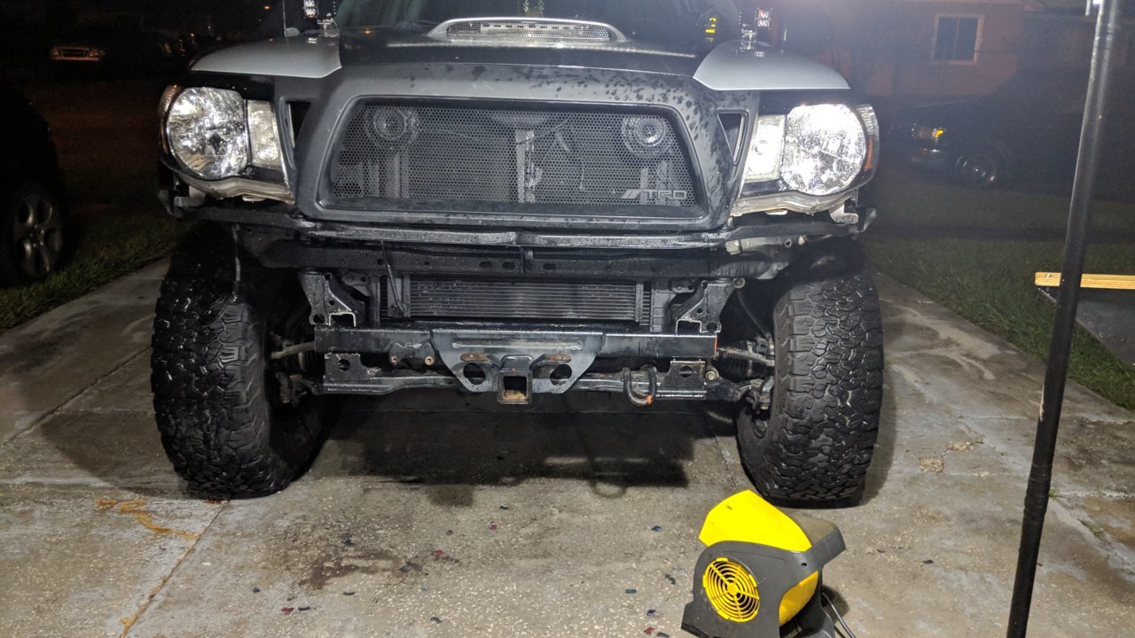

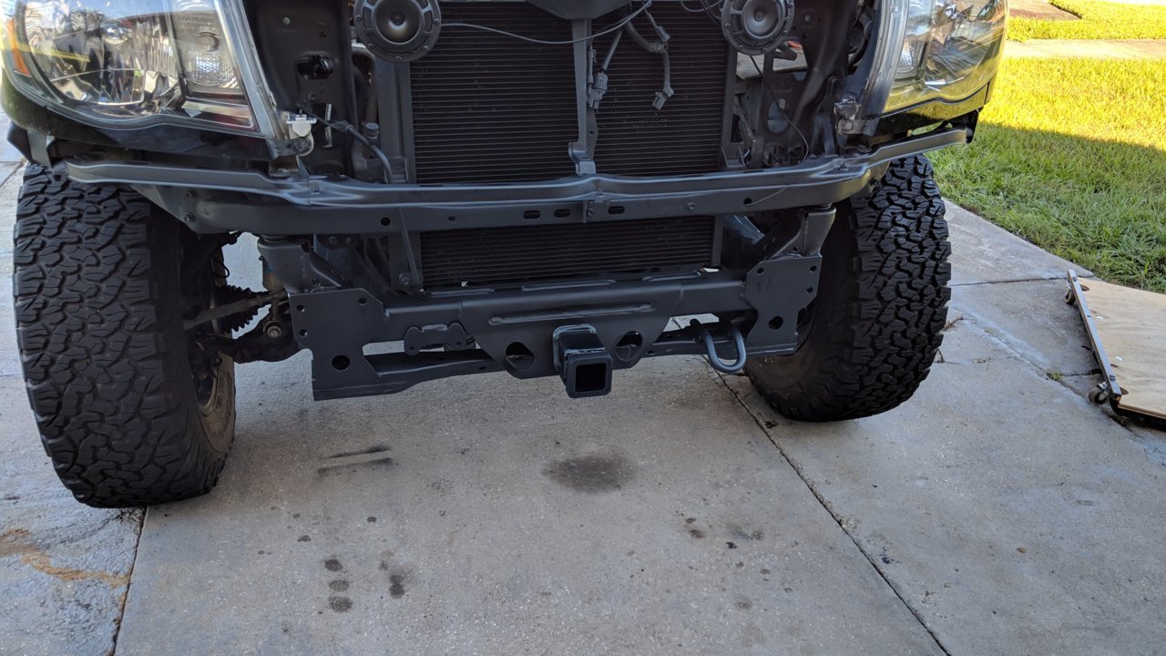

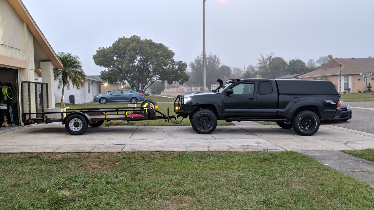

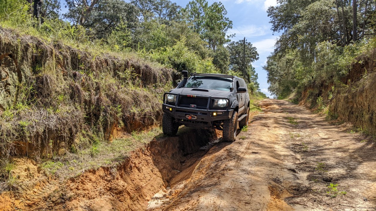

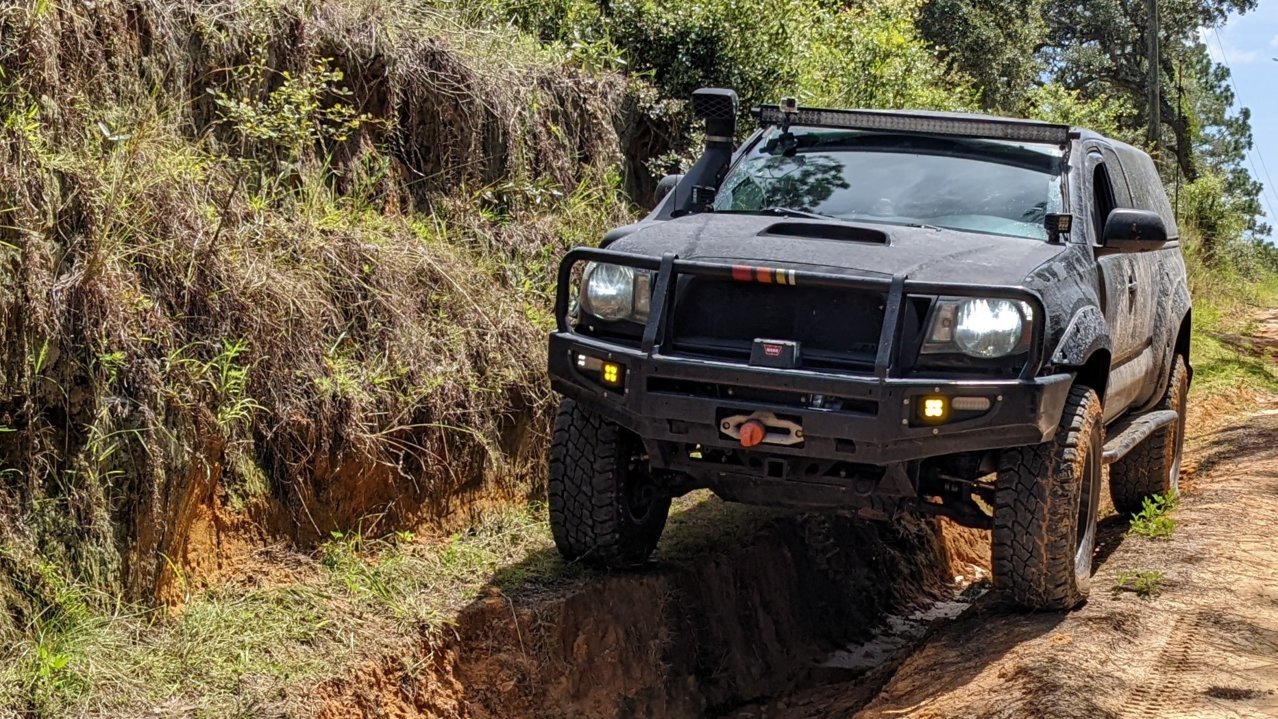

    Don't use it for much other than a recovery point and occasionally to snorkel a trailer in somewhere really tight and weird but I do have a front hitch.
    I actually took my factory rear hitch chopped it and frenched it into notches I cut in the front frame, tied it into the lower bar as as well to strengthen that, it really stiffened up the front end, gave me a solid recovery point, a place to use a hitch winch if I ever needed to and more flexibility moving trailers.
    Not the greatest picture but you can kinda see it here:

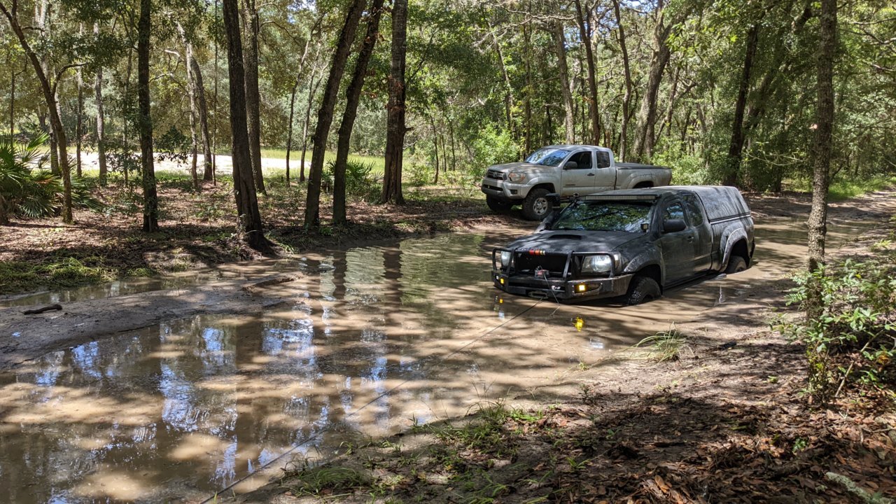

    It's not as crazy as it may look, just a bit of a wash out, I cropped it to get a better view of the hitch, it's the best picture I have on my phone right now of it.
    Here's the full, about as "crazy" (or mild really) as it gets in Florida unfortunately. :bored:
    We got boring dirt, bad puddles and...
    Well that's really about it.

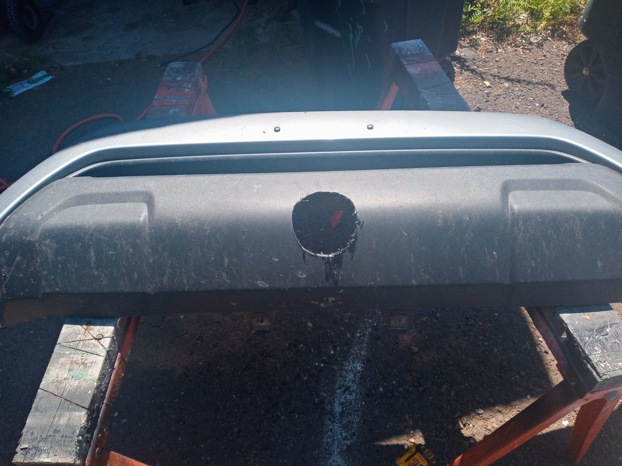

    I had them ship mine without the receiver welded on as I have a light bar in that vent and didn't want to relocate it. Mine site lower, and I had to cut a hole, but it is okay by me. Here it is with a winch in there as I was out pulling down an old tree for our solar array the get built. Usually there is just a license plate and the winch lives in the bed.

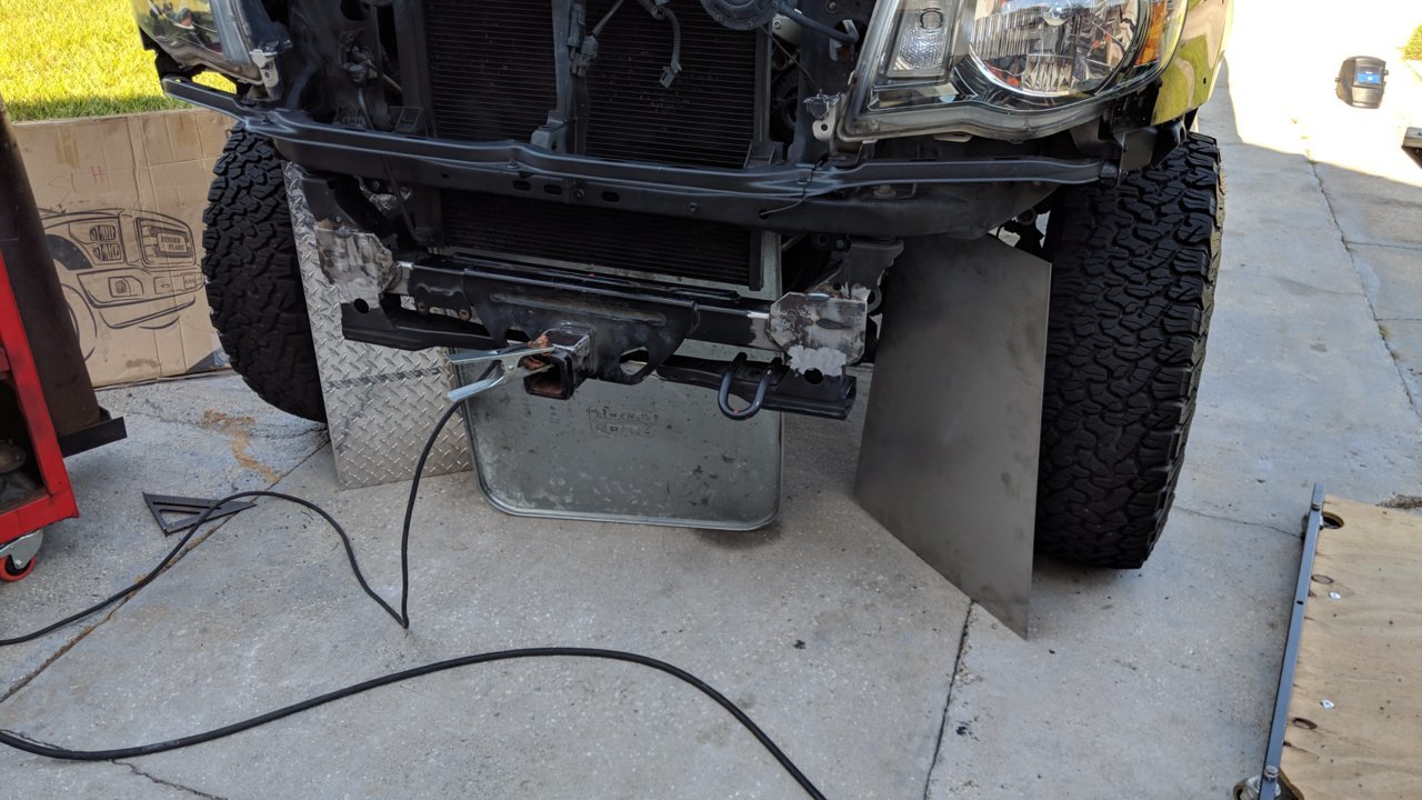

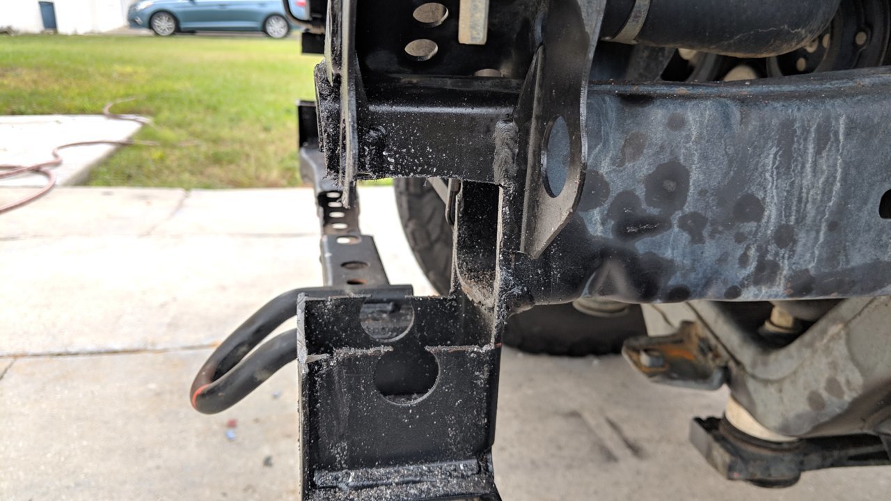

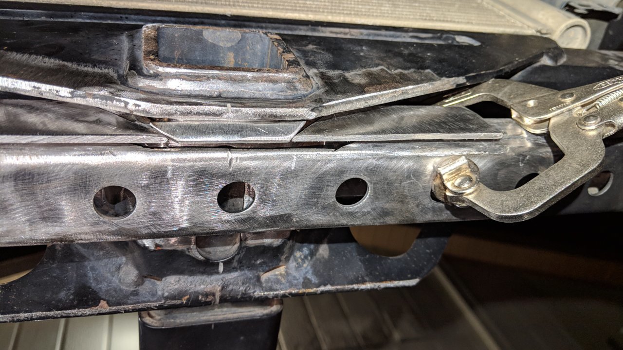

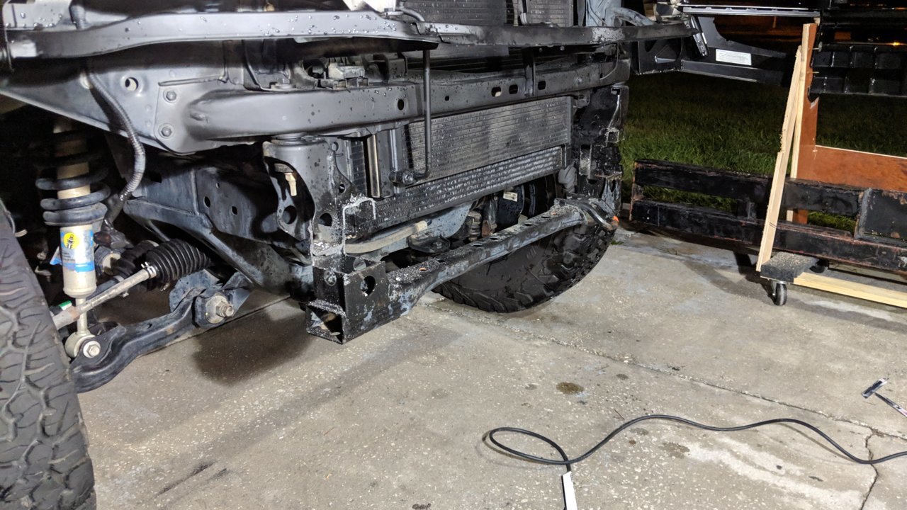

    Looking for something else I found some pictures of when I was doing it.
    Mock up.
    The no going back point of notching the frame, pretty sure this voids the warranty.
    Modified and set in mock up.
    The good god what am I even doing that's a huge hole realization.
    The "Oh yeah; it's all coming together." point.
    I tied it in to the chin bar to support it and the hitch, almost like I planned it! (I didn't the factory hitch is just huge.)
    Looks pretty good with lipstick on it, you can kinda see I bent the lower tabs of the core supports and tied into my thickened and widened bumper mount pads.
    I did everything with as much strength in mind as I could figure, to include adding the little 45 gussets you can see to the far left here:

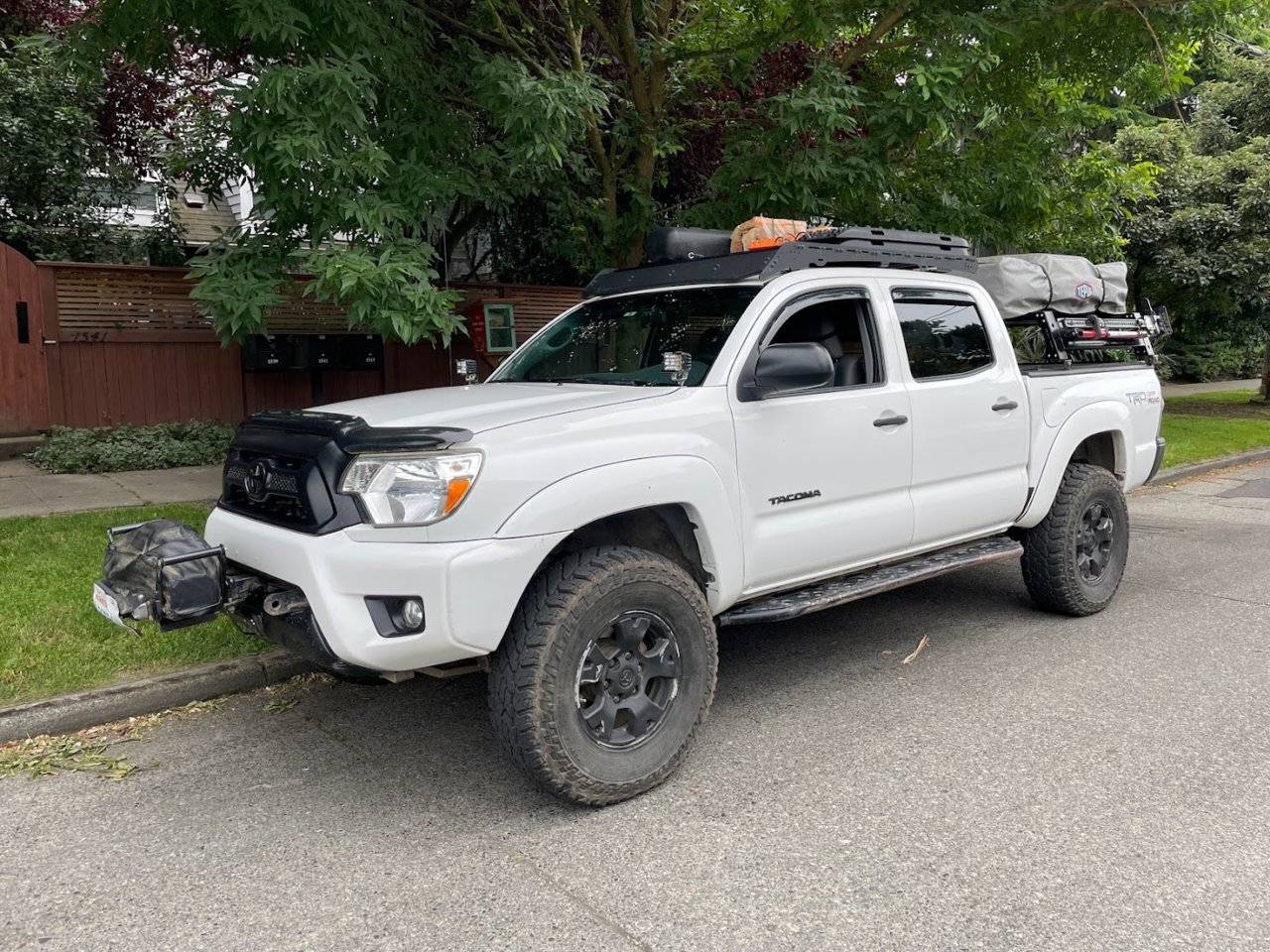

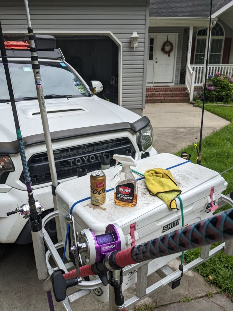

    I have the Mobtown hitch and use it to carry a Surf Rack with my bait cooler to serve as my fishing station.

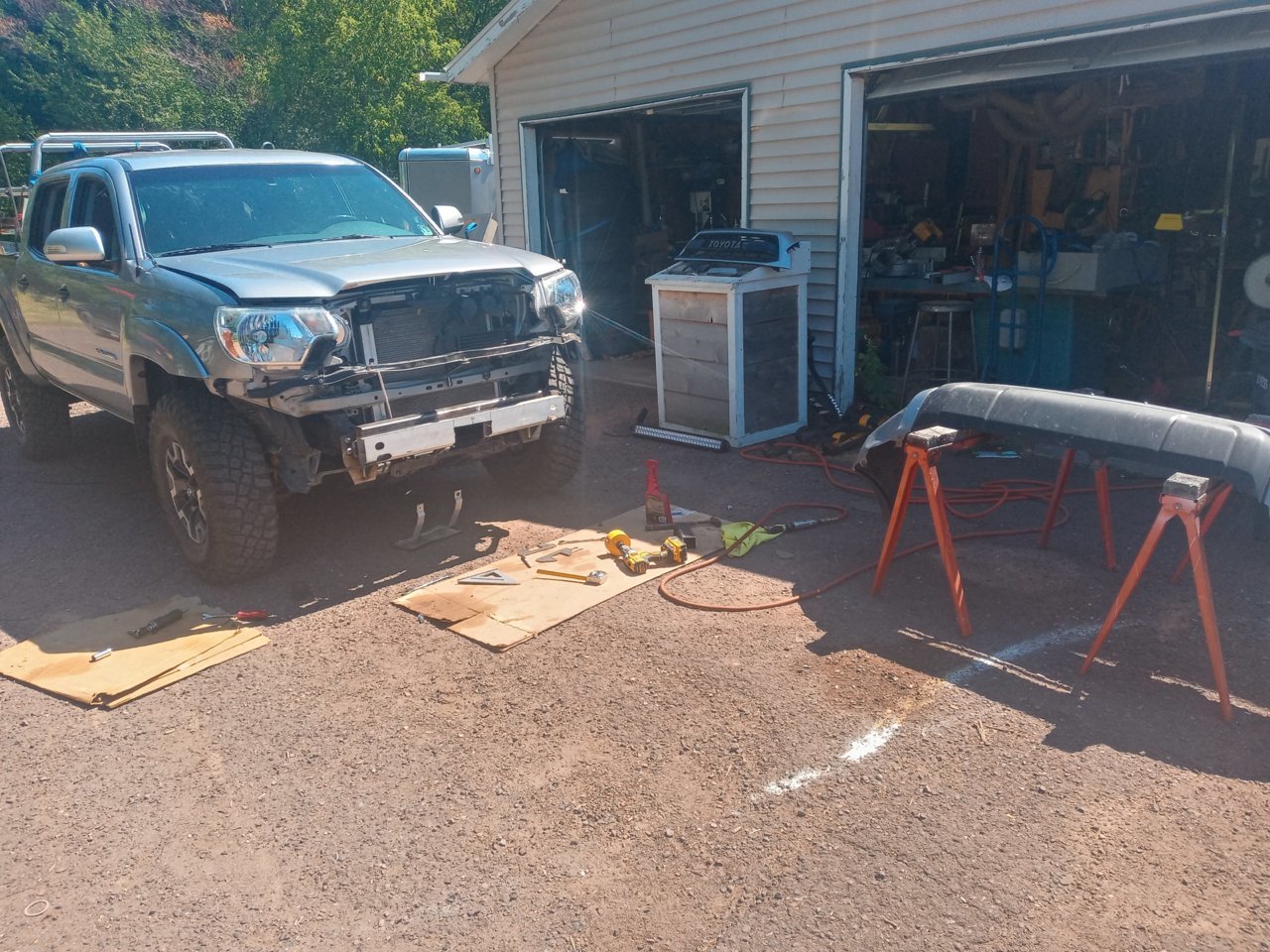

    This was my moment of commitment... cutting the bumper.
    And a notch to the aluminum part...
