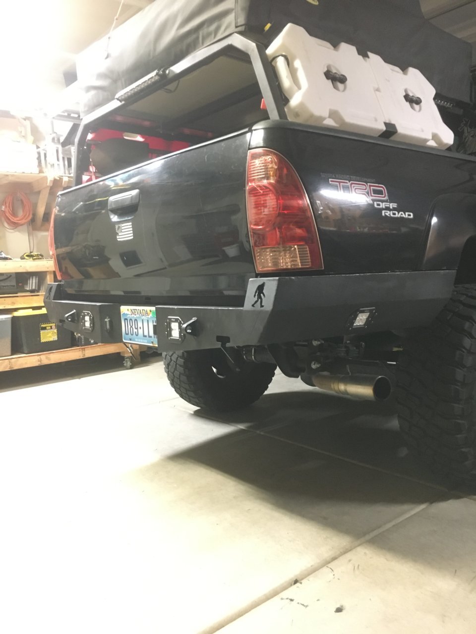

    315 75 16 Toyo MTs DIY Bed Rack Smittybuilt RTT Dirt King SUA Kit Custom Long Travel hangers and shackles Shackle flip King 16" Triple BP Shocks King 2.0 x 2.0 bumps Dirt King Frame box kit. Rebuilt rear cross member with 1.75" DOM Deaver H70HD leafs Polk Audio speakers F/R Handmade ported sub box for 10" sub Rockford Fosegate 1000W RMS amp TJM Front Bumper, custom DOM bull bar. Fabd Steel high clearance bumper Amber fogs Smitty Built 9500lb XRC winch King 2.5 with #700 coils Total Chaos Spindle Gussets 1.25" Spidertrax Spacers Icon Delta Joint UCA Thor cowl intake Fuck mud flaps and wheel liners. Switch pro mount and blue ray systems buss bar Dual audio double DIN head unit JD fab battery tray Alpharex Head/Tail lights Prinsu Roof racks Cab and Camper Don’t tread on me sticker for extra HP

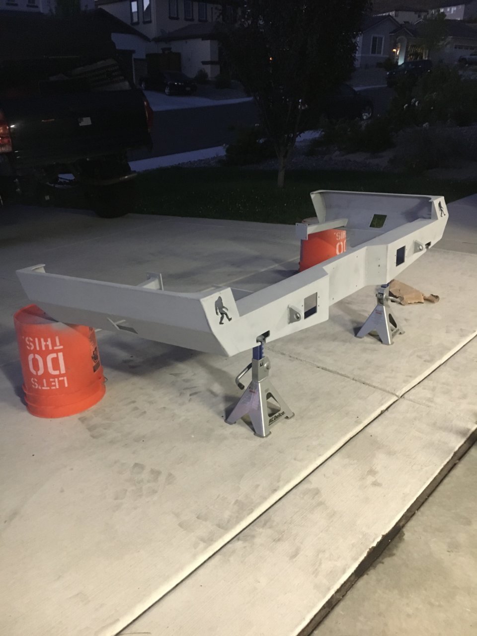

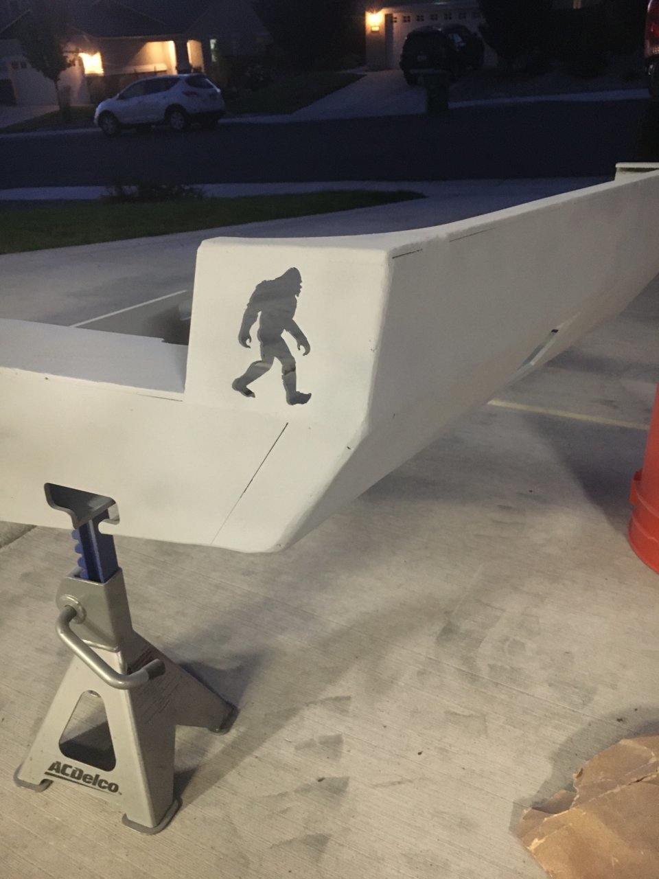

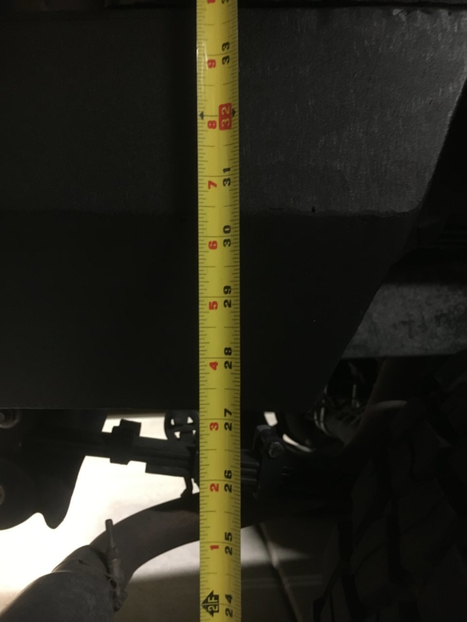

    Update: I made a ton of progress last night. Finished welding, grinding, cleaning, priming and painting. I even got the lights installed.
    The tape measure picture is dark but it shows the bottom of the bumper is 27" off the ground at the back tires.
    This is basically done, I just need to wire up the reverse lights and presto.

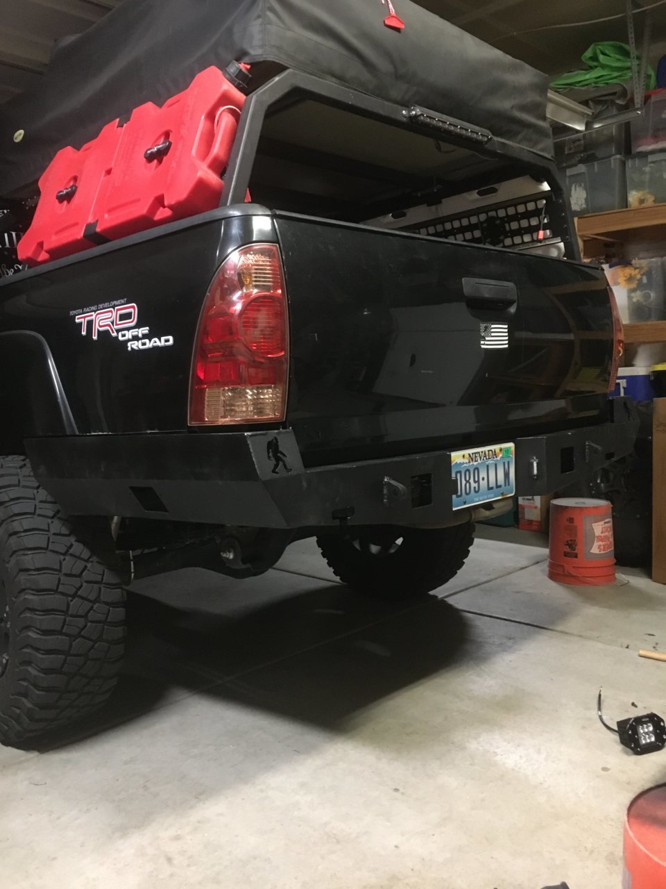

    more pics

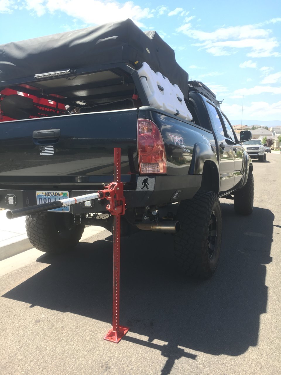

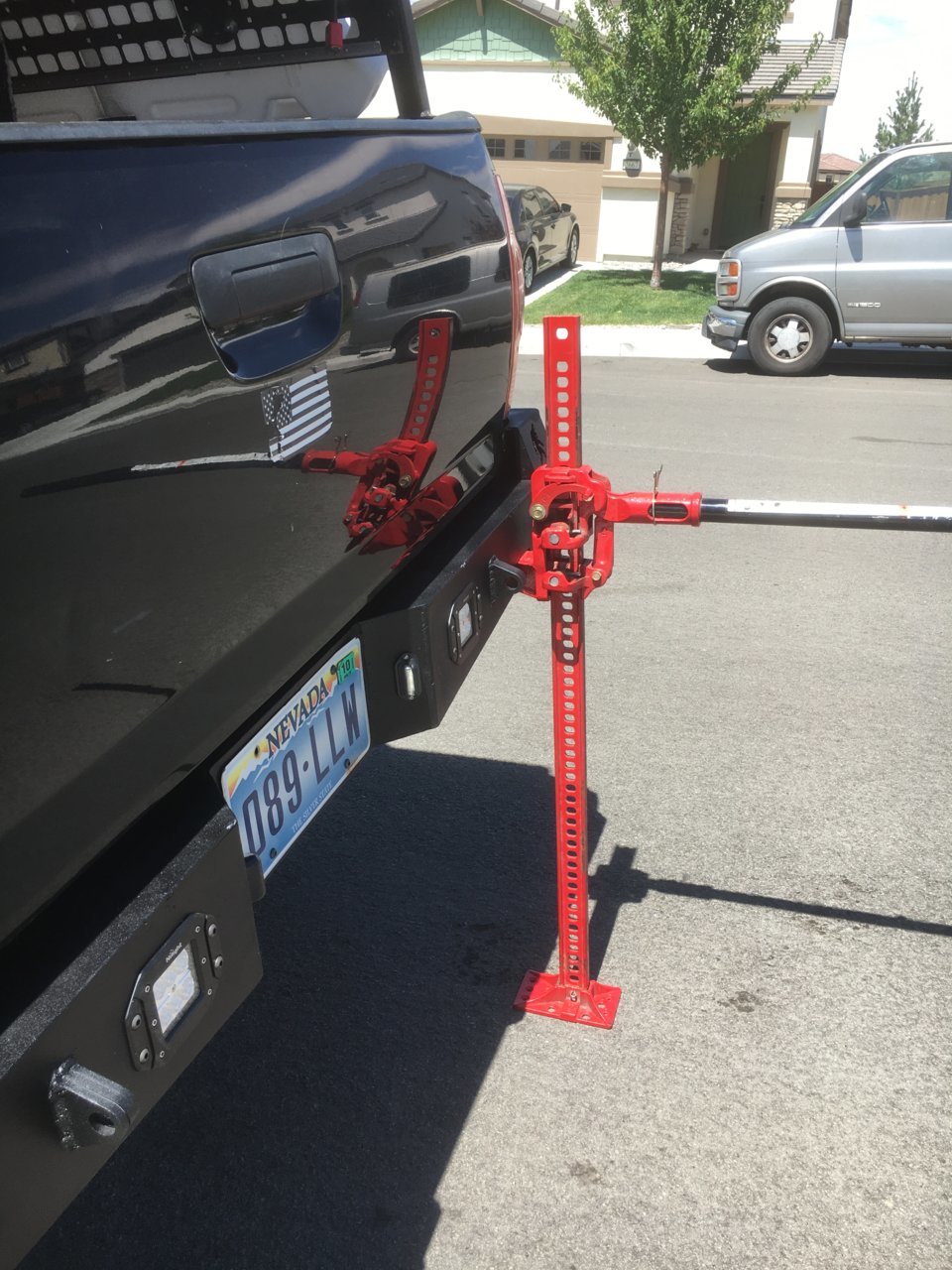

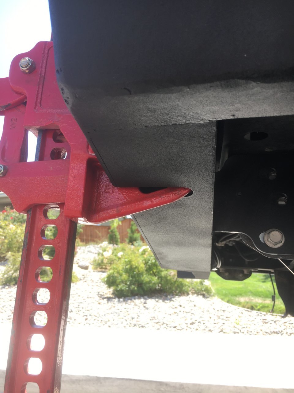

    7,489
    Very nice work. I especially like the side facing rock lights. I am curious how close the Hi-Lift jack is to the tailgate when you put it in the slots. You might need to remove the tailgate when you use the Hi-Lift.

    2014 Tacoma DC 4x4 TRD Off Road, Supercharged
    Good job! I think it came out great.
    The bumper is pretty high and tight which is how i wanted it and you are rightfully curious.
    The high lift is still a few inches away from the tailgate when lifting from the bumper.
    If you had to change a tire, you are still probably better off using sliders as a lift point for the high lift to keep one side of the truck down. Honestly, i still prefer using the stock crank jack sometimes and just lift the truck up from the axle or lower control arm.
    Using a safe spot to lift from is always the main priority but I like having the lift points on the rear bumper if I need them, i just have to remember 4wd to keep the front end from rolling.
    Thanks for your question!
    Edit: I am also on a slight downhill when i took that pic. If i was facing uphill the high lift would be closer to the tailgate. You would just have to be smart (which isnt always) about when to use the rear bumper t-slots i guess.

    7,489
    That looks really good on asphalt, but keep in mind on dirt, rocks, gravel, a Hi-Lift can do all kinds of tipping. If you get in a hairy spot, pull the tailgate.

    50
    Nice job and like one of the other guys said Sasquatch is a way cool touch.
