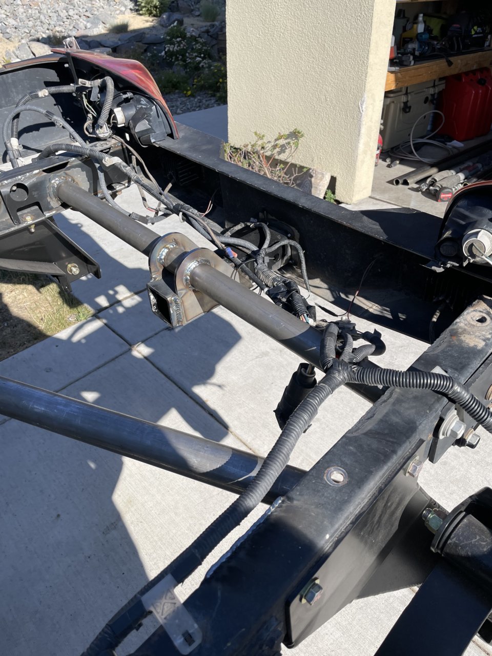

    Going back though this old thread. I did end up welding in a hitch behind the license plate. That was good advice and very sleek. Had the bed off while I was converting to LT and it was pretty easy to add in at that time. Removed the cross member and replaced it with .120 wall DOM. Custom laser cut 1/4” hitch brackets I cut at work. So hitch is tied into and welded to the frame and bumper. Not removable but oh well.
    As far as load capacity. It does fine every time my wife’s rubicon breaks down and I have to load it on the flat bed to tow it home.
