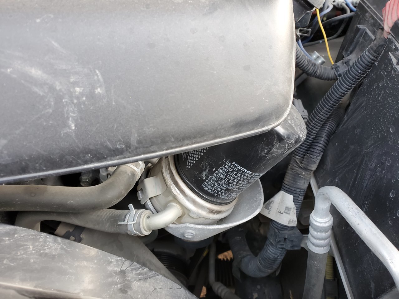

    Does your oil filter have a cooler on it like this?
    If it does you have the tow package and your tow rating is 6500# for a 2wd and 6400# for a 4wd, non tow package trucks have a ~3500# tow rating.

    I ran out this AM and took some pictures- it looks like I *DO* have the pink fan shaft and oil cooler.
    https://imgur.com/a/39Zq4x9
    So, being 4WD it sounds like my tow capacity is around 6400lbs- which is great news.
