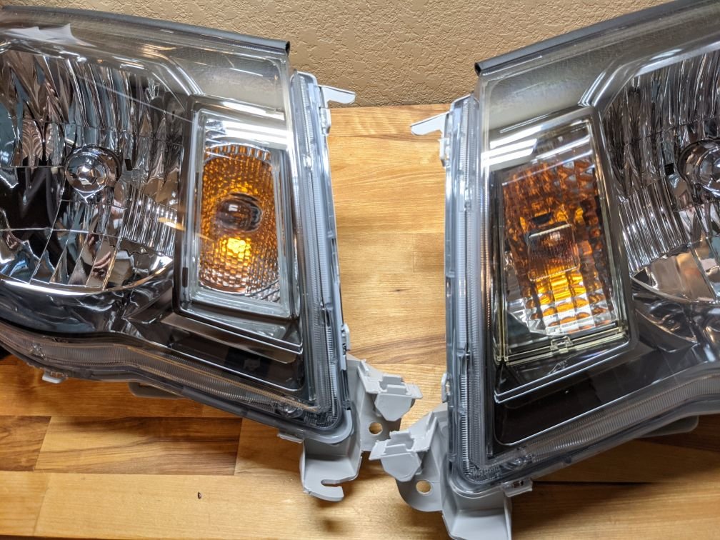

    Eventually the originals will start to burn/melt the inner plastic lens of the DRL but it takes years. Here is a side by side of the two I was sent and ultimately sent back since they did not match. Left is updated TSB housing with clear glass inner lens and right is original non-TSB with yellowish plastic lens, also has a little square in front of the bulb.
