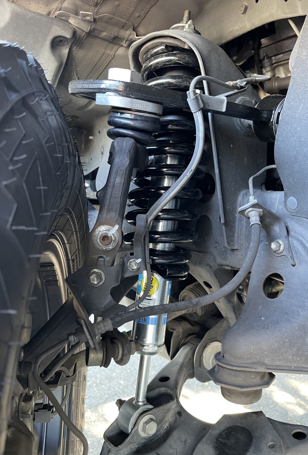

    Front:
    Bilstein 5100 Shocks
    OME Lift Springs (Old Man EMU)
    SPC UCA
    Rear:
    Add-A-Leaf

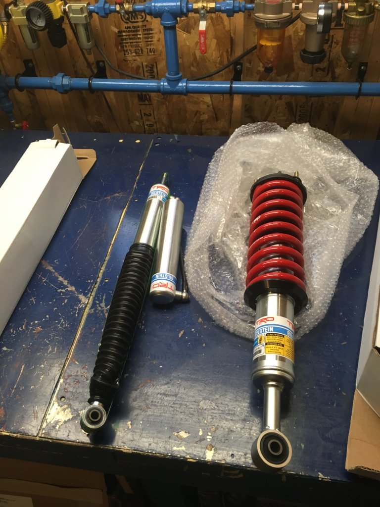

    Here’s the Pro kit for illustration purposes. Was just going to install it before I got hit. Still might make it once I get it back.

    2005 Tacoma TRD Sport
    Eddy, what advantages does the pro kit provide?
    Is it still a sporty street setup?
    FastEddy59 likes this.

    From what I've read, the TRD Pro Bilsteins are very similar to the Bilstein 6112/5160 setup. I've also seen mention that depending on if they came off a 2nd gen vs a 3rd then, the 3rd gen version has a heavier duty spring. It would stiffen up the ride, I bet, but 650 pound springs (the estimate i found) usually aren't recommended without added weight on the front of the truck (like winch/heavy bumper). Might make the ride rough, not just stiffer. And a 2nd gen take-off set... at this point they'd be pretty old. You'd probably be better off with 6112/5160s new off the shelf. Off the shelf bilsteins also can be set to stock ride height, where the TRD Pro setup should be a bit higher than stock (and without height adjustment). And I think you said you didn't want lift.

    Can’t really tell you as it’s still on the bench waiting to be installed but I’m told it was basic Bilstein shocks made to TRD spec’s. Nothing fancy. Supposed to give like a 1” lift. I already swapped out my rear leafs & this would have completed suspension mods.
