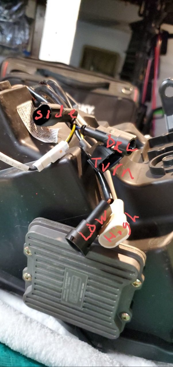

    Hi Dave. Thanks for the tag
    I have Morimoto xb gen2 on my 2021 SR5. I also have the stage 1 meso customs LED tail lights and sequential turn signals.
    My turn signal will hyperflash if I have them on while reversing, which almost none of us will ever consciously do in day to day driving, but it does happen. My stage 1 kit doesn't have any resistors on them, but the Morimoto xb gen2's do have a resistor attached to the bottom of each LED headlight. See grey box with screws in attached picture.
