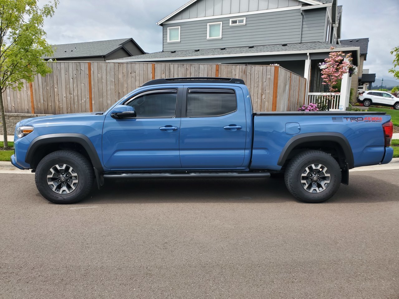

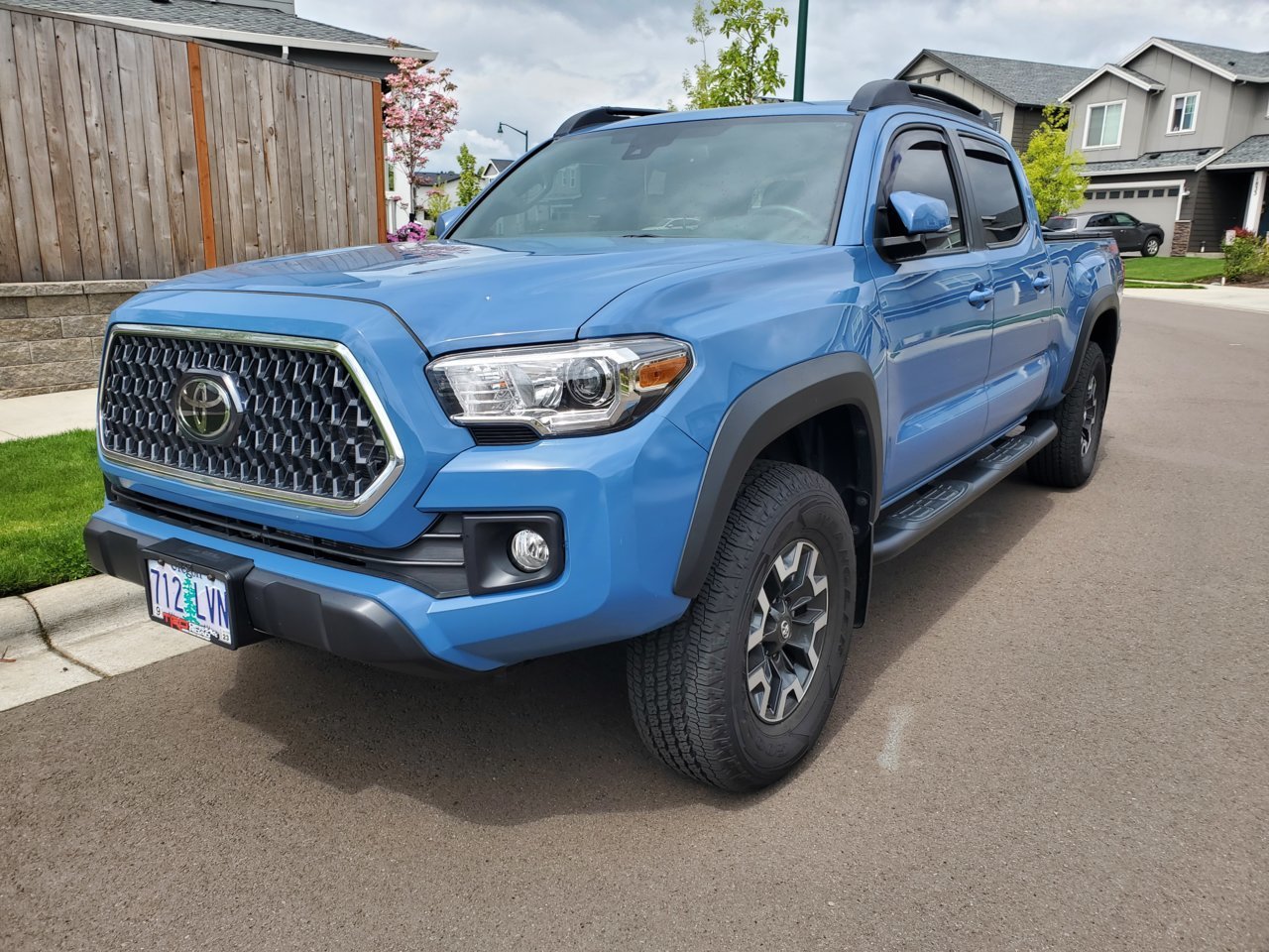

    This is how it's sitting now, pre-lift. Symmetrical all the way around with a full tank of gas and me not in it...

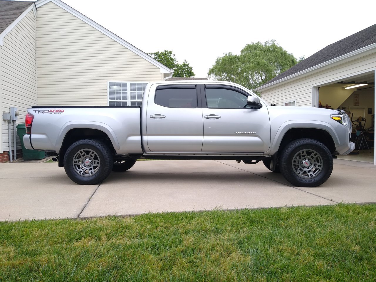

    95BDADC3-DBE5-48F5-A237-E9D117FCFD8E.jpg I have 5100s front and rear with front on 4th notch. No Block, leaf or anything in the rear. TRD Pro wheels, 265/75R/16 Falken Wildpeak AT3. Has slight rake in the front and may go with 1 inch block. The truck rides,steers,turns just the same as stock, no rubbing what so ever. The tires have slightly more road noise but that was expected. I did so much research on TW, and am thankful for all the info provided on tires, wheels, and shocks. I don’t do any serious off-roading intentionally. Moved to the Eastern Sierra Nevada (Plumas County) couple of years ago, so we have snow in the winter, and lots of places to explore off road, year round. I waited for stock Goodyears to wear out then changed to current setup. I got 52k out of the Wranglers! Overall I am more than pleased with the new setup, and am sure you will be too.

    68Z28 - Looks great! I thought for sure you'd be nose high, but it sure looks good as it sits. : )

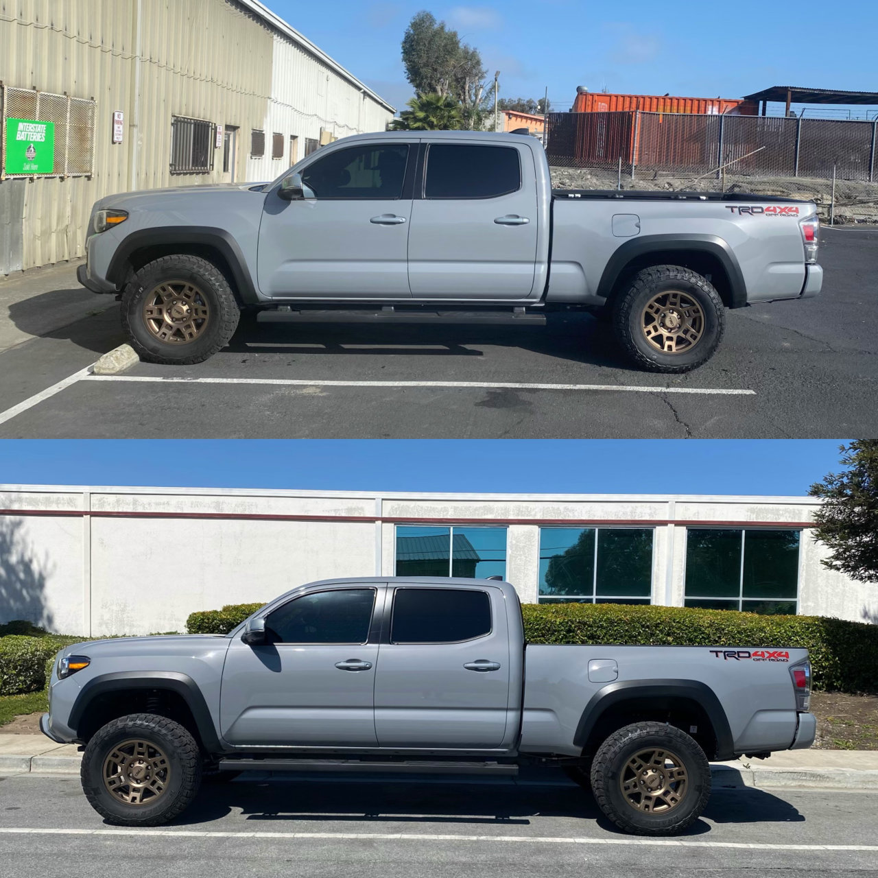

    Might not be too helpful but here goes
    Top: Stock OR Suspension on 265/70/17
    Bottom: Eibach coils on second notch and 1.5 inch block in the rear, drivers side also has the spacer for the lean.
    Seems dead even to me with half a tank

    Looks great :thumbsup:

    Looks awesome!!!!

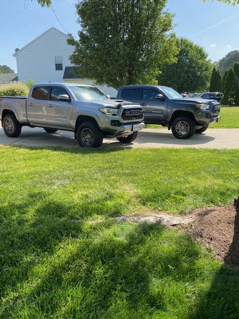

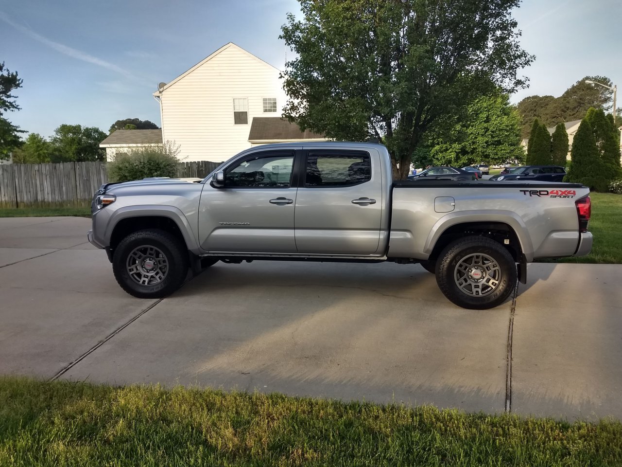

    19393.jpg IMG_20190502_070948422_HDR.jpg IMG_20200524_092207736.jpg5100s on the 4th perch, needle bearing replaced with ECGS clam shell bushing, 1/4 inch shim for the lean and a one inch block, front diff and a rear carrier drop, which were needed to put the angles back in spec, no vibrations, no issues, factory oem coils, tires are 265/70/17 Toyo open country at2. Ride is amazing and it has a slight take.
