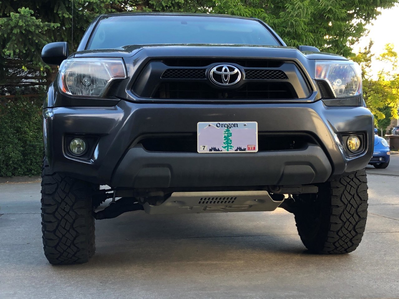

    2014 TRD OR DCSB - MGM

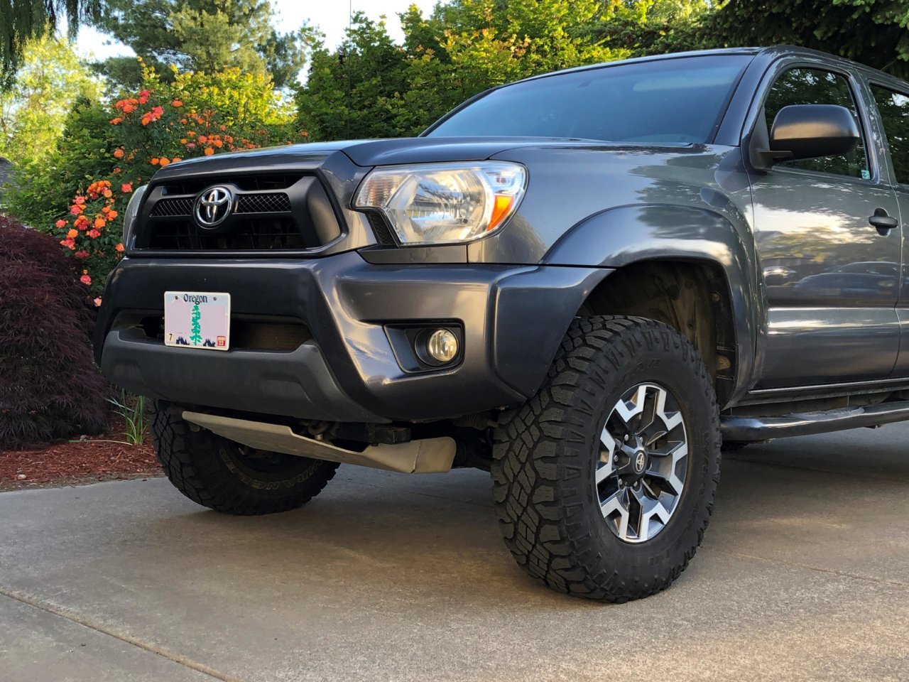

    Here's another example. I pulled the red letters out of my skid plate. Bolts right up without needing to remove the braces.
    I also run a tube from the bottom of the oil filter drain when changing my oil. I route it down through front right hand side of the skid plate since it's right there

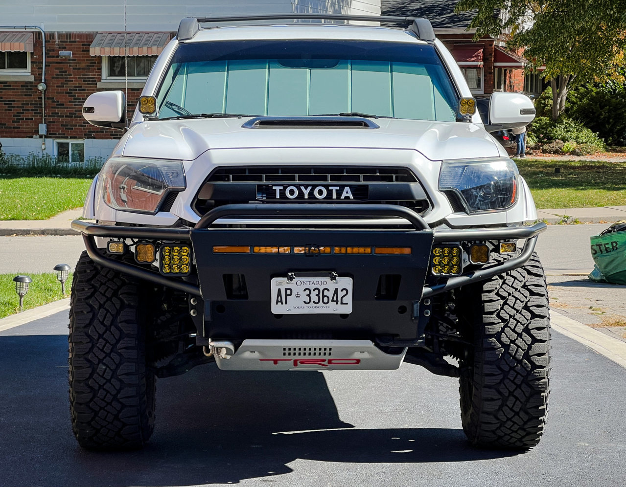

    ‘13 SUPERCHARGED DCLB TRD SPORT
    Will it work with a steel winch bumper?
    yaboiwebster likes this.

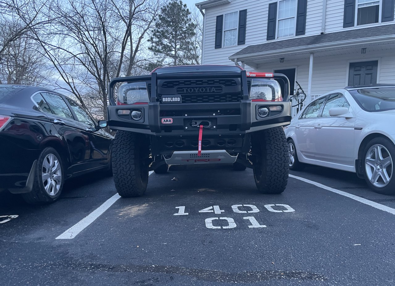

    I just ordered one, I have an ARB bumper with a winch. I'll fill you in on if it fits, I doubt there will be any issues though. I'll document the process for anyone else interested in upgrading.

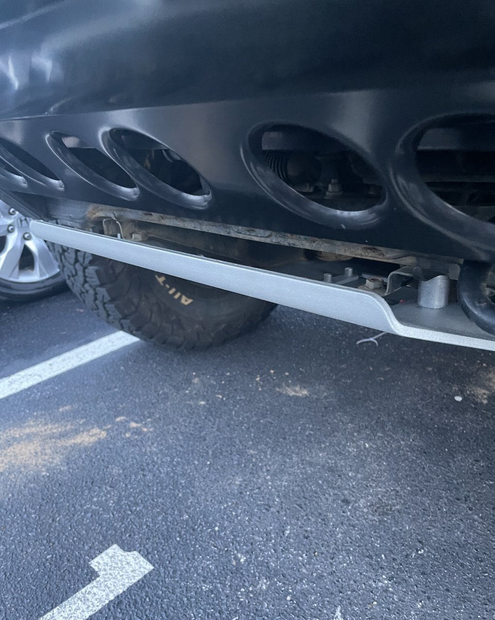

    It fit on no problem, if anything there's a kinda large gap between the bumper and the plate since it sits differently on the 3rd gens. The plate has 6 bolts, the front 4 use larger bolts and replaces factory ones, they mount in different spots compared to the factory skid. Before putting the skid on I recommend doing some rust proofing on the frame on which it mounts. It was a pretty easy installation, I did not need any spacers or washers that weren't included with the skid. I'm definitely happy with the install, however, it really just decreased my approach angle a bit. In the future, I'm tempted to try adjusting the spacers that come with the skid so it sits more flush with the bumper. Otherwise I'd definitely recommend installing one
    Removed the front two spacers and sits nice and snug against my C4 bumper.

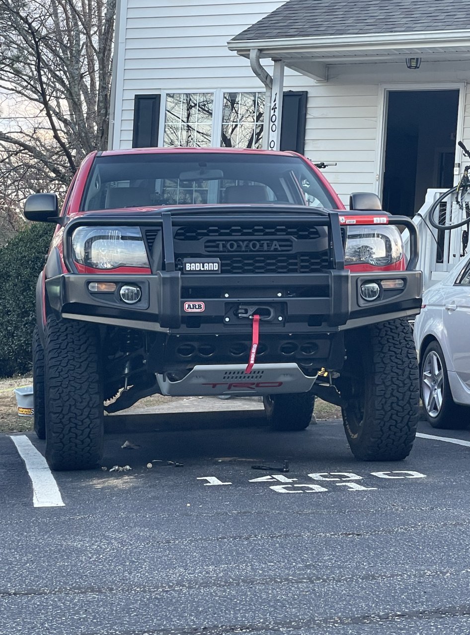

    Nice! I tried using some different shorter bolts but I ended up removing the spacers that came with the skid and placing two shorter spacers on the outside of the skid, got a similar fitment but it's currently resting against the metal cross members under the front beam. I've had mine on for several months now but the plastic TRD lettering popped out a bit so I'm getting replacement lettering soon.
    Here's the most recent picture of my rig.

    I highly recommend the 3rd gen TRD skid to anyone with a 2nd gen Tacoma. Paired with a bumper and TRD Pro style grill, it looks fantastic. It's also plenty functional. I've done several trips to Uwharrie doing every trail other than the frontside of Daniel, It has seen some damage but has held up tremendously. I will note it can make removing or replacing a CV Axle more difficult as you don't have a good surface to pry the CV out on. Other than that, it works great.
    I will admit it’s pretty beefy for an OEM option, the 2nd Gen version is a joke compared to this one lol! Only “modification” I had to do, rethread the last two back thread. Little bit of anti-seize on the bolts and we’re good to go! Canadian winters plus salt, it freaking sucks up here lol!
