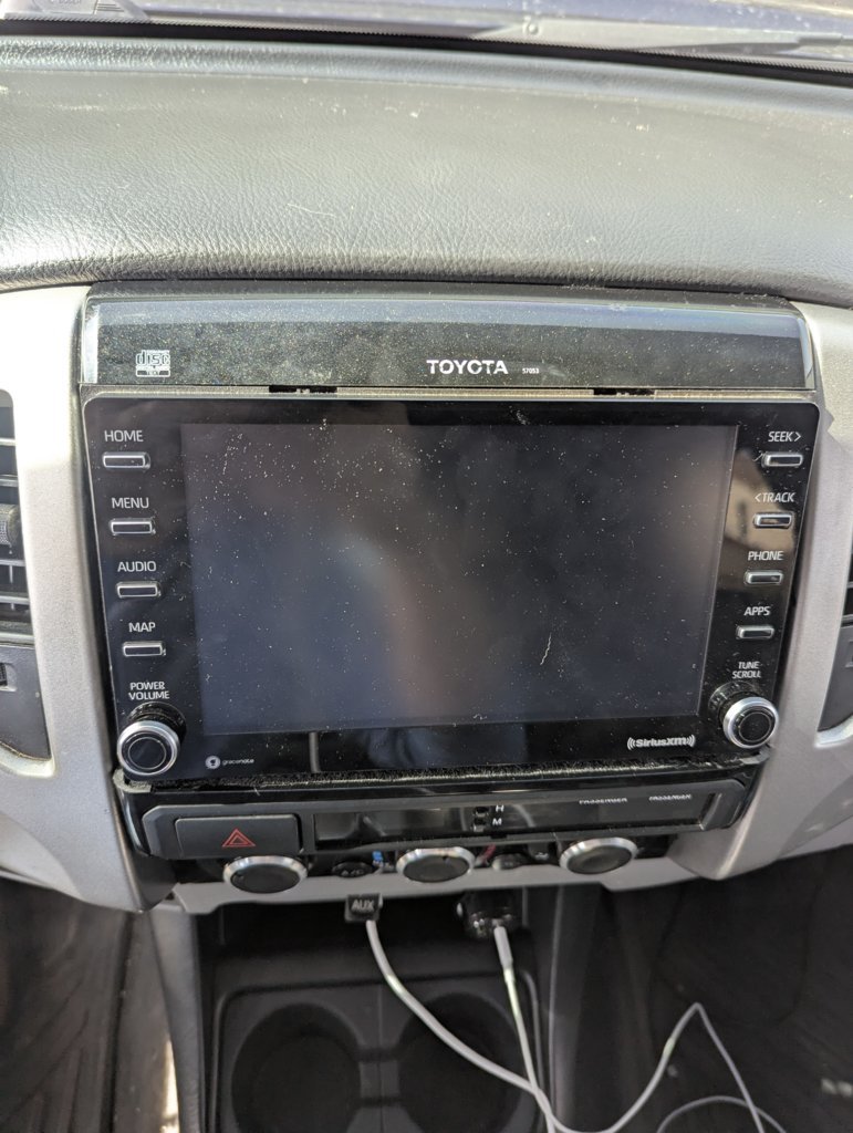

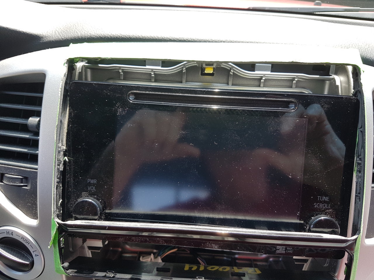

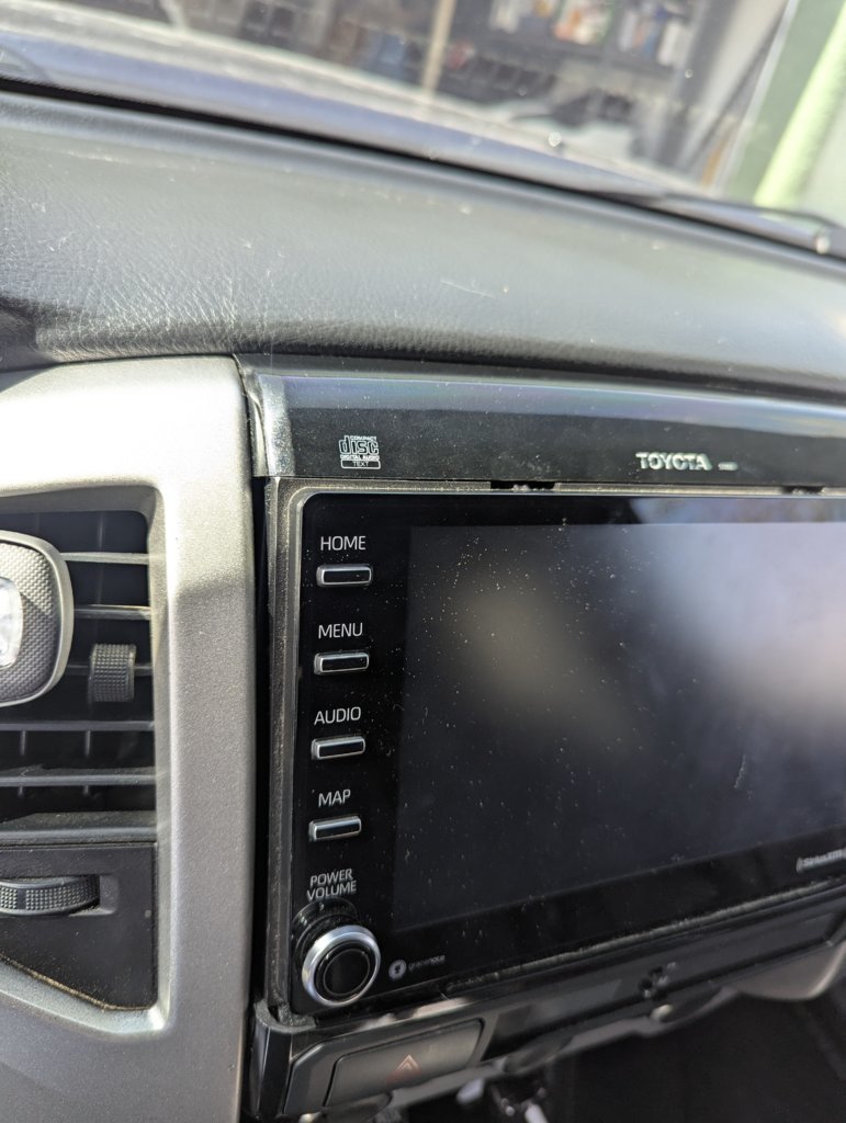

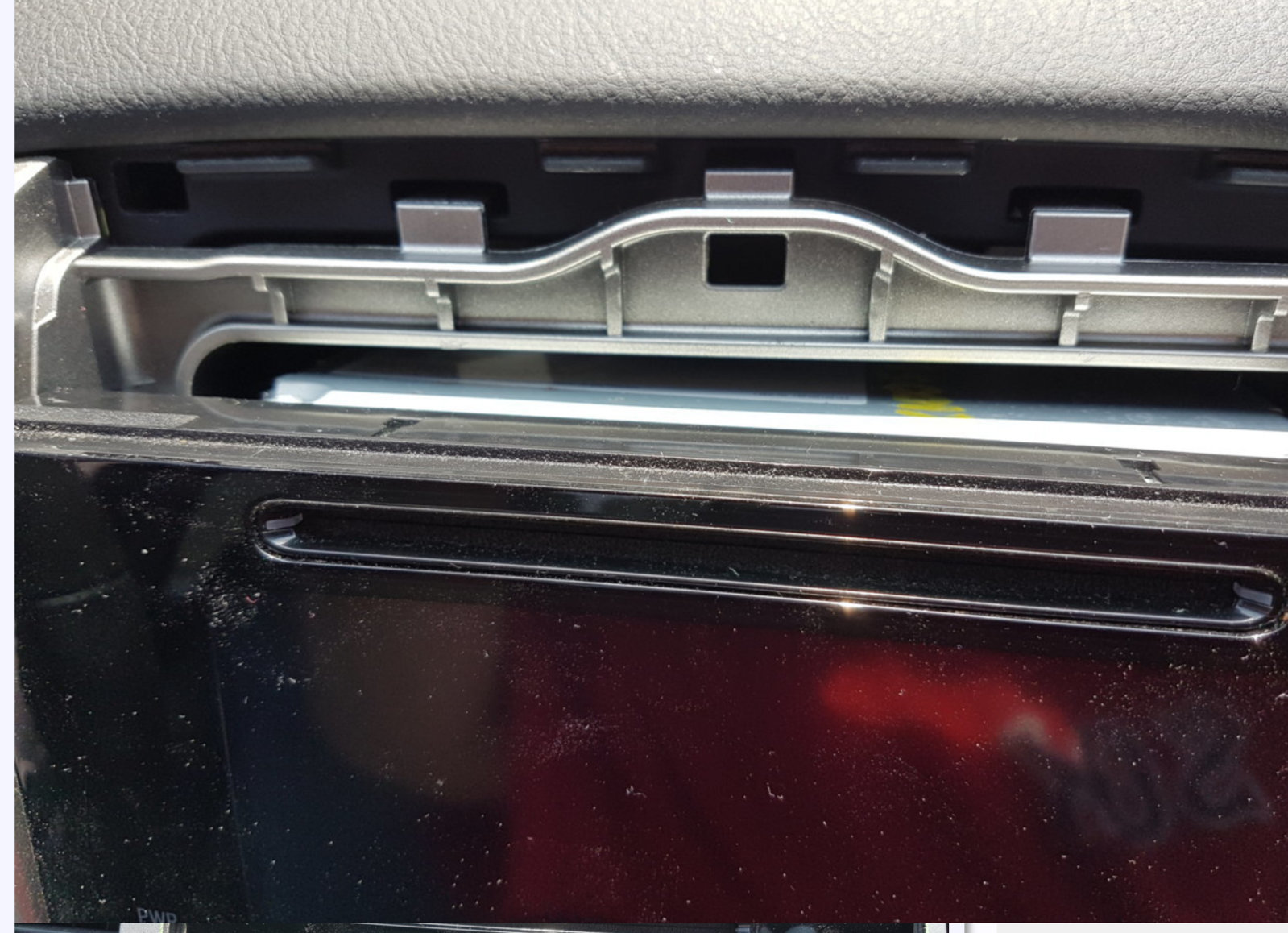

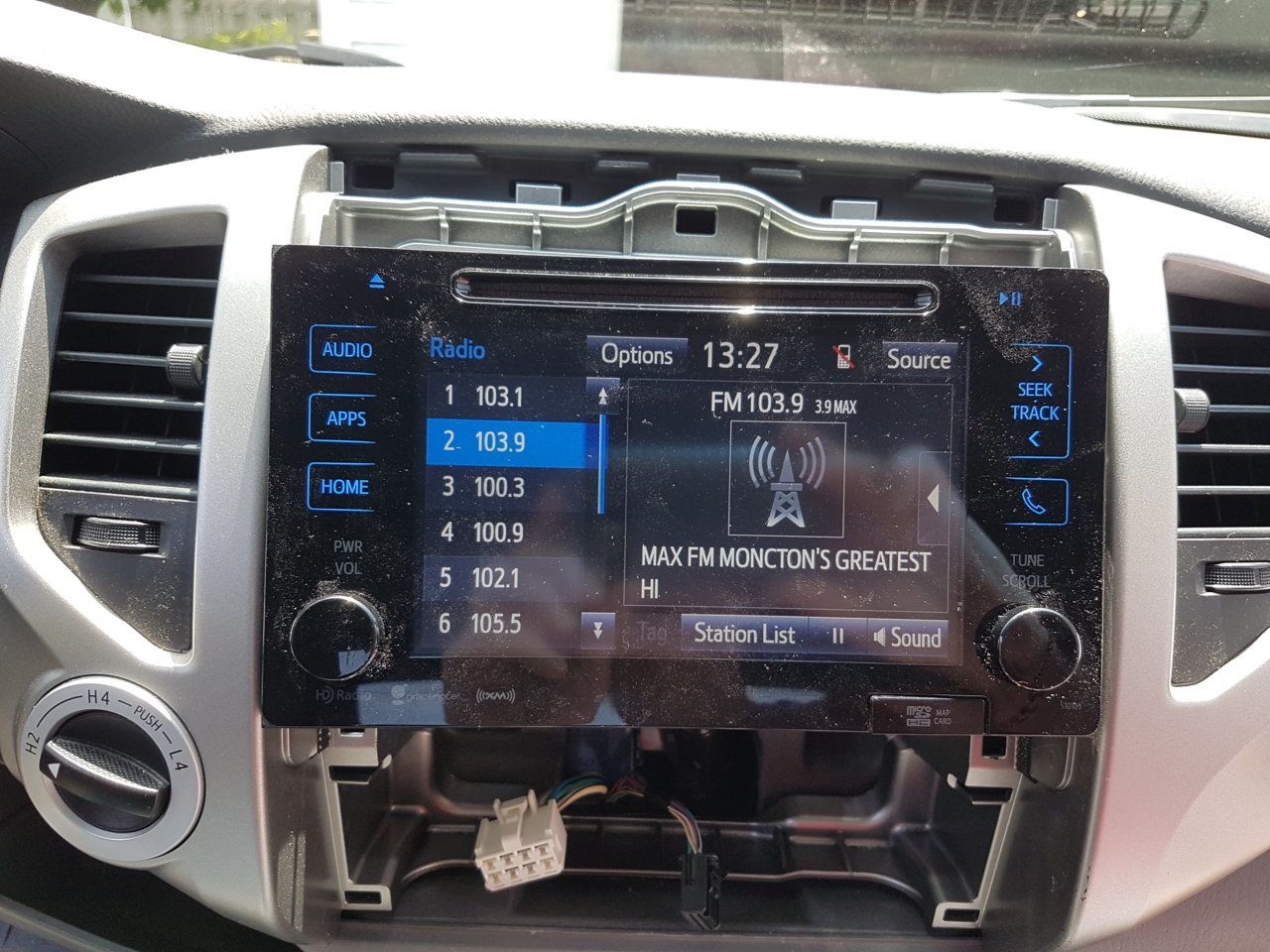

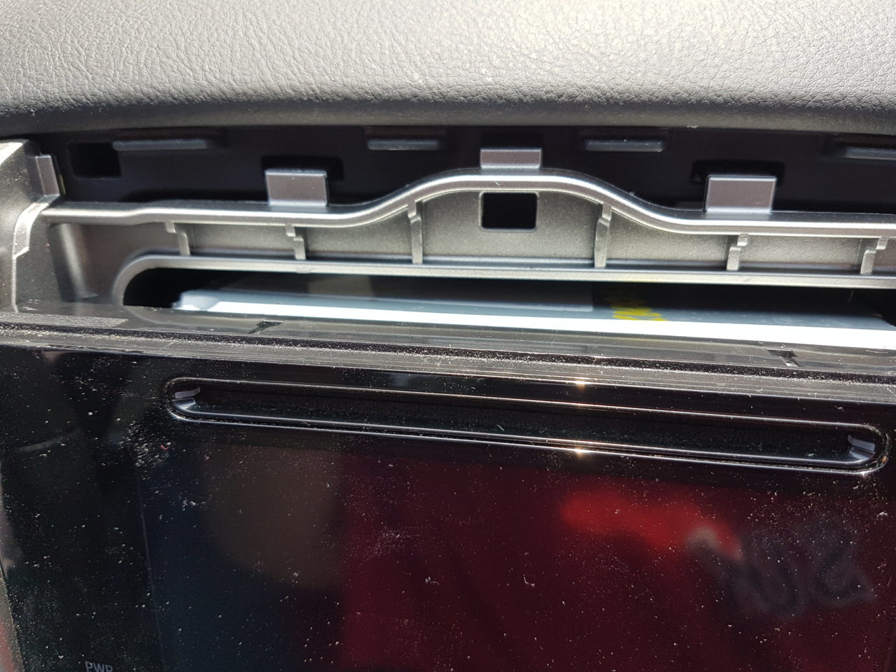

    Sorry guys had to get a knee replacement back in May so this got put on the back burner. I have been working off and on, on the junk yard surrounding and went out to test it today. Sad to report even with the mounting brackets slotted to move the radio up it still doesn’t have the clearance I need to get the surround in so the four way flasher module will fit. Would have to cut out the silver back panel and I don’t want to go that route. Have included some pics of what I am up against back there. Not sure on where to go from here, on a lighter note the original radio came back to life. first pic showed the backing which is stopping the radio from going any higher, second is kind of hard to see but shows the surrounding wher it would lock into the dash at the top and how much more the radio would need to come up and the third shows that all the connections work with the gen 2 wiring. I just sucks that somebody didn’t come up with a surround that would work with these radios.

    Unfortunately there are no commercial bezels out there, you have to do major modifications to the main dash assembly in back of the radio to make it fit. I modified the front bezel from a wreck and got the radio to fit it but when I went to install it the radio came up against the main dash assembly as shown in the pic. You would have to cut out the silver support plastic enough for the radio to be moved up also the original metal radio brackets have to be modified, the holes need to be changed to slots to make the radio also move up to clear the four way flasher module. The whole project is doable if you are not afraid. Was going to get the silver part of the dash to try out first but the wrecking yards up here want too much for them.

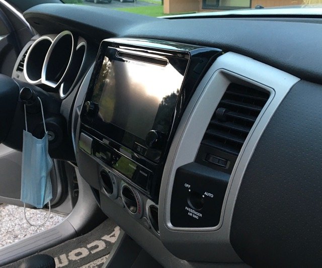

    Hi folks
    Here is my first participation in this great forum

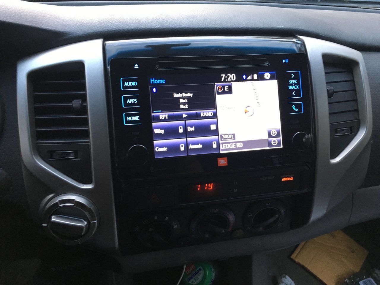

    Just complete today installation of Entune 2 (very nice OEM unit) in my 2009
    Look awesome with "Awesafe" type modified bezel
    Lot of work on chinese bezel, radio silver surround and OEM brackets, plus some trimming on Entune sides
    If it can help someone, i could describe all steps

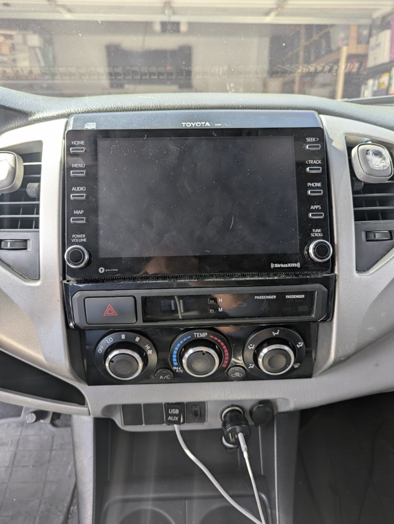

    So this is where I've gotten to in my project.
    With the harness kit everything* was plug and play. The silver vent piece required a decent amount of trimming on the sides and top of the hole and none of the cuts are visible with the fascia pieces on. The metal brackets needed to be cut as well to raise the whole unit ~10mm up. The brackets need some more fiddling so the face angles back a few degrees. I ordered some eBay fascias but after testing I chopped up the original fascia. The sides got cut out and the remaining pieces got sanded flat. There's a gap between the bottom of the radio and the bottom fascia pieces that I have Velcro in currently but I'm thinking to replace it with something akin to a foam gasket.
    PXL_20250217_194012257.jpg PXL_20250217_193929216.jpg PXL_20250217_193931461.jpg
    *The backup camera wasn't displaying on the headunit and I went on a wild goose chase that had me digging through the wiring. It was two blown fuses :( 7.5a under the hood and a 10a under the dash. Gotta remember KISS (keep it simple stupid)

    LeKid
    LeKid New Member
    Aug 3, 2024
    #454479
    2
    2009Tacoma SR5 2.7 l
    Scocar
    Sorry for delay to answer
    My reference to "Awesafe TYPE" was only for the form of bezel you can find at AliExpress for about 15 US$
    It is designed for a chinese radio with trapezoid form (Only for 2005-2011 Tacoma)
    So, some work must be done on it to give it a perfect square shape opening
    Not very easy, but didn't find nothing better
    I was pretty sure the bezel of 2012-2015 fit 2005-2011, but appears to be Narrower (look at pictures of black OEM cutted bezel at previous tread)
    So, my solution apply to 2nd gen A not B
    I had no interest to fit a 2Din radio format as I prefer OEM modern Toyota radio look and no need of Android or Apple connection
    Hope it is still time to help you with this information
