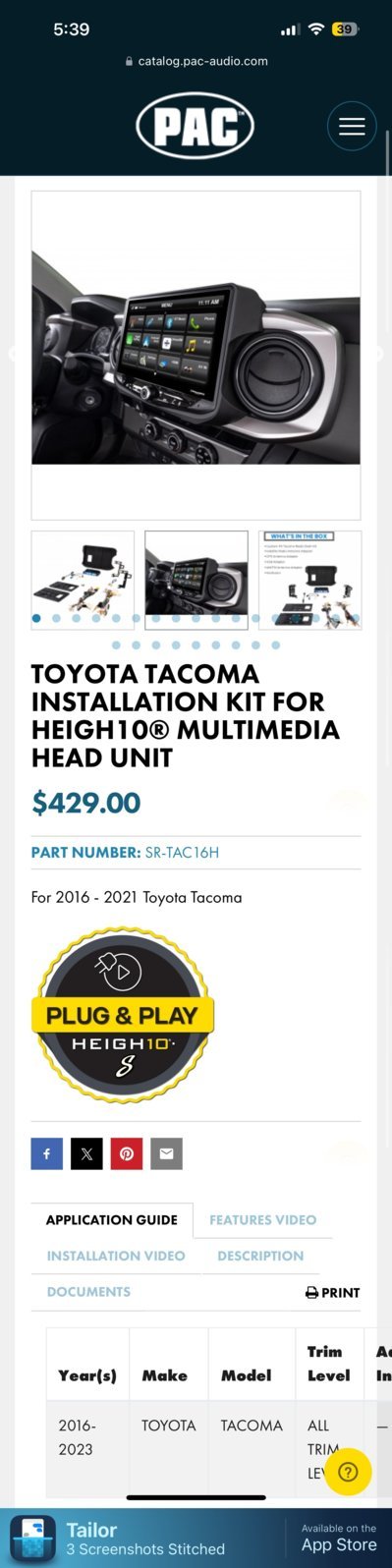

    I am already committed to option 3 but still am planning out the build. If I replace my stock HU with the Stinger Heigh10 do I still need a signal processor like the Rockford Fosgate DSR1? Or can I run RCA's straight to a 5-channel amp and throw the POS JBL in the trash?

    If you replace the head unit AND amp, you do not need any interface with the jbl equipment. RCA’s straight from new head to new amp is all you need
    I would still get the PAC amp harness so simplify your speaker wiring process and prevent having to cut up the factory wiring

    Great thank you so much!
    I am going with the Stinger Heigh10, are you referring to the wiring harness that you buy with the Stinger or can you give me a link to this PAC harness? Also I have a 2022 and the Stinger kit only specifies up to 2021, will this work for my truck?

    I do believe there were some differences between 21-22 so I would call PAC audio directly (they own stinger) and ask their tech support. They’re extremely helpful and should either know the answer, or be able to find the answer faster than most people
    *update
    it looks like they have the custom kit listed as 2022 compatible, even though it’s labeled as 16-21

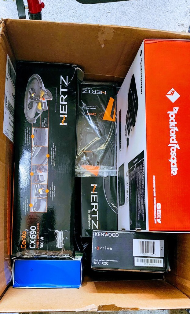

    Goodies in box all installed yesterday, kept factory head unit. Doors deadened. Shop did a great job. Sounds unbelievable for OEM head unit. Sub woofer needs to be changed but the RF amp has made it move much more than the stock amp did before. Very nice upgrade..
