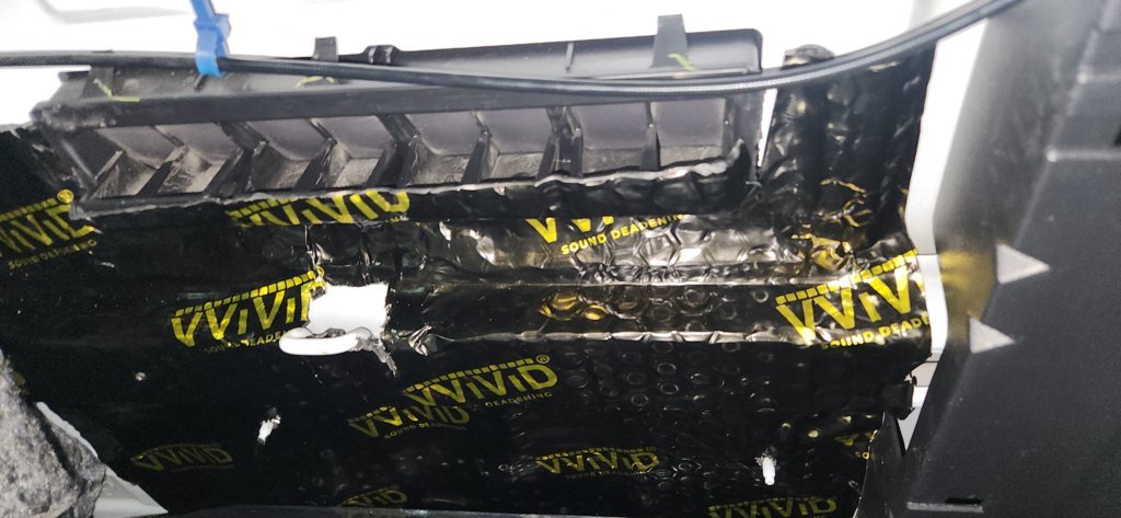

    Any chance you can grab a pic? I'm having trouble picturing the bolts you're talking about

    Just those 2 white screws toward the bottom17361253425848935640299240026631.jpg

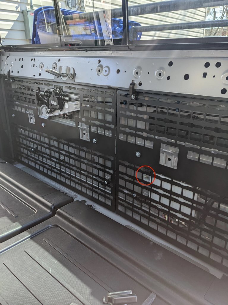

    the hook is for a child's car seat. most subwoofer boxes will fit under it, so dont ditch it just yet.
    those bolts can go. some trucks had a computer module or something mounted on the back wall (honestly not sure what it is and I dont feel like figuring it out) and those were the mounting points. If you dint have the module, you dont need the bolts.
    One can be seen in this image, holding the module to the wall

    So i can cut them off flush or at least flush with that material? I don't guess i can take them out but I can cut them down easy enough ,I'll give the fit a try before I cut the hook ,it seemed like it was in the way when I test fit but hopefully I'm wrong I hate to cut anything I don't have too.but I won't be needing them mine is too big for a seat now. Thanks for your help !

    Yeah the bolts can just get cut flush with the back wall, or at least as short as you need to make your box fit.
    Definitely do a test fit to see about the hook. You never know 100% if you may have a time pop up where the truck has to get sold, and the next buyer may have little ones. But if it needs to go, it needs to go
