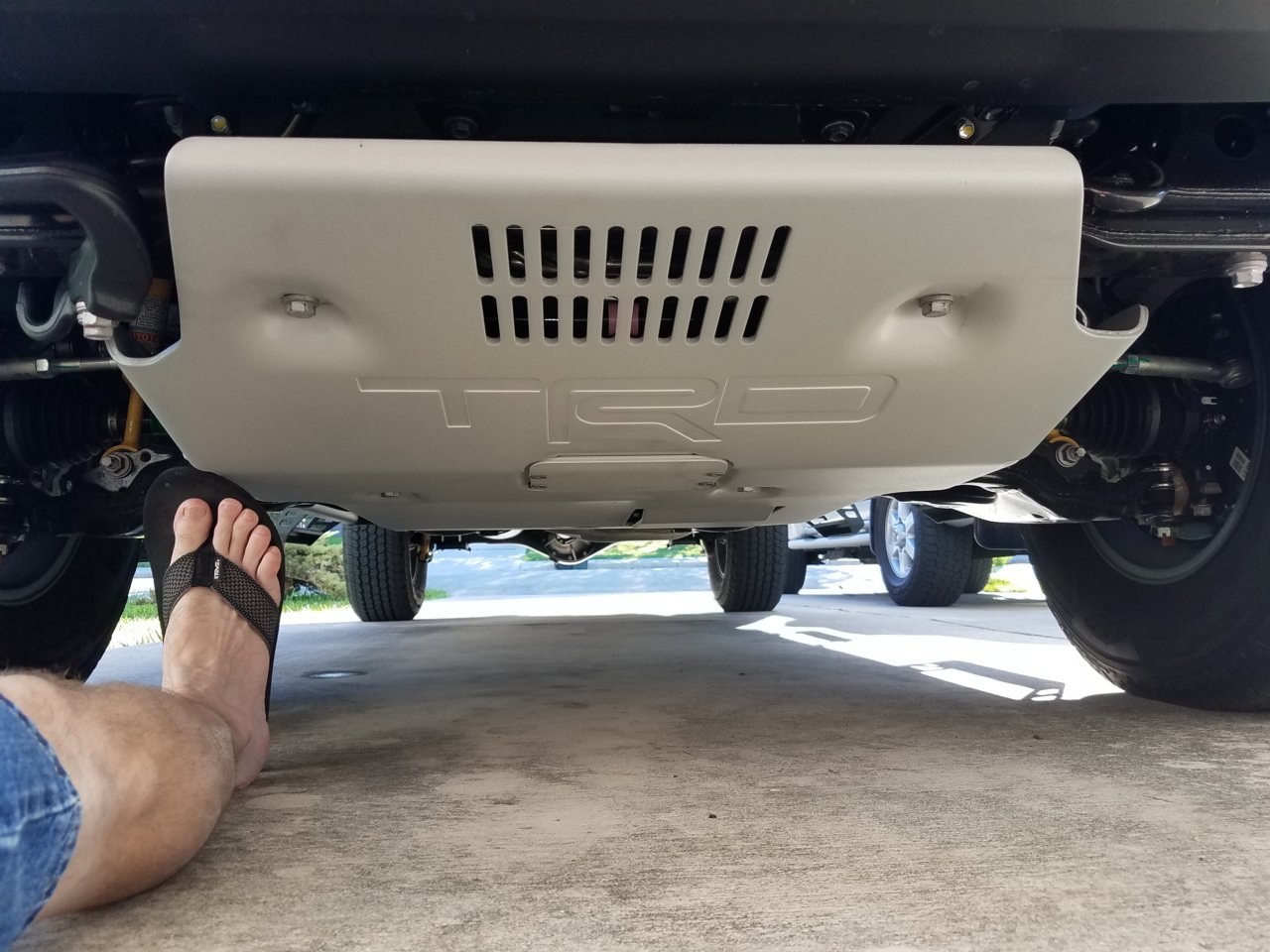

    Yes you can stick the trd skid on your sr5. Not a very good shot, but it's under there.

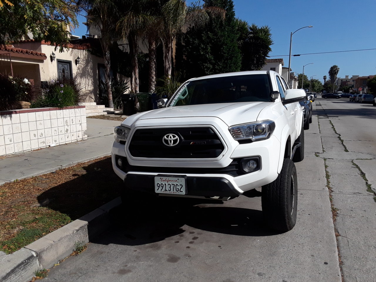

    I have an SOS Offroad Concepts skid kit on my 3rd gen SR5. The front skid is the IFS skid. If you want to go all out, I also recommend the mid skid and tcase skid.
    This pic has the streamline bumper on there too, but you can still see the front skid just below it:
    The only holes missing on the SR5 for skids are for the tcase skid. You'll have to drill those. The factory front / IFS skid is a direct bolt-on though, after you remove the front air dam.
