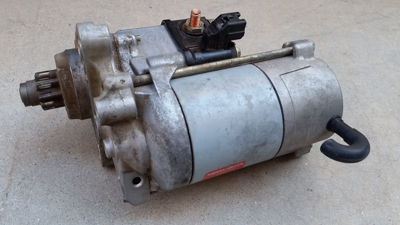

    On a second note, i'm curious if anyone else has some advice on how not to kill your starter every time you drive through water. Saw there was what appeared to be a breather line coming off the starter and it got me wondering if anyone has extended it up to a higher spot in the engine bay.

    A starter breather line? Would like to see pics of that.
    Edit: Apparently there is such an item.
    https://forum.ih8mud.com/threads/my-starter-breather-fix.1034083/
