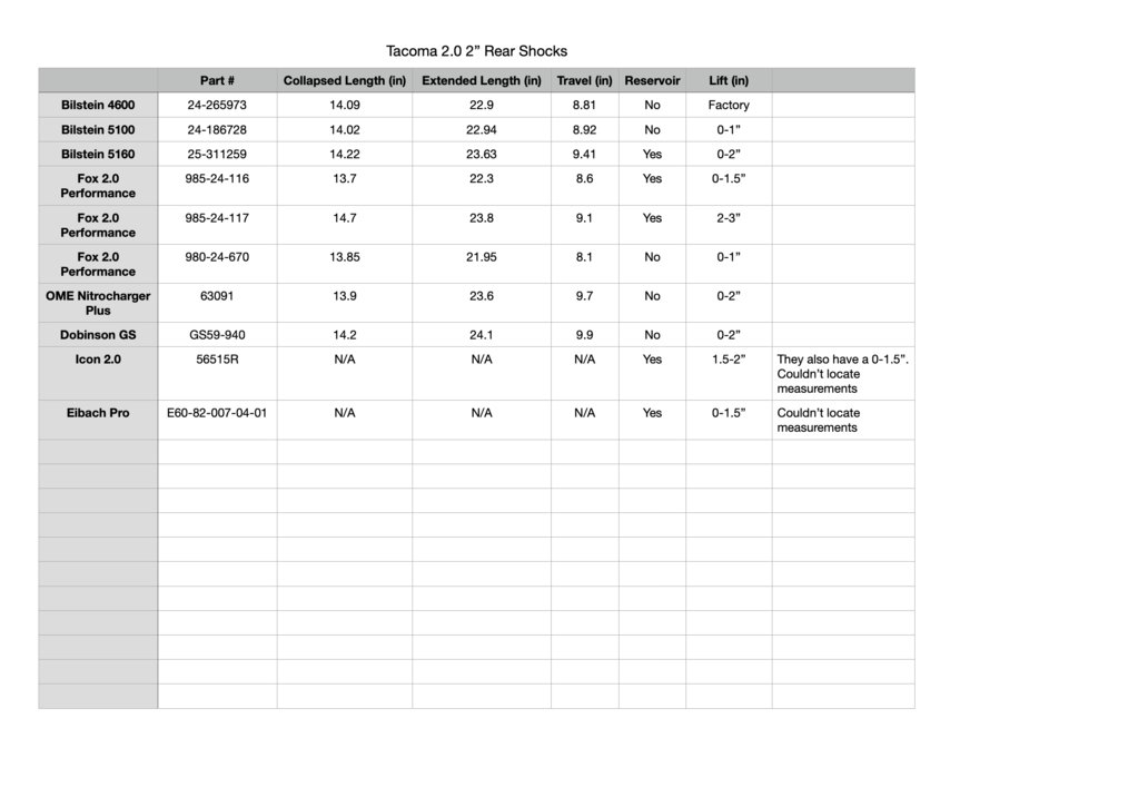

    Hello all, I am was in the process of researching a new leaf pack for my truck. While doing this the thought about different rear shock measurements limiting travel came to mind. I had a hard time finding all the information in one place. I compiled what I could. For some reason Icon or Eibach don't have the compressed and extended lengths listed on the websites. Below is a list from most of the trustworthy company's. These are the more commonly used shocks used when achieving a 2" lift.Tacoma 2.0 Rear Shocks.png
