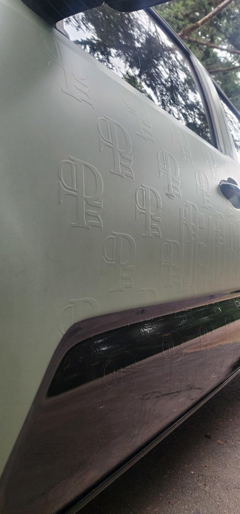

    Closer look at the doors. Embossed logo.
    Drove the truck all day. Breaks seem great and the chevy 350 is putting out tons of torque. Still grabbed a chevy master cylinder in case I decide to swap it out at some point. Ill keep this thread updated as long as im adding mods to this truck.

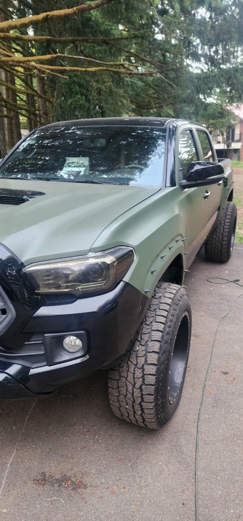

    Also notice. 1-1/2 brass spikes for riot control. Zang!!!!
