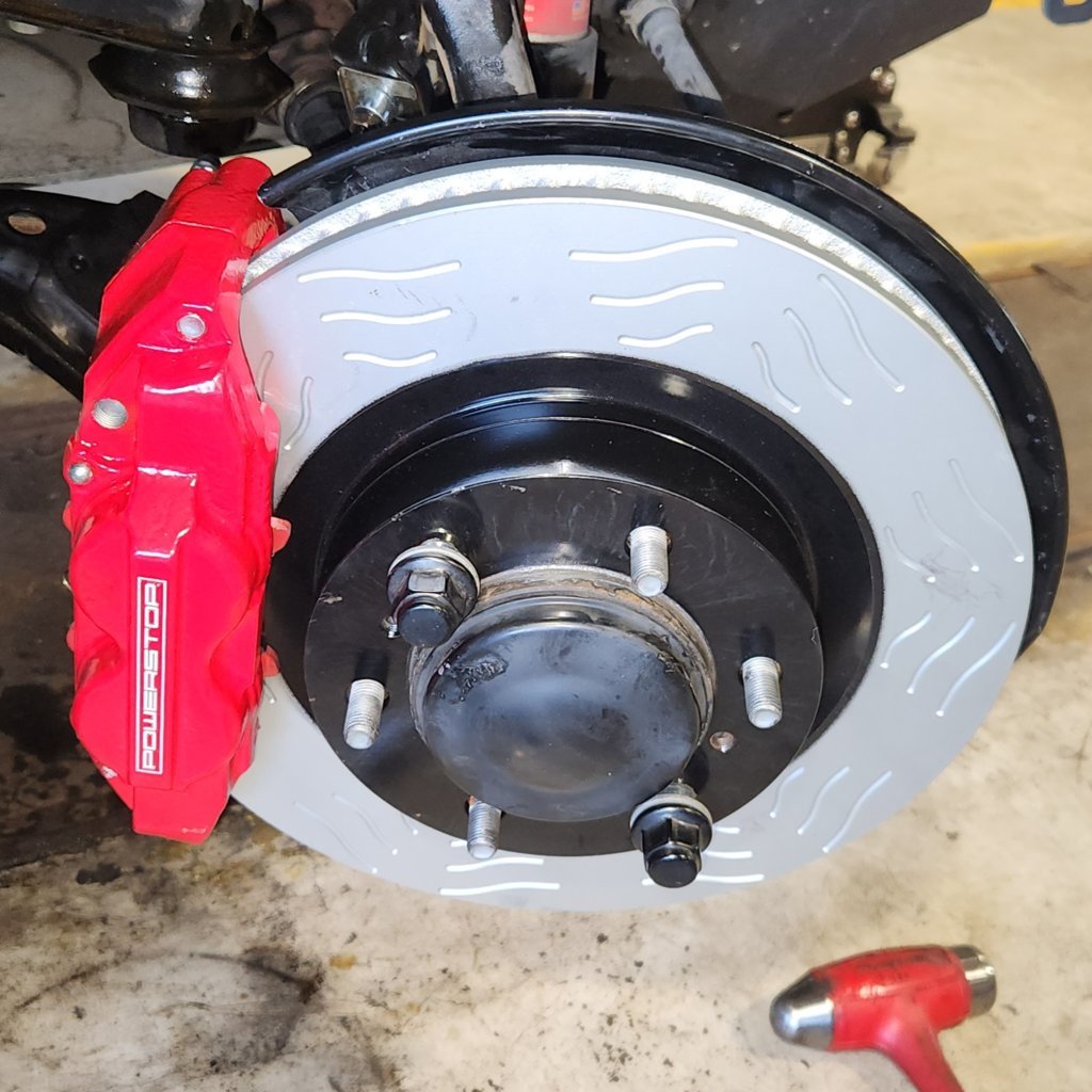

    If you end up needing to do your front brakes before you do your SAS, you can swap in larger rotors and calipers meant for a 5th gen 4runner or LX460. They bolt right up. The larger mass keeps them from overheating as quickly so the rotors won’t warp as fast and you won’t get as much brake fade. And they look nice behind the wheels. You will want to pick up the larger dust shields too.
    Cryptics1984[OP] likes this.

    I did this swap already. I am very happy with it.
    I wouldn't recommend the Raybestos S-groove rotors though.
    I used this 2nd gen post as reference.
    https://www.tacomaworld.com/threads/completed-5th-gen-4runner-bbk-upgrade-for-2nd-gen-tacomas.504234
    The front brakes on the 2nd gen are the same as the 3rd gen. So everything in the write up applies.
