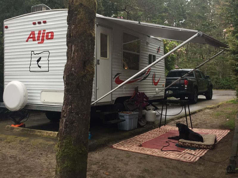

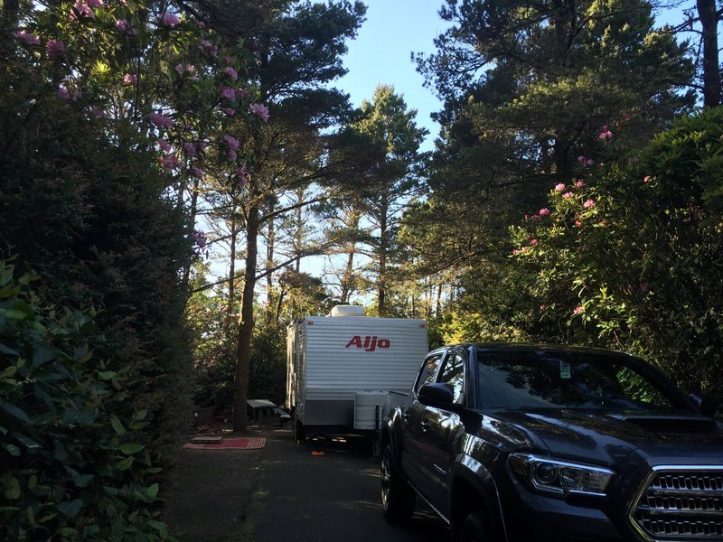

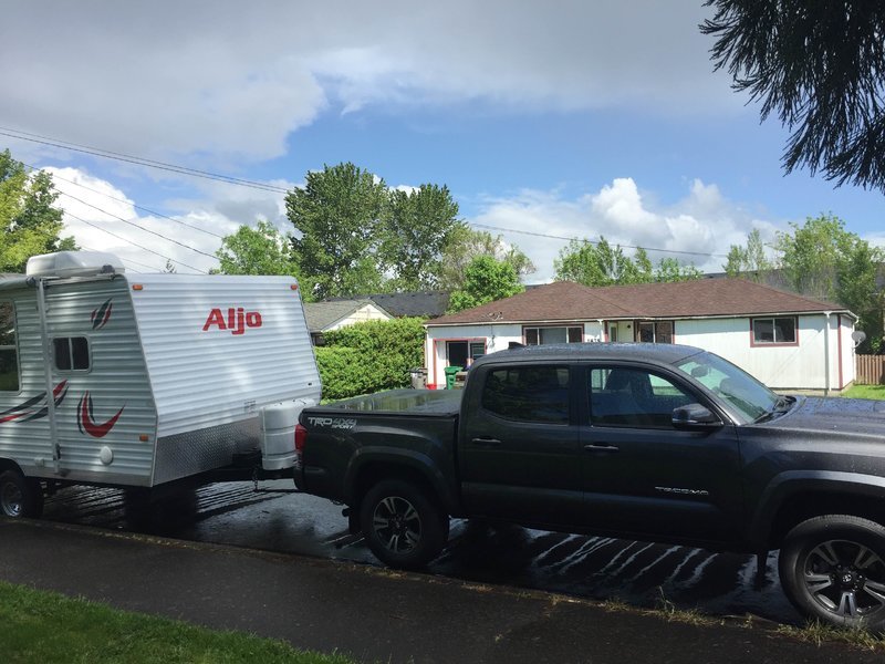

    Traded in my '14 TRD Sport Tacoma for a '16 TRD Sport in December and towed my trailer for the first time this past weekend. Trailer is about 3100lbs unpacked and probably about 3500-3750 packed up. I was in S4 who whole time with the ECT button engaged. My trip was very hilly (up and over a few mountain ranges). I thought that it towed pretty similar to my '14. I average about 10.8 MPGs - not great but it is what it is.

    Pretty sure your dog has no complaints! #SpoiledRotten

    haha you are right! she had a great time and was on her best behavior this trip so she got her bed outside under the awning! :dancingbacon:
