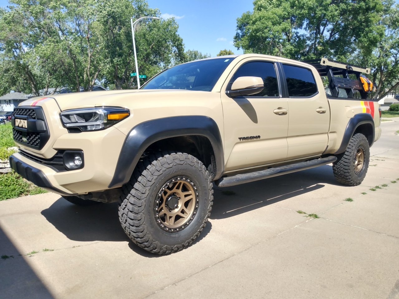

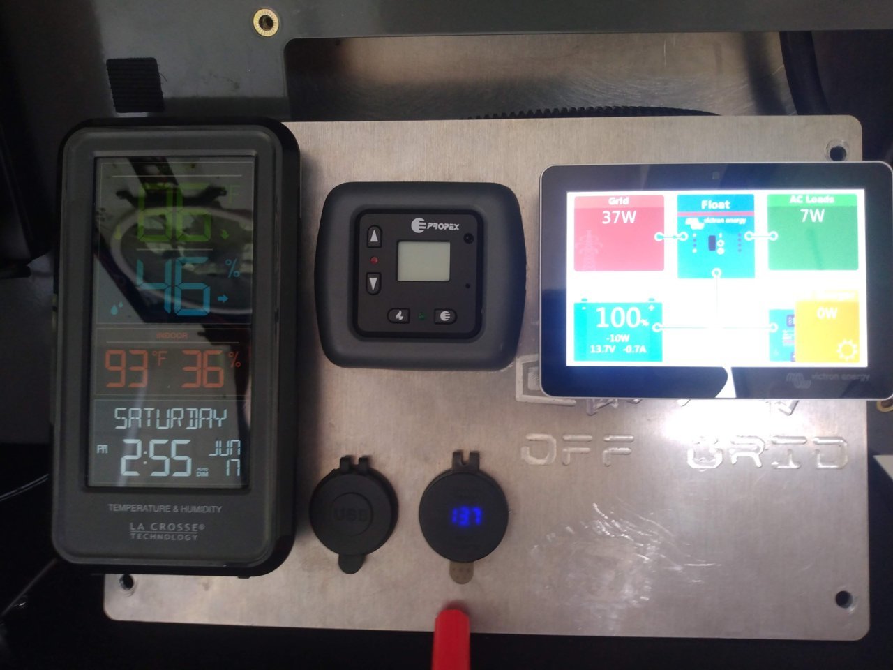

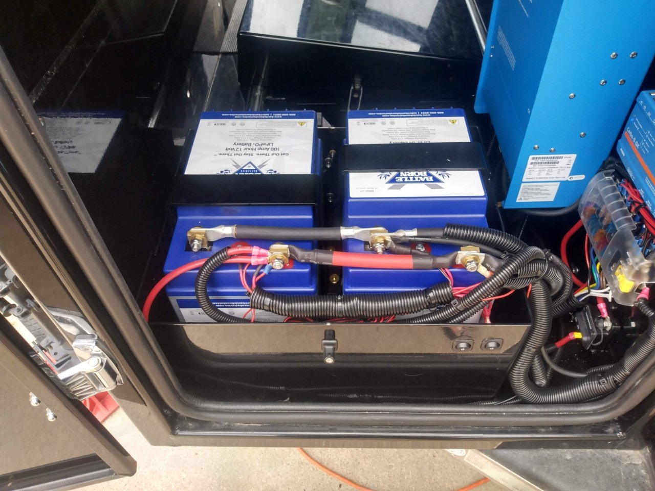

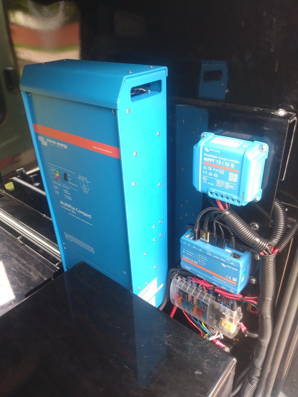

    Just got done with a full electrical upgrade on our 2019 Off Grid Expedition 2.0 from the OEM to all Victron Energy, including smart shunt, solar and two Battle Born LifePo4s and a Jackery 200w solar generator:
    We also have some interior upgrades planned, but are waiting for parts atm.
    We got the tow rig upgraded now and have not had a chance to tow the EXP 2.0 yet:

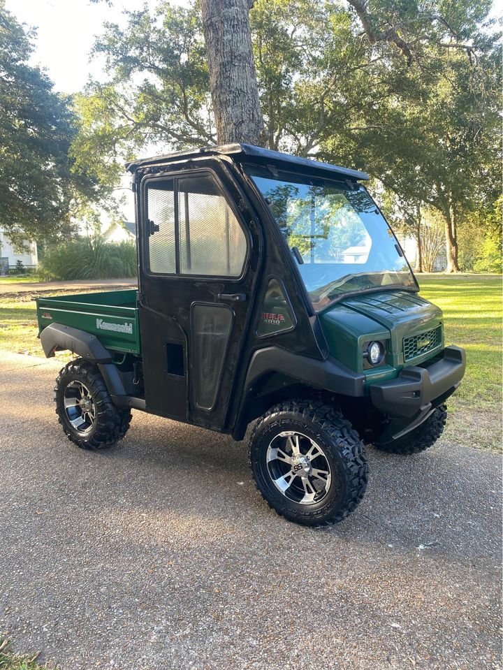

    Towing a Mule with your Tacoma? Damn man you've got good taste in vehicles!
    My Mule is a Pro MX.

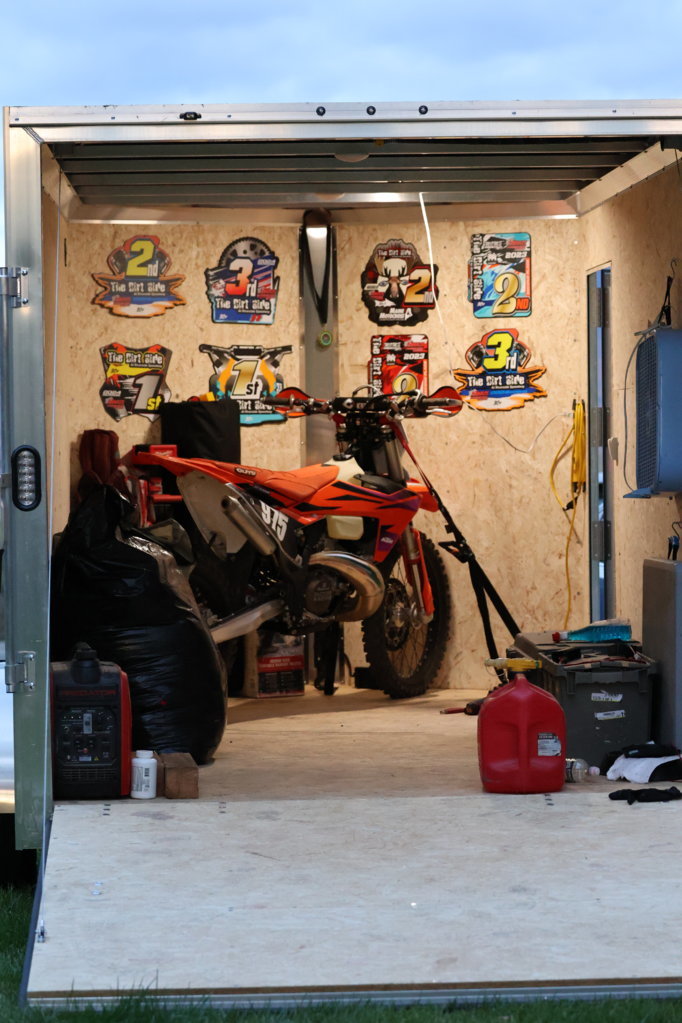

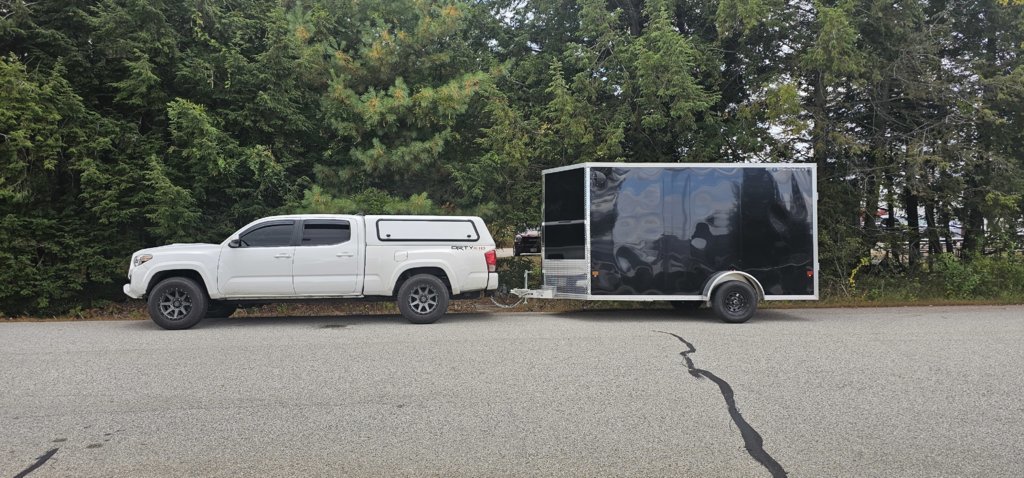

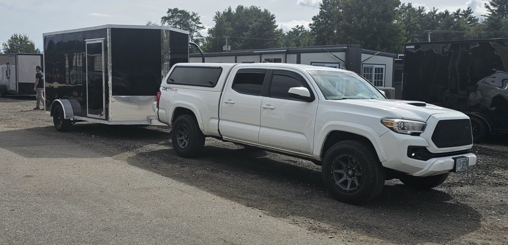

    Picked up this 7x12 v nose a few weeks back for a moto trailer / sleeping at the track setup. 1190lbs empty. Pulls great around town. Anything over 60 and the wind resistance really holds you back. IMG_6170.jpg

    Yep... a brick towing a bigger brick is never a good combination.

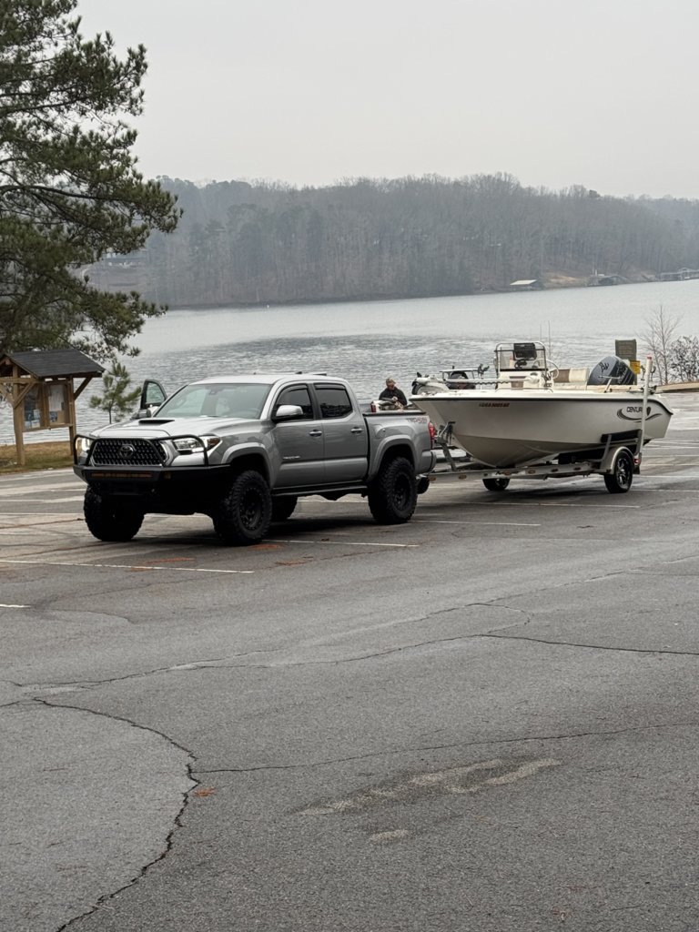

    I tow a 18’ boat with my Tacoma.
