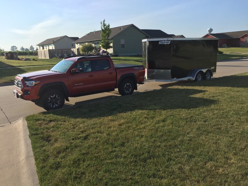

    I just finished towing around 220 miles today. Averaged 10.6 mpg at 60-70 mph. According to my scan gauge the transmission temp never got over 195 and that's with an outside air temp of 90 degrees.
    I did add a pair of sumo springs and if you are doing much towing or hauling I'd highly recommend them. It's been well worth the $215 and 20 minutes of work.image.jpg

    How heavy was the load?

  13. Jun 27, 2016 at 7:14 AM
    #373
    Hank_Mille
    Hank_Mille Well-Known Member
    Oct 12, 2015
    #166461
    587
    PNW
    2016 Tacoma Limited
    Nice set-up!
    What size trailer is that and are the stock side mirrors usable?

    It's a 7x14 aluminum haulmark, about 1900 lbs empty. The stock side mirrors are usable but I like having the extended ones for the additional visibility, especially for backing up.
    I've added the sumo springs and a tekonsha P3 brake controller. It's been a great set up so far.
