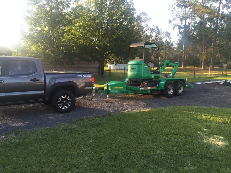

    My heaviest so far was trailer and mini-excavator at combined ~6500 lbs. Handled it fine, but I kept highway speed to <60mph to be safer.
    Acceleration was above expected, braking a little less so. Overall I think this truck is capable of every bit of it's rating.
  9. Jul 7, 2016 at 7:41 PM

    You had electric brakes on the trailer, right? I see an emergency pull cord but can't tell

    To be honest I doubt it, sure didn't feel like it. I just drove slow and used tranny to engine brake. Luckily it's flat here in FL.
    Correction: just checked the specs and yes it had them, but def didn't feel like it. I've had mechanical brakes do a better job than that.

    you doubt it? you don't know if the trailer you were pulling was hooked up to brakes, or not?

    Oh it was hooked up, but like I said, it didn't feel like it was doing much braking. This was a one day rental and I didn't have time to get the set-up all perfect. Just a 40 mile drive round trip.

    Do you have a brake controller installed? If not, you didn't have trailer brakes, just the lights.

    LOL then that explains it. Well she did mighty fine given no assistance.

    Most rental equipment trailers I've used had simple surge brakes to avoid needing a controller at all. Not ideal but it works okay and keeps trailers legal without the need to add a controller to every vehicle that comes in the door. The exception is trailers with pintle or 5th wheel hitches, in that case the rental places verify tow vehicle compatibility.

    oh wow he doesn't have a controller.....
    you could get a g sensing unit that goes inside the trailer with power and brakes the unit.
