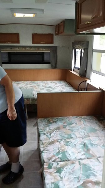

    Rig.jpg InsideHILo.jpg Inside HiLo2.jpg Outside Hilo.jpg Bratsinstorm.jpg At home.jpg
    Someone wanted to know about towing a HI Lo Trailer. Here it is.
    Found a 2204T model in Traverse City, MI. (2004, 22foot Travel Lite). I live on the other side of Lake Michigan, 40+ miles West of Milwaukee; about 450 miles each way. Left to look at it Thursday night. Wife and I liked it. Raises and lowers like shoe box, electric, hydraulic and SS cable. 12 - 15 seconds up or down. Weight is 3,850 dry. Added WD hitch. Put in Tekonsha 3P last weekend following great advice here for mounting in small hole left of steering wheel; SUPER folks and thanks for instructions, 15 minutes and in.
    Drove down late Friday from RV dealer to Manistee National Forrest and found campground at a place called Baldwin ( 70 miles North of Grand Rapids) with water h/up and 30 Amp for AC (in 90's with matching humidty). Stayed Friday night, Saturday and early Sunday getting trailer set up and getting used to it. Figured weight with AC, awning and wife packing for armagedon about 4150lbs + 4450 for Taco. Electric brakes on trailer.
    Expected 6 hour trip around bottom of Lake Michigan, turned out to be 11 hours with expressway construction in Michigan and Indiana. Really ugly with hour long idling stops on expressway. Hi Lo trailed like a dream, trucks, lots o' trucks around bottom of Lake on I-94/80, never bothered trailer. I have sway bar but wasn't set up for it yet. Didn't need it. Maintained 55 - 60 with trailer when I wasn't parked in traffic or battling rain storms, had to pull off road once. Four tanks of gas back and forth; on way up Fuelly gave 26 mpg doing 70, pulling Hi Lo from mid Michigan fillup to near home fill up was getting 16.9 by Fuelly. Taco was superb towing and kept about 2,500 rpm in 4 sport. Rolling steep hillls and s curves in Northern Michigan, no problem. Took Taco to dealer today for 20K, had him check suspension and everything is in good order.
    Will add pictures from cell phone.
