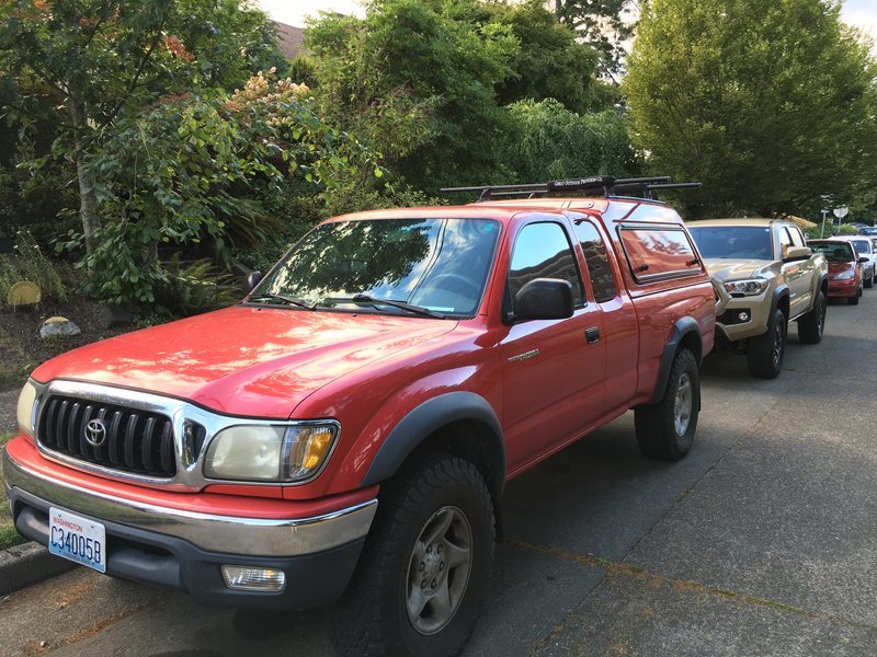

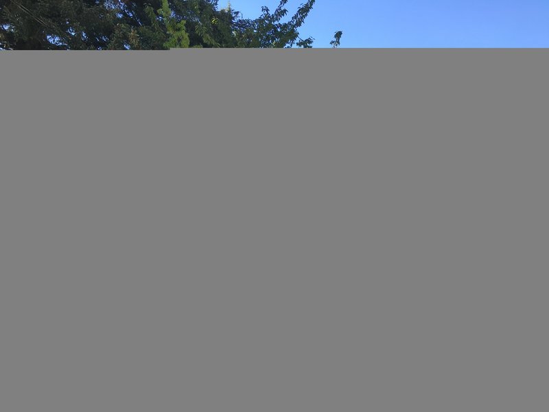

    Towing anything more than a utility trailer with a Tacoma is very feisable, but most definitely an experience in towing. It most definitely is not an experience in over-trucking, towing a 5,000 pound trailer with a full ton diesel. If you can acknowledge this fact, the Tacoma is an excellent rig for towing a small to medium sized trailer.
    In our case we picked up a 16-foot Airstream (2,700 pounds dry and right around 3,000 pounds wet) in March. We crammed our year-old son into the extended cab of my 2001 Tacoma TRD with a 5-speed (the right carseat does fit), hooked up the trailer, and headed out. This setup worked great heading from the coastal side of Washington state over Snoqualmie pass to raft the Wenatchee a few times. The little truck proved its moxie in spades hauling everything from coastal Washington to Idaho and all over Idaho rafting for a week this past summer.
    This summer we discovered a second son is now on the way. Unfortunately, although I loved my 2001 Taco named Chuck, he did not have four doors. With two kids, four doors unfortunately was an imperative. We ordered and took delivery of a 2016 Tacoma TRD Off-Road with the towing package, four doors, five-foot bed, and a manual six speed a couple of months ago. This one’s name is Jeffe.
    While waiting on Jeffe to arrive, I did a bit of research, and learned a bit about how Jeffe works. This really helps when towing. First, this engine has more ways to cool itself than any other truck I have ever owned. Being Jeffe a standard, it does not have a transmission oil cooler, but for the engine there is a engine oil cooler, and a very robust water cooling system. Second, the variable valve timing (Atkinson thing), fuel mapping, and even the drive by wire system does not give you access to the torque and horsepower until around 3,000 through about 4,600 or so.
    If you are towing, wind this engine up. The reason is two fold. First, lugging the engine – trying to run in low RPM’s is not good for your engine anyway. It runs cleaner and cooler under load when you wind it up. You’re not driving a V8. Don’t drive it like one. Second, do not fret about making it work. This is where all this cooling comes in. The temperature gauge never even budged this summer when running all over the Olympic Peninsula chasing a friend towing an R-Pod with an Avalanche.
    For impressions and thoughts, the truck tows great, but is definitely towing. The rear springs are softer than I expected, softer than my 2001. When towing, the Tekosha P2, definitely is good to have for keeping the trailer behaving when braking. We do use load balancing bars, but I do not fool with a sway controller since our little Airstream has never posed any issues with wandering. The mileage, not surprisingly, is absolutely terrible – typically in the eights or nines. We are towing, so what else can we expect?
    The rear springs are a bit of a surprise. Using the same hardware as on my 2001, the trailer is slightly tongue down. I’m going to have to adjust the hitch on the shank, or get airbags to level it out. I’m a bit torn in this regard as I do not want to adversely affect articulation. This is something I need to research before making a decision.
    Finally, I love standard transmissions. Although any dealer will tell you otherwise, I prefer them for towing as well. A standard enables you to completely control the engine RPM’s to target the power band you want, and also enables you to control the load coming downhill. I’ve also been driving manual transmissions for over 20 years now, so this may make me a bit biased as well.
    Overall, if you want just a tow rig, and are skittish about towing, get a half-ton with a small block. If towing does not bother you, and you want a good balance of towing, off-road, and driveability around town, the Tacoma will not disappoint.
