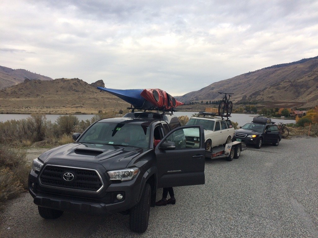

    I recently completed a trip with my 17 DCSB TRDOR towing a 1700lb trailer with a 2800lb car on the trailer totaling about 4500lbs. I also had tools, jackstands, and a jack in the truck.
    The truck has sumosprings SSR-610-40 and a weigh safe hitch (to make sure tongue weight is within 10-15%). The truck towed very level with 500lb tongue weight on it. I kept it in 4th gear and it towed pretty well for a midsize. Got 12.8mpg there and back.
    Just wanted to post my towing review.
