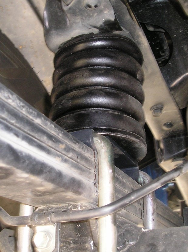

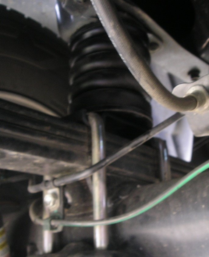

    Maybe this information will help someone else here who is thinking about installing na upgraded rear suspension modification to help with towing. In my case I hope to be soon be pulling a lighter weight RV trailer. So after seeking other forum member advice and my own research I opted to go with the SumoSprings instead of rear airbags. I called SuperSprings and talk with the tech support and it was there recommendation that I go with the middle weight springs. The part number and weight load for the SumoSprings for the third generation trucks is the following.
    SSR-610-40 for 1000Lbs.
    SSR-610-47 for 1500Lbs.
    SSR-610-54 for 2800Lbs.
    I hope this helps out anyone who is considering installing the SumoSprings rear upgrade.

    Okay finally got the SumoSprings, installation went fairly smooth though anytime you unbolt your rear axle from the springs it kind of makes you go hmmm... Must tools are 3/4 deep well (long) or 16mm. socket but also a good stout torque wrench since you'll be torquing the nuts on the axle ubolts to 90 ft. lbs. in stages and a hydraulic scissor or bottle lift. Helpful tools to have on hand are a ratchet wrench and a breaker bar. All I had to do to install was to jacket up the truck on its frame a bit before the rear wheel one side at a time, unbolt the ubolts, slip out factory rear stops, then slip in SumoSpring and finish by bolt it all back together. No big deal! Hope this helps anyone else who is considering using SumoSprings to help with their towing.

    any picture how it sits with weight

    Not yet, stay tuned!

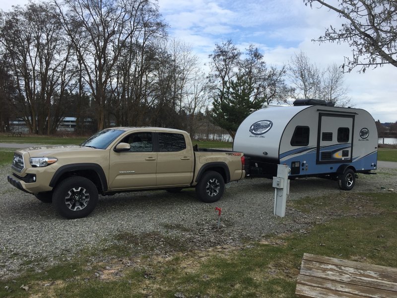

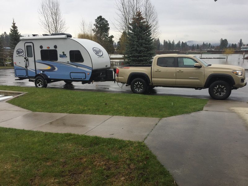

    After adding 1300 miles to my new '17, I started hauling our Rpod 180. It weighs in at 2950 lbs as built with an 850 CCC. Hauled it about 450 miles in two days over three mountain passes in MT and the Tacoma did really well. Based on what I've read here, I used the ECT with the AT in S mode. Flat ground/windless speeds are easily 70+ with the RPMs ~ 3200 in 4th. I had no issues when dropping it into 5th for the downhill sides of the passes and when climbing the passes I dropped into 3rd and maintained 60 with no problem. I don't have a sway bar or LLH but so far I'm happy with the way it tows. Just my $.02 worth

    Nice pod. Do you have any helper springs in the rear?
