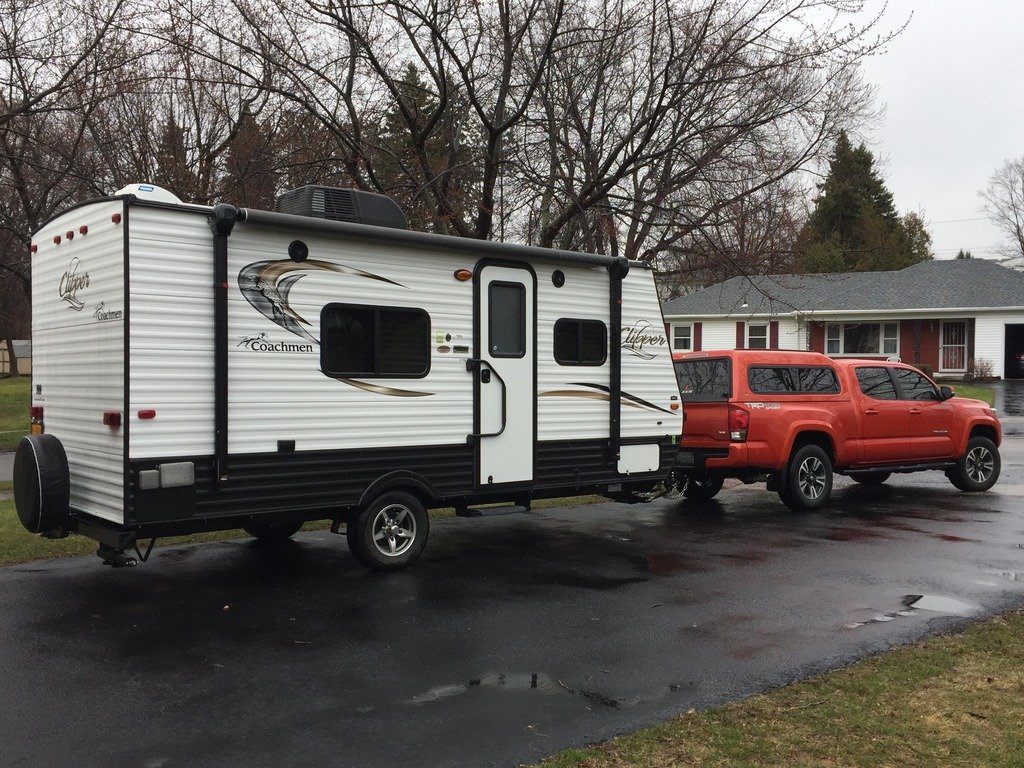

    I pulled our Coachman Clipper 17FQ for the first time last weekend. It pulled GREAT!
    I do use a Weight Distribution Hitch and Sway Bar.

    What hitch and SB did you use? Any issues with the setup?

    My setup is a Reese Round Bar Weight Distribution Hitch with Adjustable Hitch Bar. I also have the Friction Sway Control Bar attached.
    I have only towed it 24 miles home from storage and it towed a lot better than it did with my Toyota Sienna.
