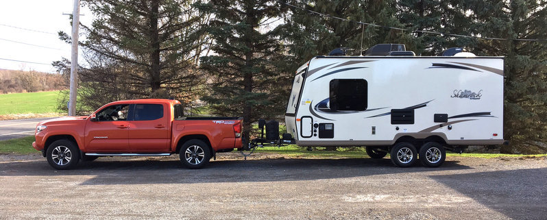

    Greetings. I am new to the boards.
    I wanted to share my towing experience with everyone. Like many of you here I found it a little confusing when trying to make sure I had a good match between my tow vehicle and travel trailer... and of course getting the camper we'd love. I hope this helps in your decision making.
    ABOUT ME
    I am new to towing (and RVing)..... having only have 1 year of towing experience with a 1,600 lb pop-up. So please keep in mind that I am no expert... and don't pretend to be.
    MY TRUCK
    I have a "stock" 2016 Toyota Tacoma Double 4x4 Cab V6 automatic with
    the towing package.
    • 6,400 lbs towing capacity
    • 640 lbs hitch/tongue weight
    MY TRAVEL TRAILER
    2018 Flagstaff Shamrock 19 (which is identical to the Roo 19).
    • Dry Weight is 3,866 lbs.
    • Hitch/Tongue Weight is 340 lbs.
    • GVWR (the unit loaded with the max amount of gear, food, water, etc) is 4,740 lbs
    MY TOWING EQUIPMENT
    • P3 Tekonsha Brake Controller (easily installed myself)
    • Equal-i-zer E2 Weight Distribution System w/ 4 point sway control
    (10,000 lbs gtw, 1,000lb tw). Dealer installed.
    ** I will be adding a Furrion FOS48TA-BL camera
    MY FIRST TOWING EXPERIENCE
    When the dealer brought my new setup out of their garage I thought the proportions of the Shamrock19-to-Tacoma looked appropriate. With the Eqaul-i-zer hitch I thought the setup looked good.
    I purchased the camper in southern Pennsylvania which is 318 miles away from my home in Syracuse, NY.... so I had a long first tow in front of me. The drive was all highway (Interstate 81) with significant amounts of elevation change (from 380 to 1,700 ft) going through the Appalachian Mountains. The drive has many twist and turns and some less than desirable road surface conditions (I'm talking to you Scranton, PA). We also had 10-25 mph variable winds during the drive.
    To make a long story short..... the Tacoma did great. It took me about 30 minutes of drive time before I became very comfortable with the new handling. I was able to easily maintain 65 mph.... and the Tacoma had more when I needed it. I definitely knew I was towing... but I expected that.
    While towing I had the ECT button on and shifted the truck between S4 and S5. S4 for up the steeper elevations and S5 when it flattened out a bit. My RPMs going through the mountains ranged from 2000 rpms to 4500 rpms. The truck liked running at the higher RPMs and actually seemed like it wanted to go faster than I did. Lol.
    I paid the dealer full shot for the hitch plus their install fee which wasn't cheap... but I have to say I am very happy with its performance and happy to pay since the hitch delivered. The dealer also helped me dial in the brake controller which we set at 5. At no time did I feel like the trailer was pushing me during braking or descending steep elevation.
    IN A NUTSHELL:
    • The trip felt safe
    • We easily maintained the speed limits and even had passing power when needed
    • The Tacoma was up to the task
    This trailer was fresh off the dealers lot and therefore dry. I will post an update after a wet camping trip or two to let you know how the Tacoma handled with the extra weight.
    Best wishes for happy camping and towing,
    Butch

    Nice looking TT. Everyone will want to know what your MPG was :p

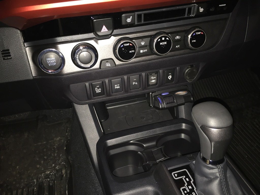

    We just picked up our 2017 TRD OFF ROAD. I want to install a brake controller. Would you mind posting a picture of your installation? Which model Tekonsha di you choose?

    I am using a Primus IQ and mounted it in my charging bay.
