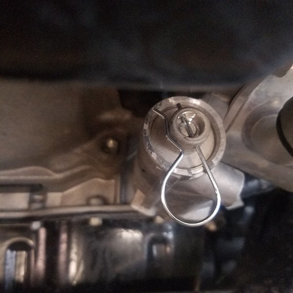

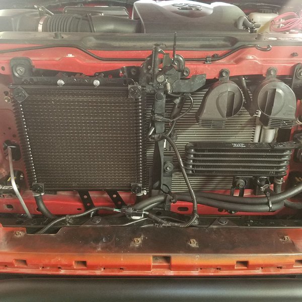

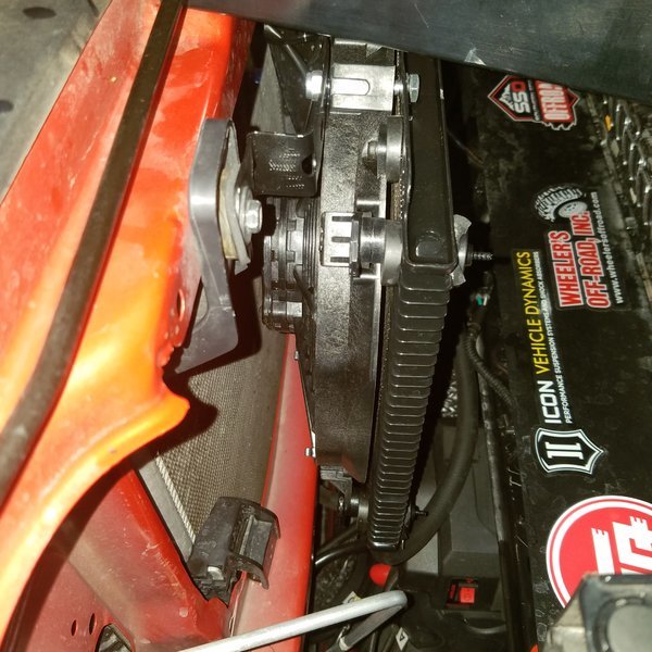

    I run a big Aux cooler and pin my trans thermostat open while towing and my pan temps rarely climb above 180. That's on the big hills towing a 3500lb TT. Super easy to do and keeps things nice and cool!

    I was looking at your post the other day. Gonna copy minus the aux fan :thumbsup:

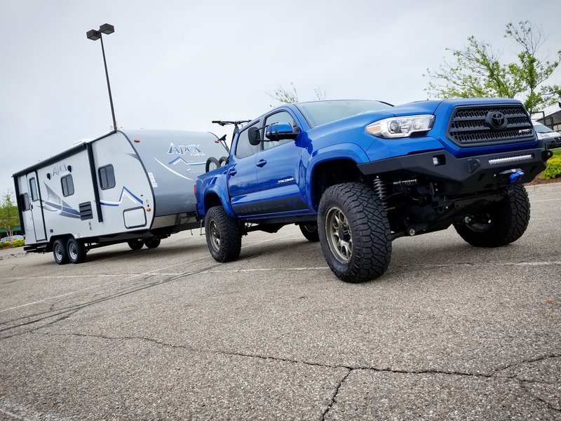

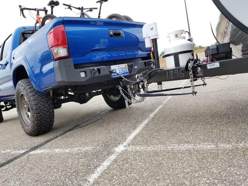

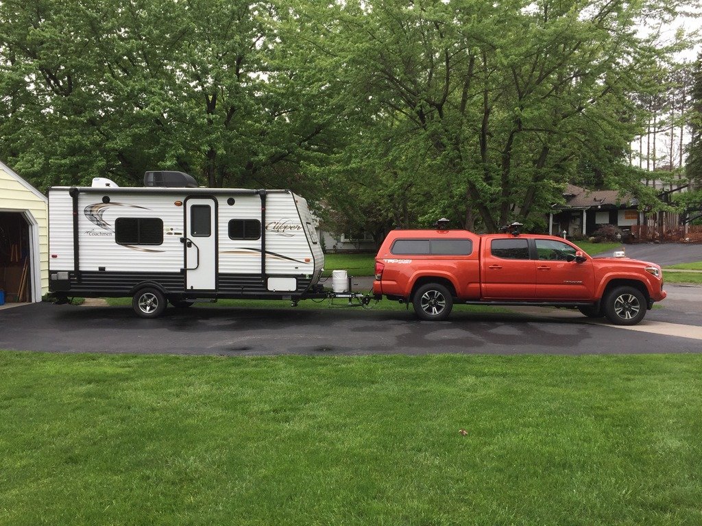

    All ready to head out for the weekend! Fully loaded. Sitting pretty level with the WDH setup.

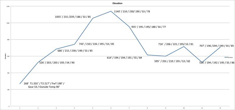

    Not sure if this adds to the transmission temp while towing discussion or not, however, I took the opportunity to record temperature and elevation numbers between my Garmin Trex and the new to me Scanguage. The chart is pretty self explanatory. This trip was over the course of 3-4 hours from Needles California to Las Vegas NV. Towing our 22' trailer fully loaded with supplies. I don't have an actual weight but it is 3800's dry and I suspect 4500-5000 lbs loaded. Two adults in the 17 Taco. 55-65 MPH along the route.
    Might be a more interesting chart come mid July when we go from Vegas to Ely NV through more than a few 5K-7K climbs.

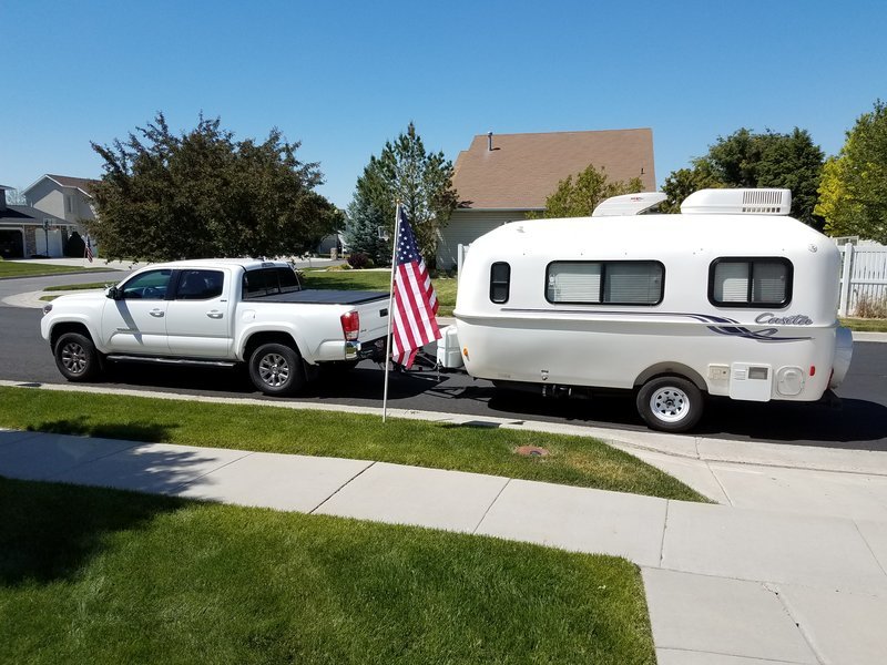

    No problem towing our 2007 Casita 17'SD with our 2017 Tacoma. :)

    Love this pic. The white truck + Casita looks great. Love those things. Gonna get me one some day!

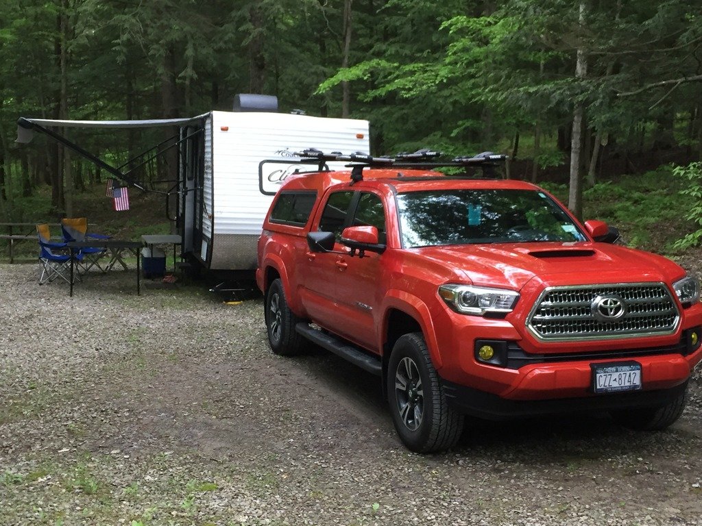

    Here is a picture from last weekend with them attached.

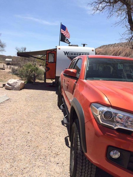

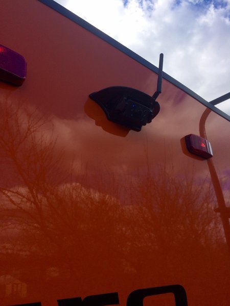

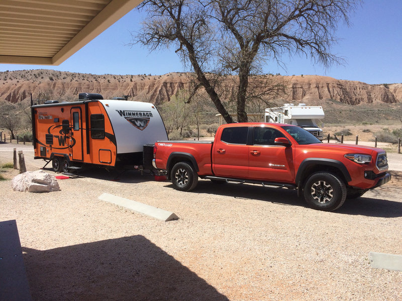

    I bought a set that clip on but never used them. The Furrion rear monitor on the trailer covers the rear and corners well enough on the 22' Micro Minnie so that I can get buy without them.
