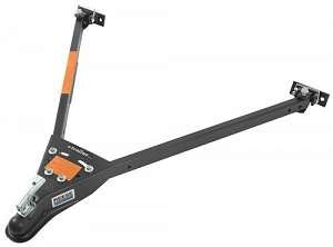

    Good to hear. What kind of setup did you use for that? I've never flat towed.

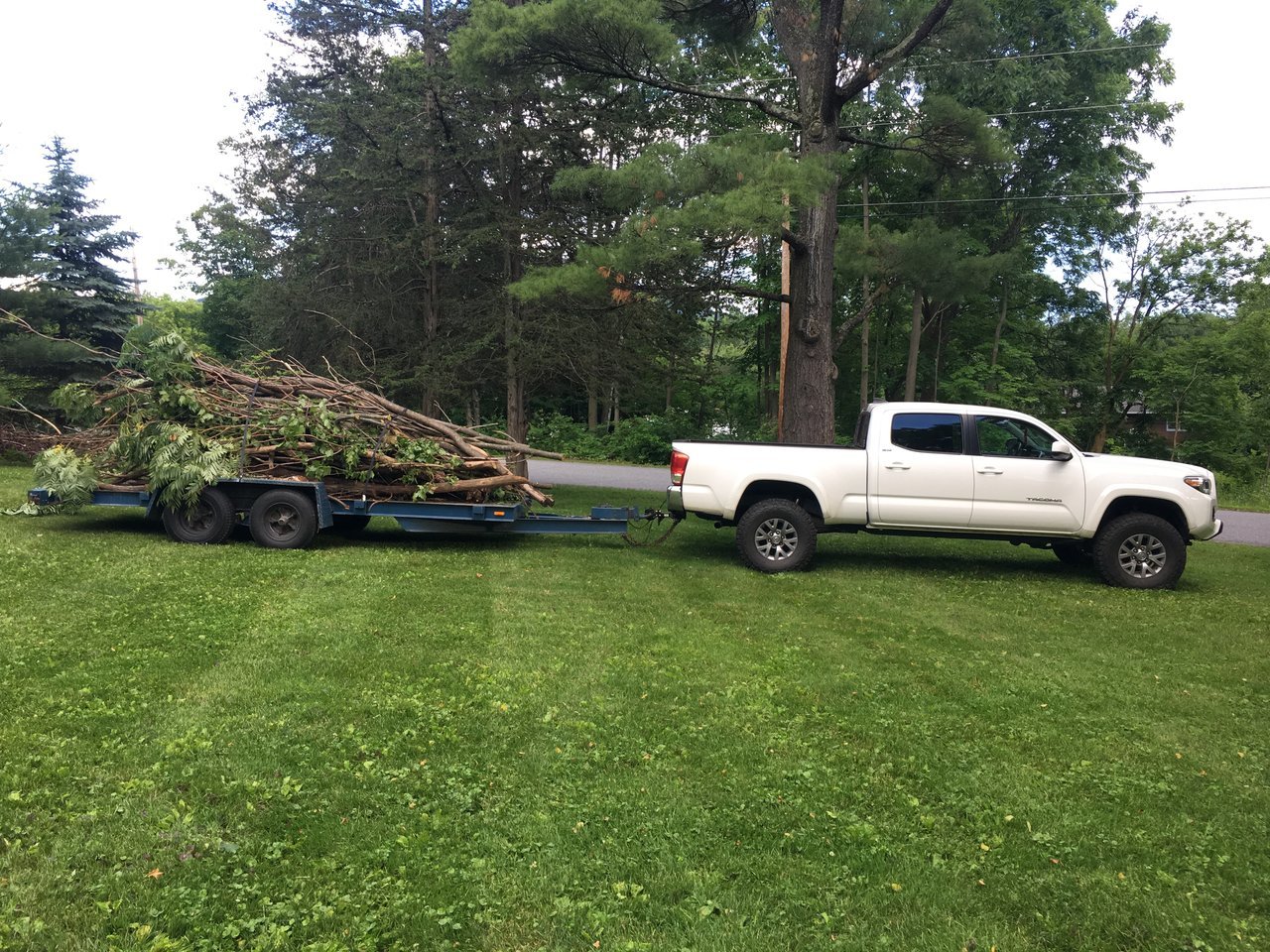

    I have a Reese tow bar rated for 6000lbs. When I built my bumper for my crawler I welded in 2 threaded blocks to the frame plate for it that the mounts bolt to for the tow bar with four 1/2" bolts.EAAFED82-BAEE-4830-9294-A97F91A7C07D-10126-000019295B632B8D.jpg

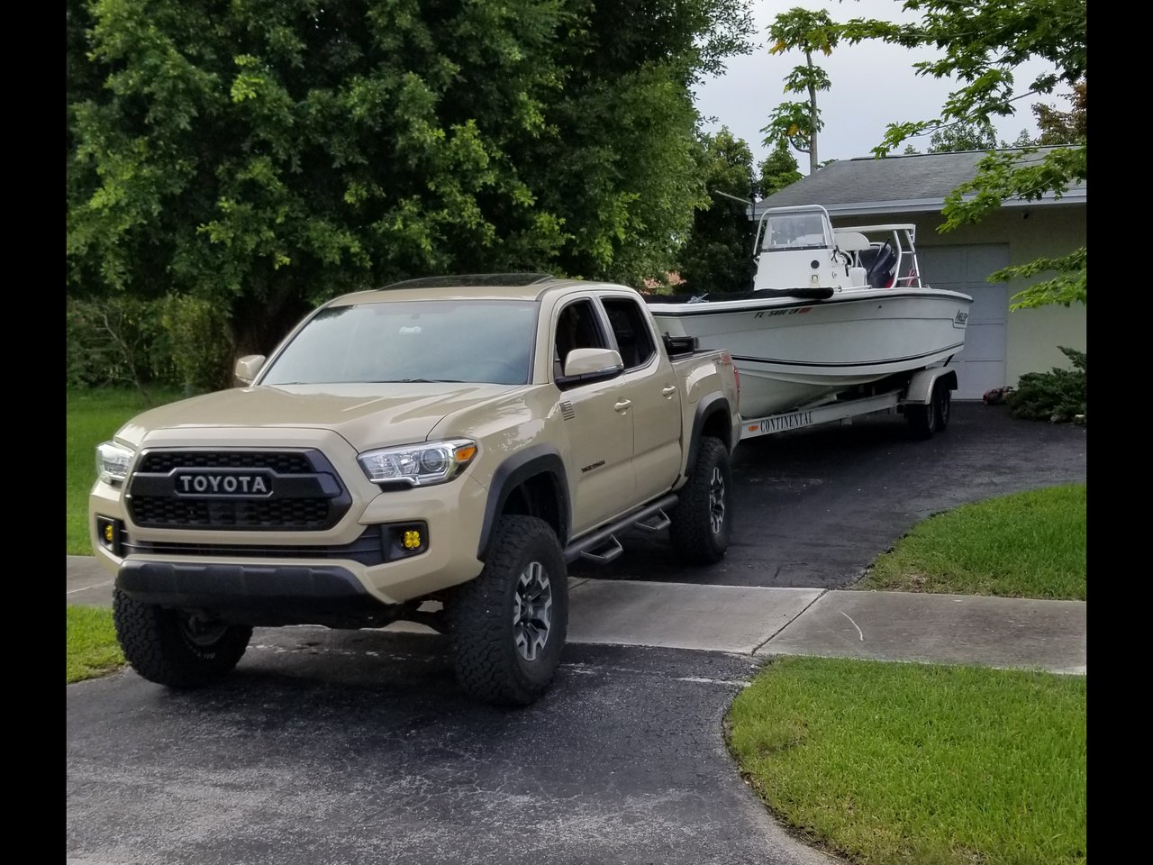

    Your truck looks almost exactly like mine, so needless to say, it looks great :)
    What lift tires? I got OME 887's Front + Dakar Light Duty Rear + Nitrocharger Shocks w/ Falken Wildpeak AT3/W 265/75/r16

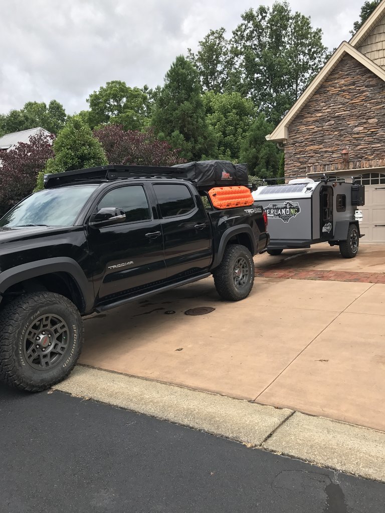

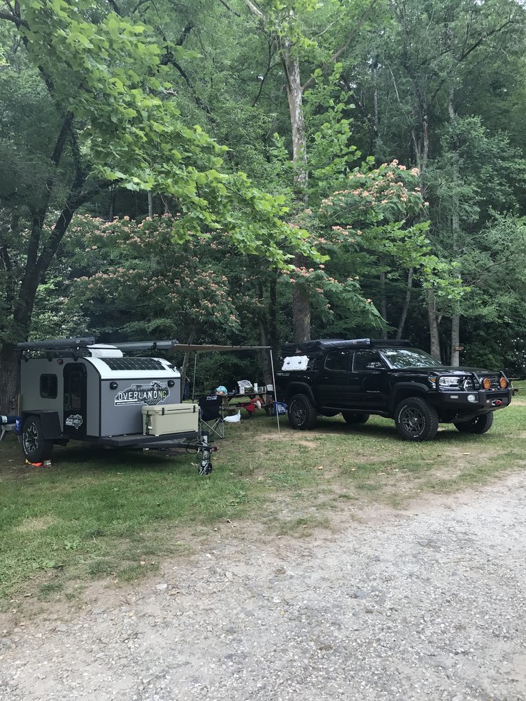

    Fully loaded for family camping the trailer weights around 1800lbs. Truck has 4.88's and I got 14mpg pulling it from Winston Salem (~700') to Great Smoky Mountains National Park (~3,000') at 70mph and it's pretty hilly up there. Running a P3 controller on 10" drums. Pulls amazing for a homebuilt trailer.

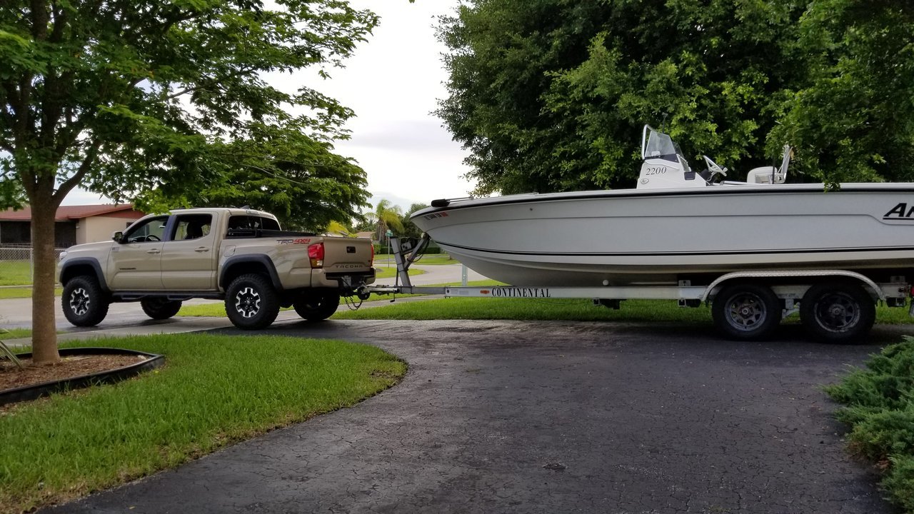

    I almost went with that same set up! I ended up getting toytec boss 2.5 with single AAL. Tires are 285,75,16 ko2s.

    Doesn't look like a home built trailer.

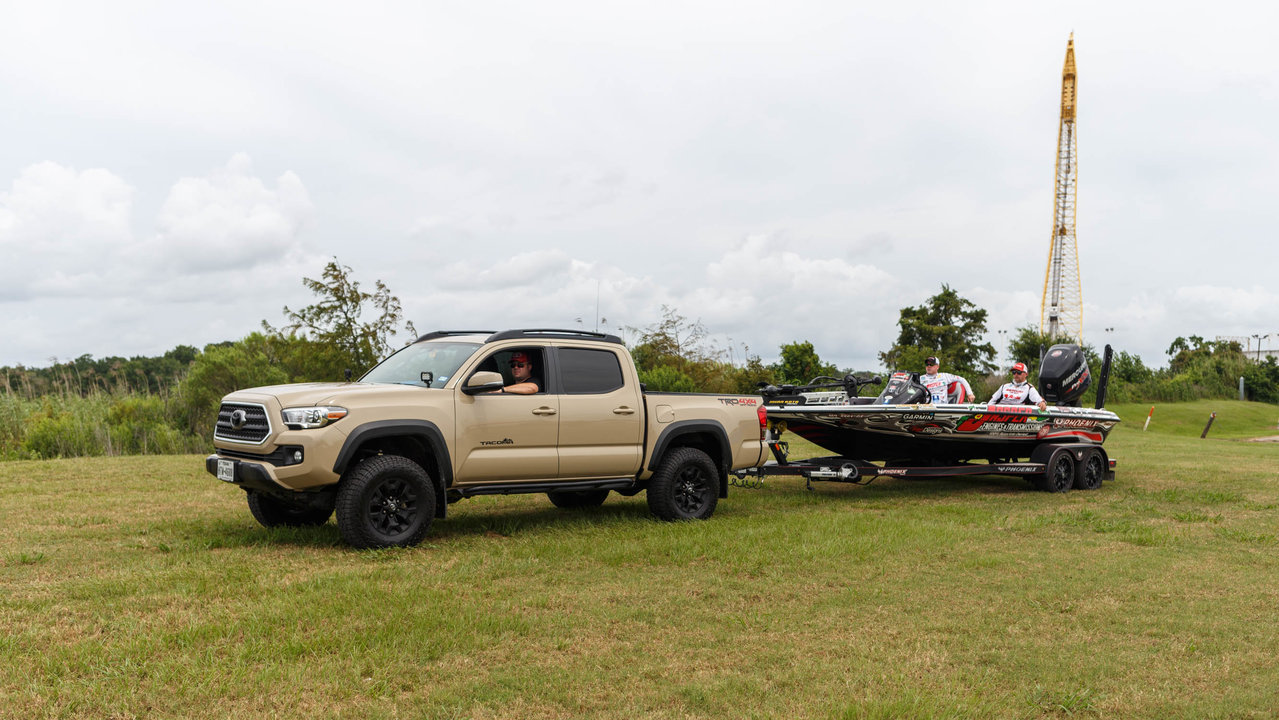

    Here's a pic from a few weekends ago. Not my boat, but my truck. The BASS Masters tournament is Toyota sponsored so they needed Toyota's to pull the boats and anglers in for the final day of weigh in. I don't know how this boat weigh (or cost), but it leveled my truck out with my Dakar leafs (might have squatted it 1/2" to the rear). I'm guessing this setup was 4000lbs - ish?
    Honestly, truck did it fine with ECT mode, but I didn't drive more than a half mile and didn't go faster than 30 MPH. If I made a weekly habit of doing this I'd say it would do it, but a Tundra would no doubt be better. However, I think it would do it fine if you took your time.
    You knew it was back there when you took off.
