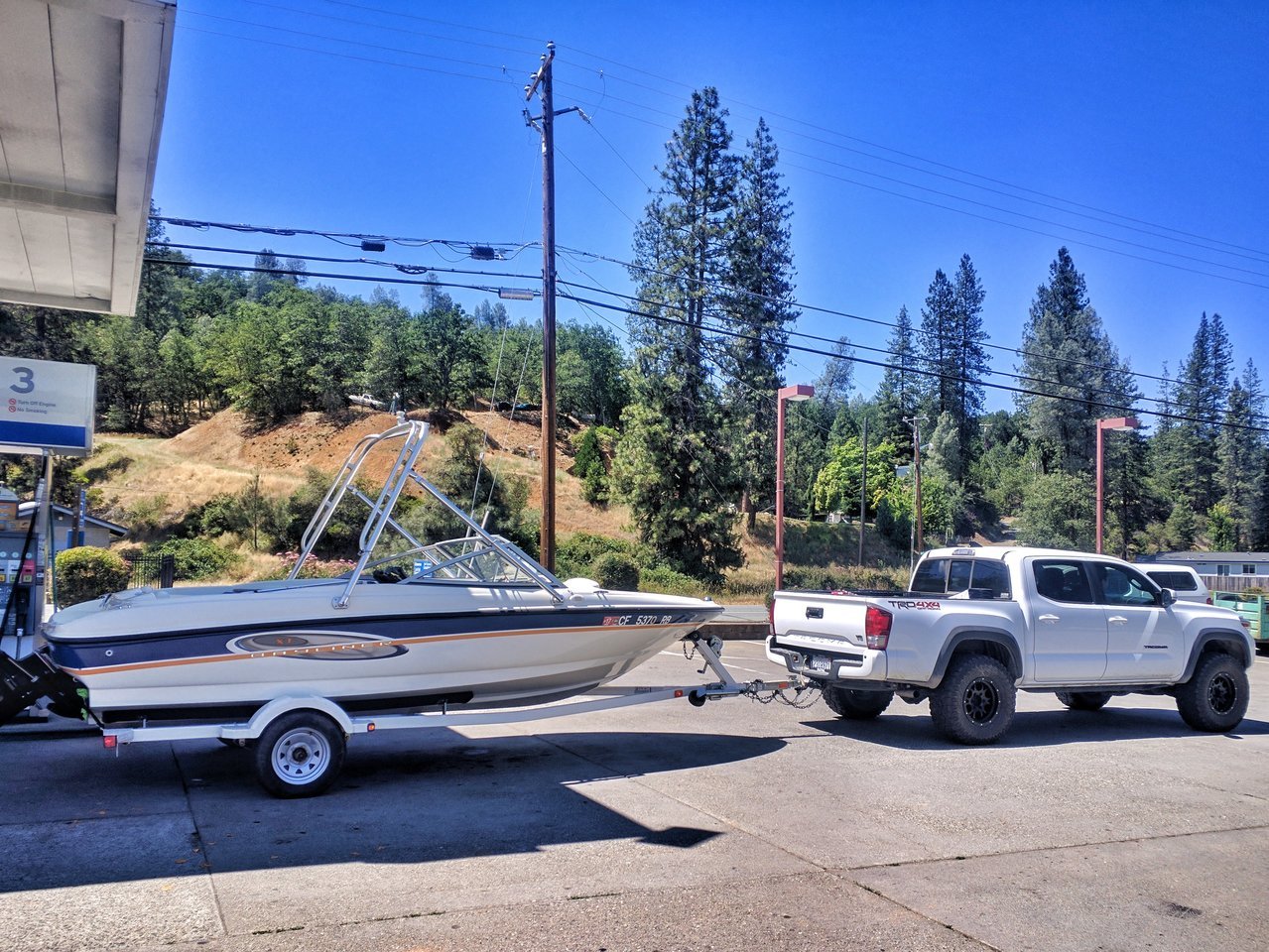

    Truck got a little workout hauling this to the lake last days off.
    SilverII and arnette64 like this.
