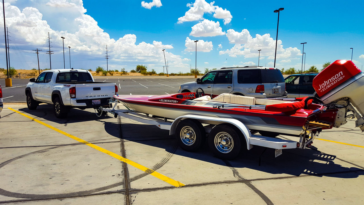

    Towed 300 miles to Lake Havasu. About ~2000 pounds. 17 mpg and did fine up some larger hills. barely could tell she was back there.

    That boat looks like fun :thumbsup:

    it very much is. Bought it as an almost bare hull last year for a birthday present to myself so the fun began well before it even hit the water.

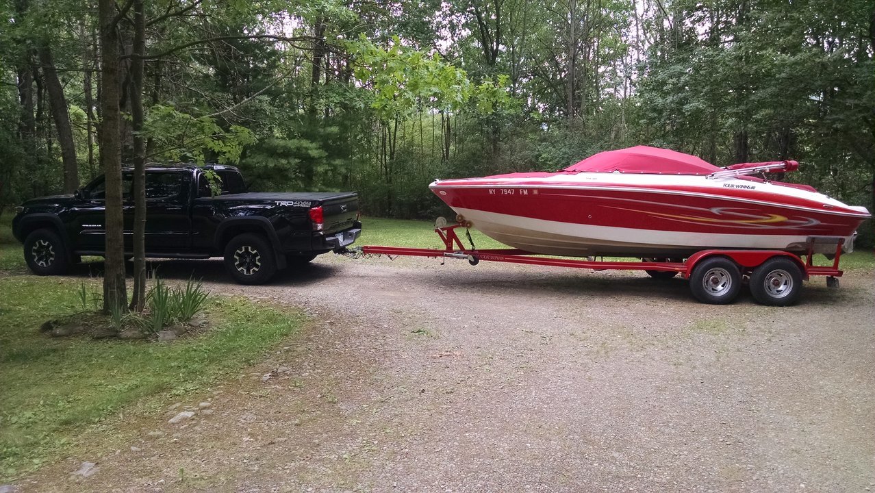

    It looks like the trailer and truck may be too deep or too far back in the ramp. Most ramps have a step or bumper at the end of the pad and is easy to back an empty trailer over the end of the ramp. When the boat weight is on the trailer a dual axle trailer is very difficult to pull over the step or end of ramp.
    I have no problems pulling my approx. 4200 lbs boat/trailer out of the water and do not use 4wd. ECT and S3 or S4 in my TRD Off Road DCLB automatic trans. has worked smoothly on a slippery ramp.

    Thanks for the pic. This is similar size and weight of the boat i towed. Im an experienced manual drive for over 15 years and i tried feathering the throttle and clutch as well has mashing the gas and reving til 4k to force it out of the ditch with no success.... Clutch smell and all. the only time i really had 4 wheel slip was on 4L. i think I toasted my clutch when we called it quits. I felt the empty trailer sort of jolts out of the water when i finally got it out which led me to believe that both back tire of the trailer and boat was off the ramp. Lesson learned...
