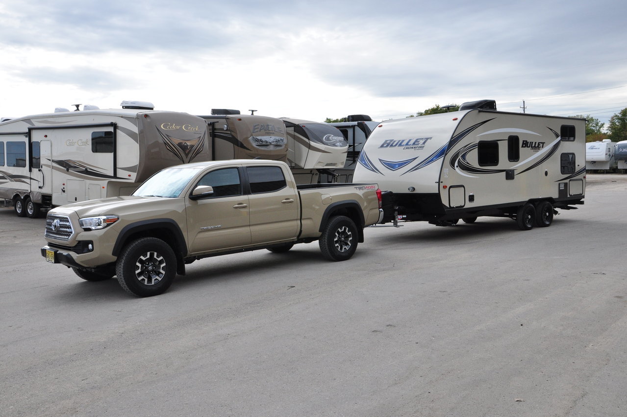

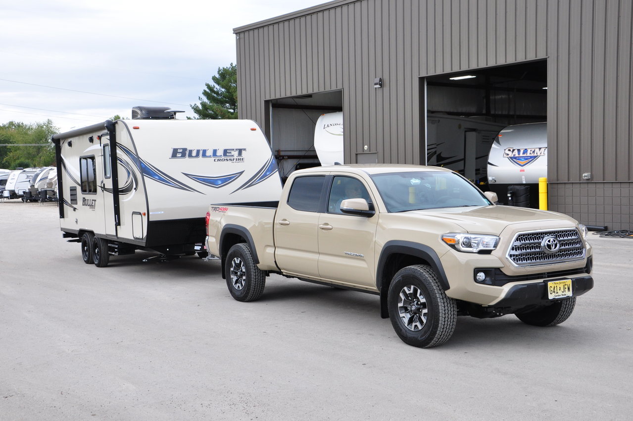

    we tow a travel trailer with our 2017 tacoma trd offroad.. it weighs 3750 pounds empty.. probably around 4000 loaded.. using a weight dist and anti sway hitch with it.. towed the trailer 700 miles home from grand rapids to south jersey.
    truck has plenty of power towing it across PA on rt 80 and those hills.. damn thing was wound up at about 4000 rpm most of the way which i didn't like so much. guess it needs to be up in the RPM's because of the lack of low end TQ it has.. . according to the trucks computer it was only getting 8mpg which kinda sucks especially with such a small gas tank.. needs a 35 gallon tank in it..:). no sway but is a little bouncy at times...
    took it to Lancaster a few weeks ago and it was quite windy out.. still towed nice.. gusts of wind got me a couple times but it towed straight and steady with no issues.. still only got 8 mpg.. truck only has 2000 miles on it though.. not sure if it will improve any with more miles on it..
    my question is why a truck with a factory tow package doesn't come with any type of tow mirrors... i had to buy those stupid strap on tow mirrors...
    may step up to a tundra down the road..

    Any idea what your tongue weight is? I tow a 16ft open car trailer with my racecar on it and I estimate the total weight to be around 4000lbs. I am trying to decide if I should do a weight distribution hitch and some sort of helper spring or just the weight distribution hitch alone.
    It looks like your truck is staying nice and level.

    @iamthewheelman in those pics the trailer is empty so the book says its about 420 pounds. it has a weight distribution/ anti sway hitch on it.. i have no helper springs at all.. though air bags may help bounce some.. like stated though you can control tongue wight with a car trailer by moving the car forward or backwards on the trailer...

    Thanks for the help. I load the car as far back as I can on the trailer right now, so if the tongue weight is over 450lbs I will have to figure something out as I researched that 10% of total trailer weight is a good number to shoot for. I really should measure my tongue weight as it would be invaluable info to have so I am not just assuming numbers.
    Great, thank you! What WD hitch did you go with?

    Husky Center Line Weight Distribution w/ Sway Control
