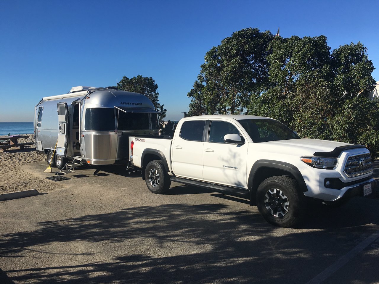

    Yes, I'm on the airstream forum.
    I have an Equal-i-zer hitch, setup by the dealer. Tekonsha brake controller.

    Nice AirStream! How much tongue weight on that size?

    Just picked this up Friday evening. 2995 lbs. dry, truck did great on the way home from Camping World.

    640.

    Exactly my trucks hitch capacity and as I believe you mentioned the 23FB is a bit less.

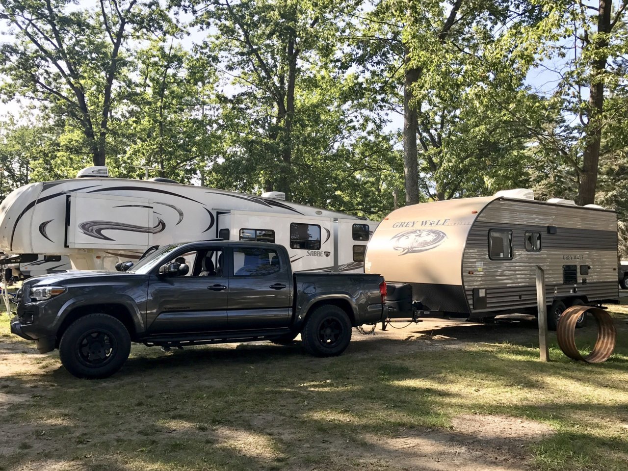

    Looking for some insight here, as I'm reading a lot of your guys posts that are towing a trailer heavier than mine, with what sounds like better results than what I get. Does my situation sound abnormal? Maybe too much or too little tongue weight? Do I sell it and buy a F150 ecoboost? Halp!
    When towing in S4 with ECT on at 65-70mph the truck has to downshift to 3rd on any kind of incline to maintain speed. This makes the truck scream around 4,300rpm. Only in damn near perfect conditions can it maintain speed in 4th gear. I've tried just D with ECT on and it would not upshift past 3 gear unless going downhill or take my foot completely off the gas. Cruise control is absolutely pointless as it either gets stuck in 3rd gear or it constantly shifts from 4th to 3rd to maintain speed.
    Vehicle: 2017 Tacoma TRD Sport - stock except for Rotiform SIX-OR wheels and Toyo Open Country tires
    Trailer: Grey Wolf 17BHSE - trailer dry weight 3,900lbs, loaded estimated 4,300lbs. Hitch weight of 480lbs
    Hitch: WDH hitch with bars, trailer is level.

    Your tires are inflated at what pressure (PSI) ? It make a HUGE difference
    I put mine at 50 psi (truck and trailer) when towing heavy load

    Truck tires I believe 34psi (per the “book”). Don’t recall the trailer tires but they have nitrogen and a valve stem cap that shows color if they’re good or bad pressure.

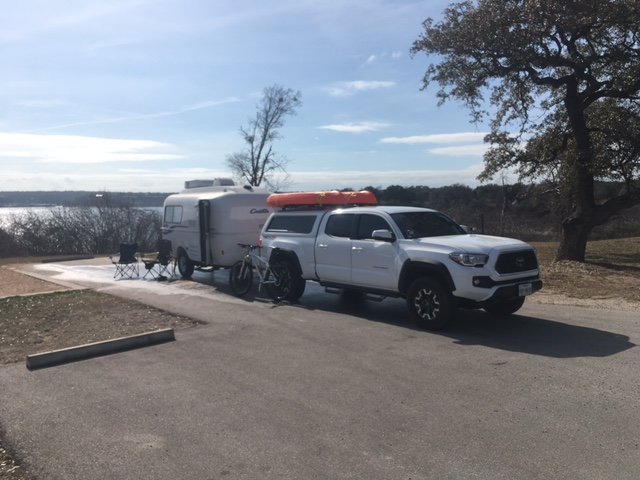

    image.jpg image.jpg I pull a 17' Casita with my 2018 trd off-road long bed. I use a FastWay hitch which has double sway bars . The Casita weights about 2,500lbs. With about 400 tongue weight. It pulls it great.

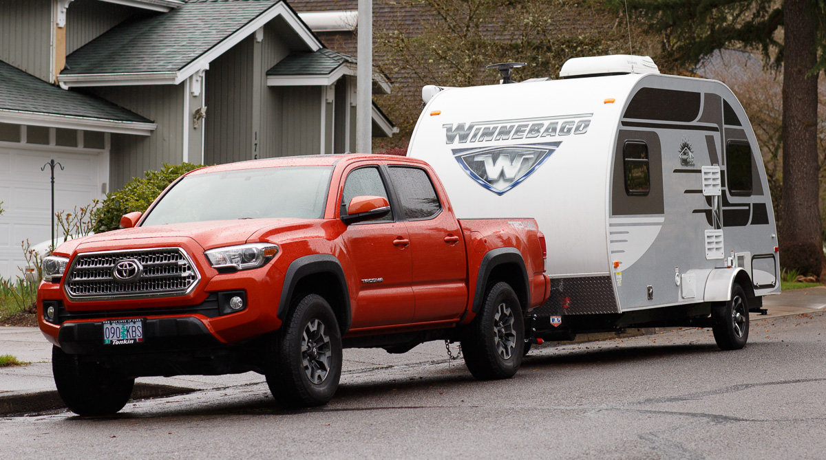

    2016, V6 6-spd Manual with tow package. Trailer is a Winnebago Winnie Drop 1710 (18', 2400 lb dry weight), Anderson hitch. She tows purdy nice :)
    But we've decided that the trailer is too small. We get our Winnebago Micro Minnie 2106DS (22', 3700 lb dry weight, tandem axle) in a couple weeks.
    thomas3ford likes this.
