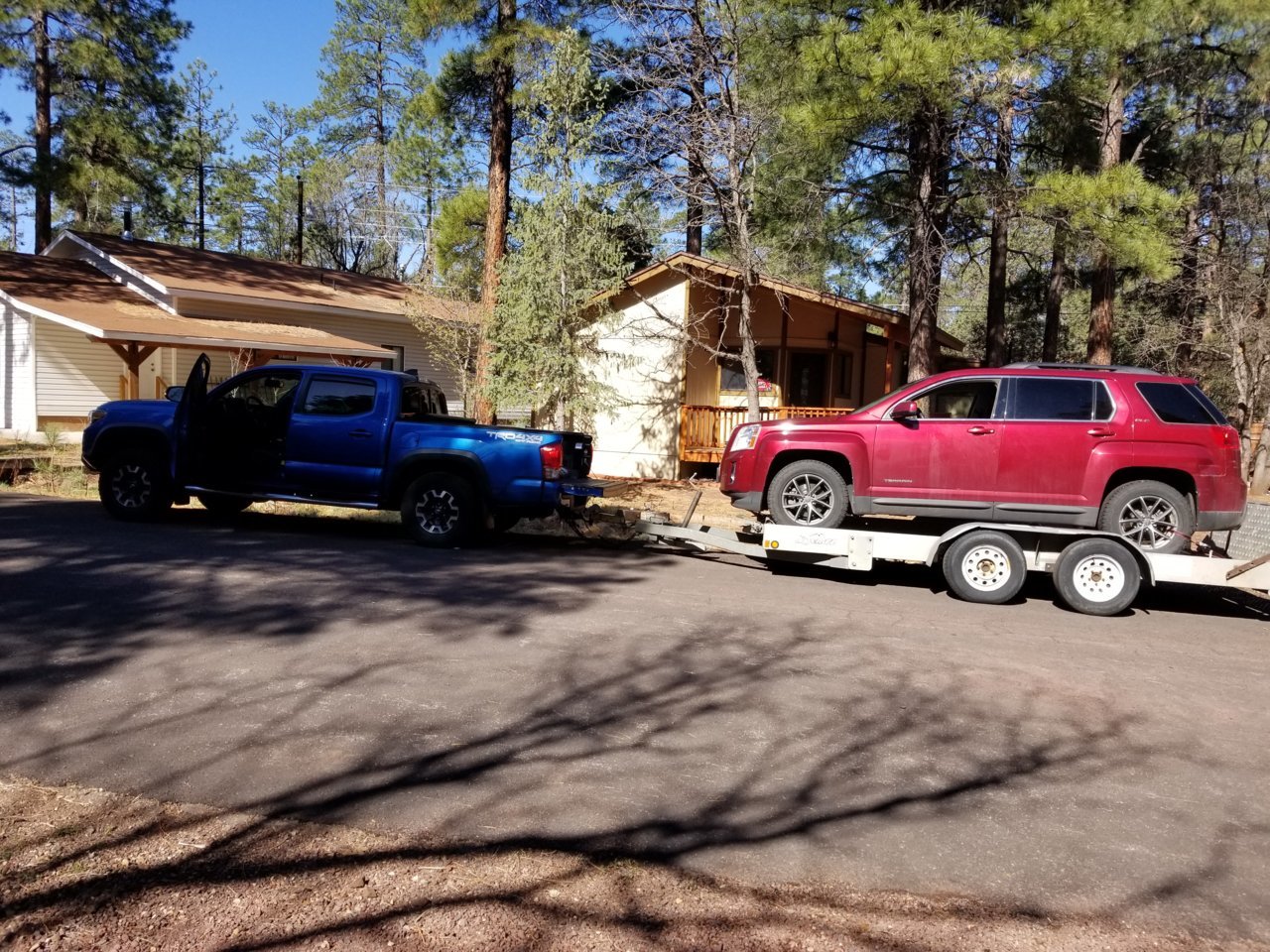

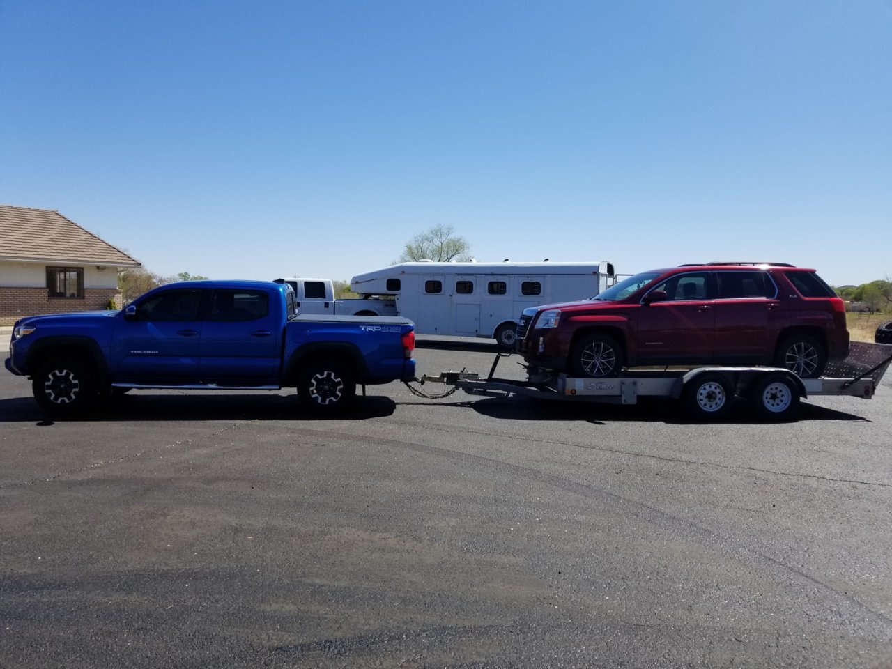

    A week or so ago I towed a 2011 AWD GMC Terrain from Pine top-Lakeside AZ back to Denver CO. 1700 miles round trip in 34 hours. I drove to AZ with an empty flatbed car dolly and then back with the car. There I managed uphill 4th gear and 3rd to accelerate uphill. The truck did ok with the trailer but it wasn't until i loaded the car that the Taco shined. With the empty trailer I averaged about 14mpg doing 75 mph with cruise control on all the way and with the trailer laden I averaged 13.2mpg and staying well with in 65-75 mph without cruise control.
    I believe the weight distribution was 100% as my truck pulled the weight around and not the load on the back throwing the truck all over. it was waaaay easier heading back than it was going there.
    At one point a newer silverado came by me with a golf bag and a cooler that was about to blow off, and I thought I would pull up next to him and wave him down. I was un aware of the speed but at some point I knew I was not going to catch him and upon looking down (as I am taking my foot off the pedal) I was doing 100mph, no sweat. I know i know, please dont tell me how unsafe that was, i know. I dont go that fast. But it was nice seeing the truck being capable of that.
    The truck really amazed me....
    The first Pic is AFTER I repositioned the car. The second was right before I decided to move it back 6 inches.
    It was unloading this car that ultimately broke my arm and my wrist. lol
