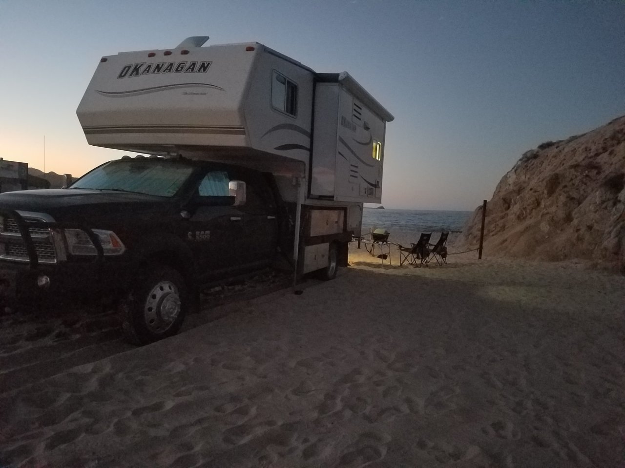

    I tow the X30 with mine.... really not a lot of fun over 55ish. In town tows, it’s totally fine. Not going anywhere quickly though. But since I know you have that badass 5500, you won’t need it for that anyways.
    That being said I will be trading back into an F250.
    (Mines an auto and I haven’t had a single complaint with it)

    Thanks folks. That's some good news right there.
    In case you're wondering, my Ram is a pain in the arse when it comes to tight quarters (parking lots other than a Wal-Hell, boat ramps, Baja, etc.). A Taco would provide a welcomed addition (sometimes I just want to splash the waverunner). Anyway, thanks again for all the feedback.
