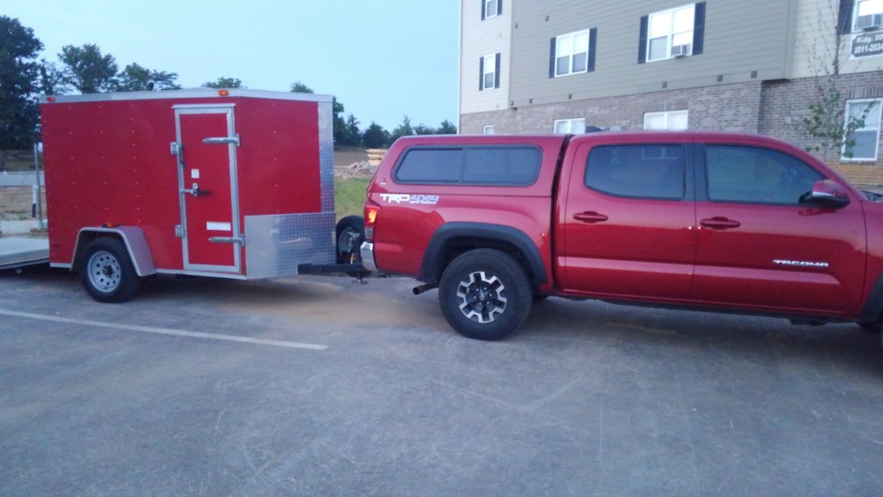

    Pulled my 5x8 cargo trailer from the St Louis area to North little rock and back. 13.9mpg empty using cc and maintaining 65-70mph ect on, s4. 16mpg returning not using cc and staying 60-65mph ect on and s5, little downshifting with about 2400lbs total behind me. Can't complain about that.

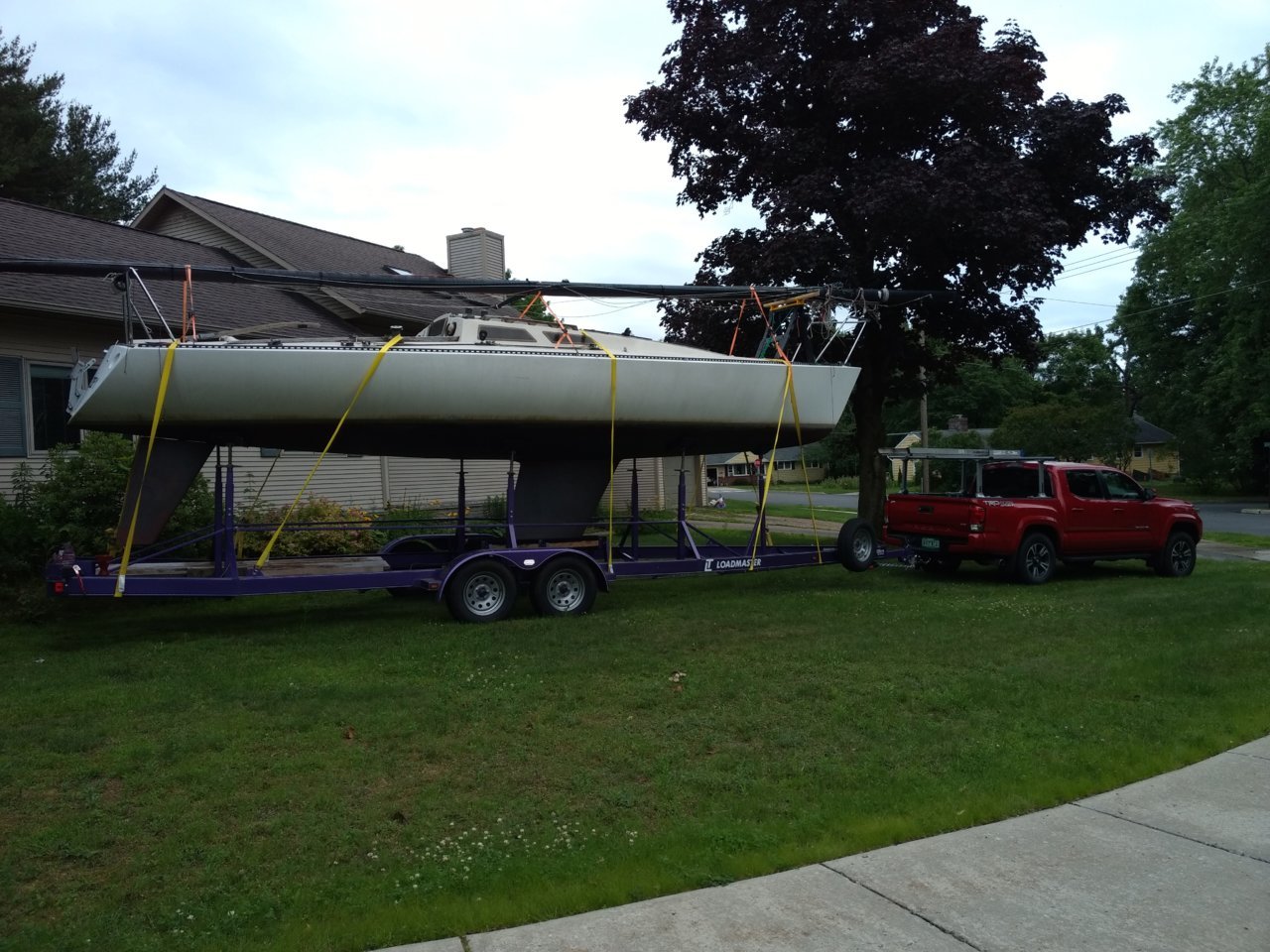

    It is less than 10 miles from our house to the lake where we launch the boat. Boat plus trailer are about 6000 lbs. Yes it towed easier with our 2011 f150 Ecoboost, but I prefer the taco for Everything else. The truck was working hard, but it was only 10 miles, Andersen WDH, trailer brakes. The best part of a sailboat on a trailer that draws 5 feet is no towing mirrors required.

    Do you not have to use a crane to launch that? Also if it’s surge brakes you shouldn’t use an WDH

    Yes local boat club has 2 ton hoist. 4 wheel electric brakes. I don't think that float launching an Olson 30 is going to work veey well at any ramps on Lake Champlain.

    I literally just float launched my parents 27 foot sailboat about 15 minutes ago. Winged keel FTW

    Does it draw 63"? I would need 7ish ft of water to float launch and the hoist is free, just don't monopolize it on race night.

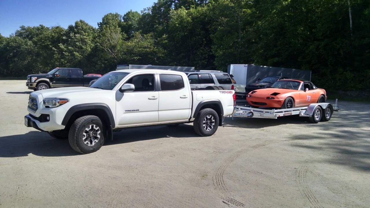

    I might as well contribute since I upgraded from my old 4 cylinder 2nd gen to the third gen so I had something that towed the race car more comfortably. I'm typically hauling around 3,300lbs gross trailer weight with the camping gear (not that heavy), tools (heavy), and wife (heavier than a few years ago) about a dozen times a year. Hauling this load (and occasionally a motorcycle in the bed too) around New England I average between 14-16mpg depending how hilly things get. The truck handles it great with no issues, even when having to brake suddenly or traveling down steep hills. I also have plenty of power with the 3.5/6-speed manual combo. I have also pulled much heavier cars with the truck lightly loaded and it has still performed excellent.
    Here it is with the race car:IMG_20180610_164318993_HDR.jpg

    What kind of trailer is your car hauler?

    It's an Aluma 7816, really high quality and very light. Only 1150lbs empty.
