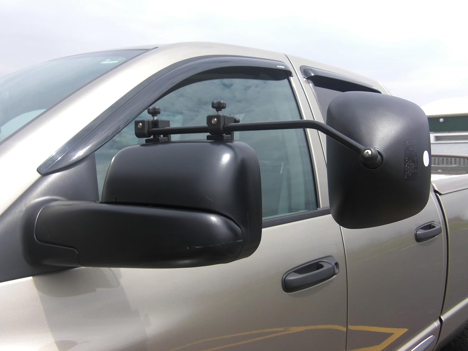

    I use Milenco Grand Aero Mirrors; They attach solid and don't shake.

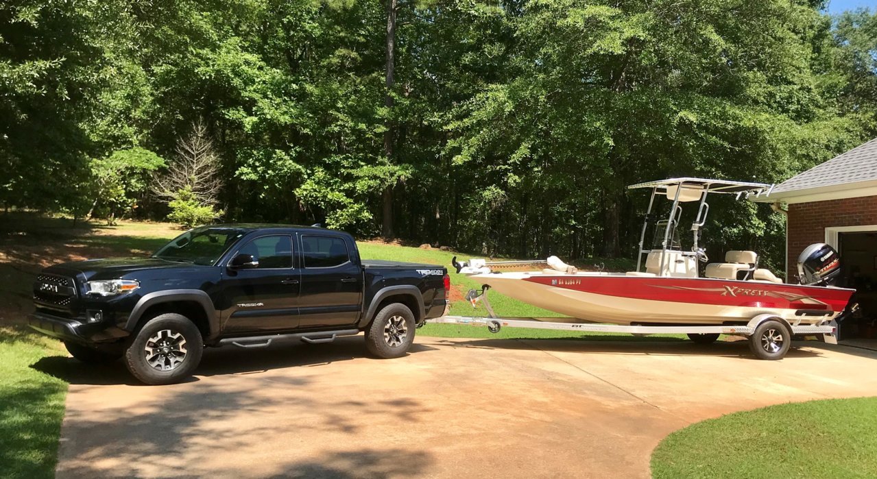

    I pull a 20 foot Bay Boat with my 2016 TRD OR. At first it seemed to struggle searching for the right gear to be in. Now I put the transmission into Sport Mode 5th gear, and leave it there. Pulls like a dream, no sway, no searching. MPG pulling the boat is usually between 14-16, not too shabby IMO.

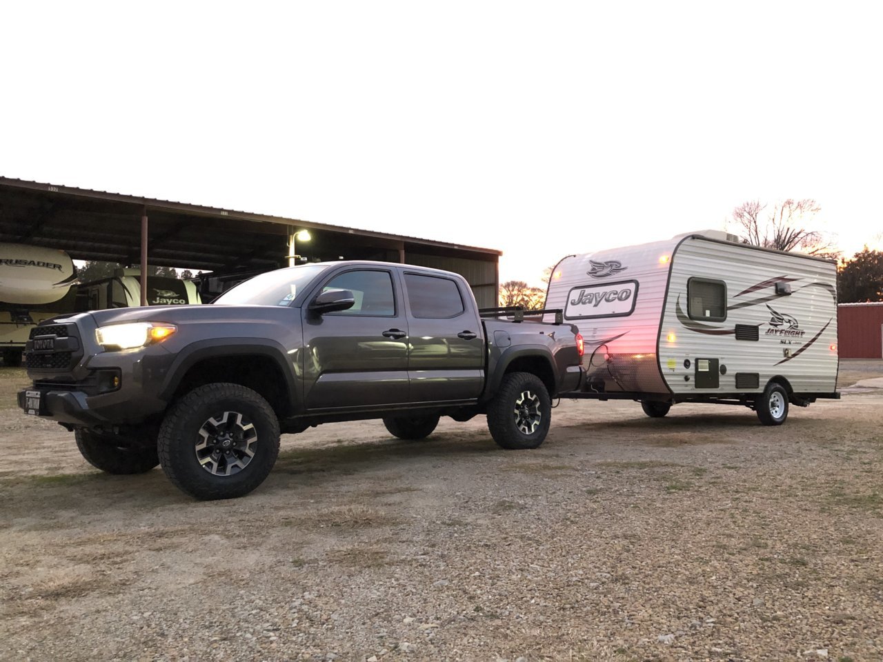

    We pull a little Jayco RB145. It pulls well, and I’ve got Dakars out back to overcome any excess squat.

    We have the same trailer, just the Baja version. My 3rd Gen 4Runner wasn't happy towing it on 33s, but did it anyways. Good to confirm it should be a breeze with the Tacoma.
    Great little trailers.

    That’s about the size of the camper I have. Jayco kiwi. Definitely squats a little with it attached. Thanks for the advice. Might have to invest in some Dakar’s.
