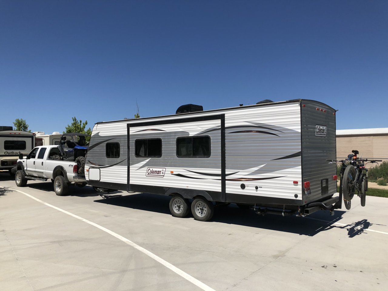

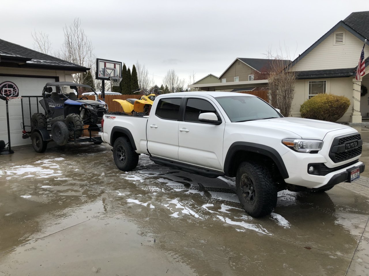

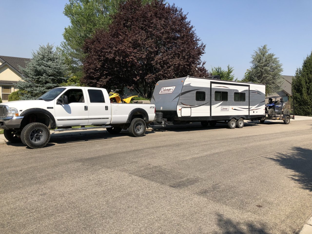

    Just curious if you’ve towed much before and if so, what was your previous tow vehicle? I haven’t towed much with this truck as it’s not it’s main purpose for me. It tows like most naturally aspirated gas motors (non ecoboost). It revs to 4000 on most mountain passes, sometimes dropping to second on steep passes at 5000 plus. I found using ect and sport mode to better limit the top gear worked best for me, otherwise the truck would try to upshift too early. It did fine towing this load but only was around 12mpg. Not too bad really. What I’m trying to get at, is towing well can be in the eyes of the driver.
    Here’s what the Tacoma towed and also what I tow with my big truck.
    And for the big load, the v10 gets it done but not near as well as the Powerstroke did.

    From where I’m sitting, that Ford to trailer ratio looks way more appropriate than some of the photos I’ve seen on this thread of Tacos pulling similar or even bigger loads. It’s fun to see what these Tacos can do, I just prefer not to push the limits.

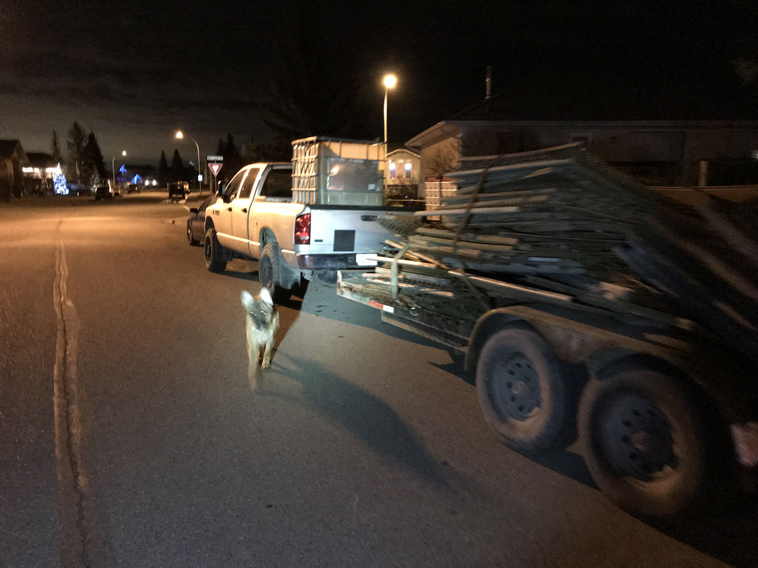

    2020 Cement OR DCSB V6 6MT 4x4 Prem+AdvTech+LED
    You can tow double trailer without a fifth wheel? Which state are you in?

    Yes. In Idaho. Legal in Utah as well. I don’t travel over 75 miles usually with that setup and usually at 55 mph or less with a few miles at 65.
    If I were going farther I’d take the side by side or the kids 4 wheelers.
