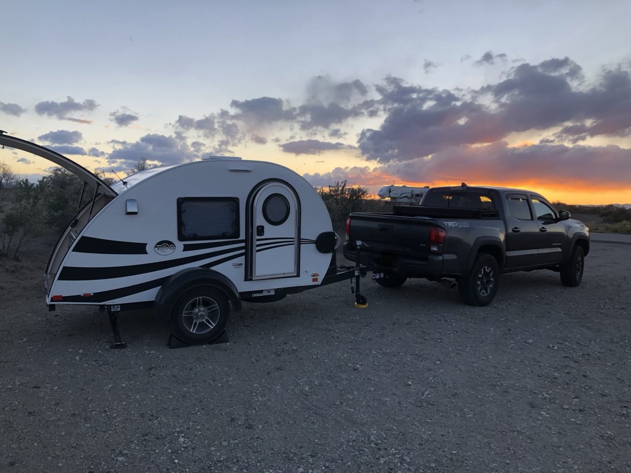

    Sorry if this has been answered before, but I was surprised last minute with a teardrop rental (nuCamp t@g) to spend the next week camping in Utah and Colorado. I have a 2018 OR with towing package and manual tranny. I’ve never towed anything before, my question is, do I need a brake controller for this trip? I’m reading this teardrop is about 1000 (but perhaps 1300 with all the bells and whistles) lbs with electric brakes. Not sure if I’ll be able to snag some kind of a wireless break controller beforehand since I’m supposed to leave in a few hours on this voyage. Any help or tips is greatly appreciated. Thank you!!!

    With as little weight as it is you may not need it. Maybe some of those downhills I would recommend to help stop easier. Getting one installed is not a bad idea.

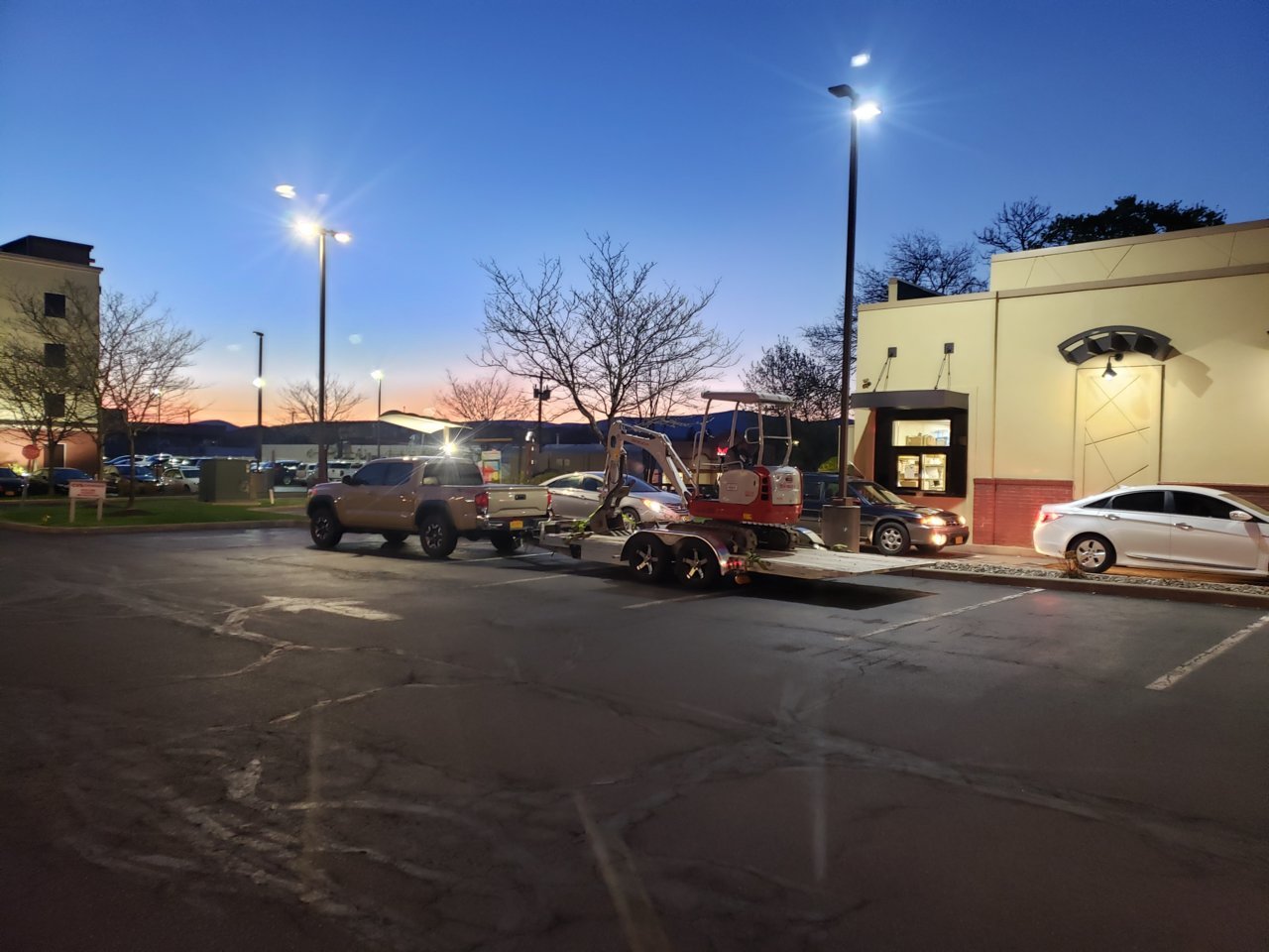

    New excavator.

    Installed brake controller but it never registered as having anything connected. Worked out fine, but would’ve been nice to have especially over the summits.

    This showed a specific indication (per the manual) on the display that it didn’t register as having anything connected.

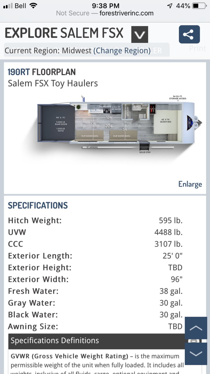

    Yikes, that's a big girl. I assume 19 foot body and 25 foot total length? At 4500 pounds dry, you will soon be pushing the 6400-6800 max tow weight of the truck when loading water, food, gear, and bikes.
    I suggest looking into a custom toy hauler from Dune Sport before anything. They are usually cheaper than pre-made small toy haulers depending on what options you want.
