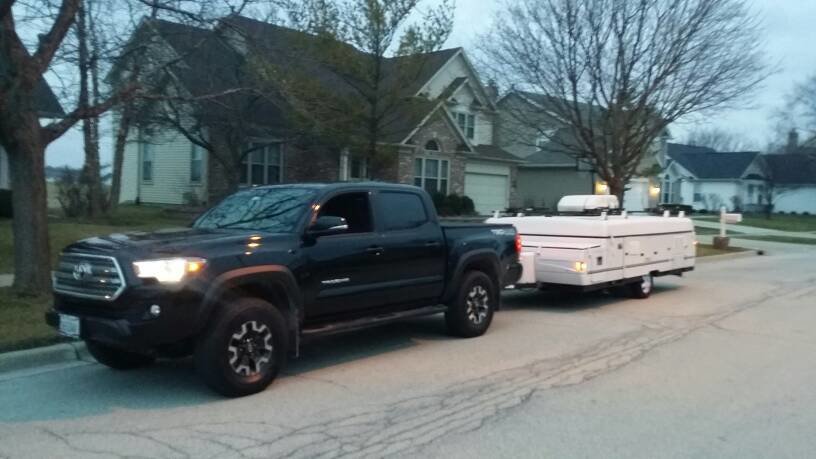

    I pulled this tonight with no issues at all.
