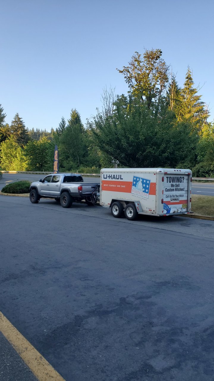

    Towed a uhaul enclosed full of moving stuff the other month, pretty funny to be body rolling around corners while towing. This was before I added another trans cooler/pinned the trans tstat, and it did not like me floored up hills with 35s :rofl: Towed pretty good otherwise.

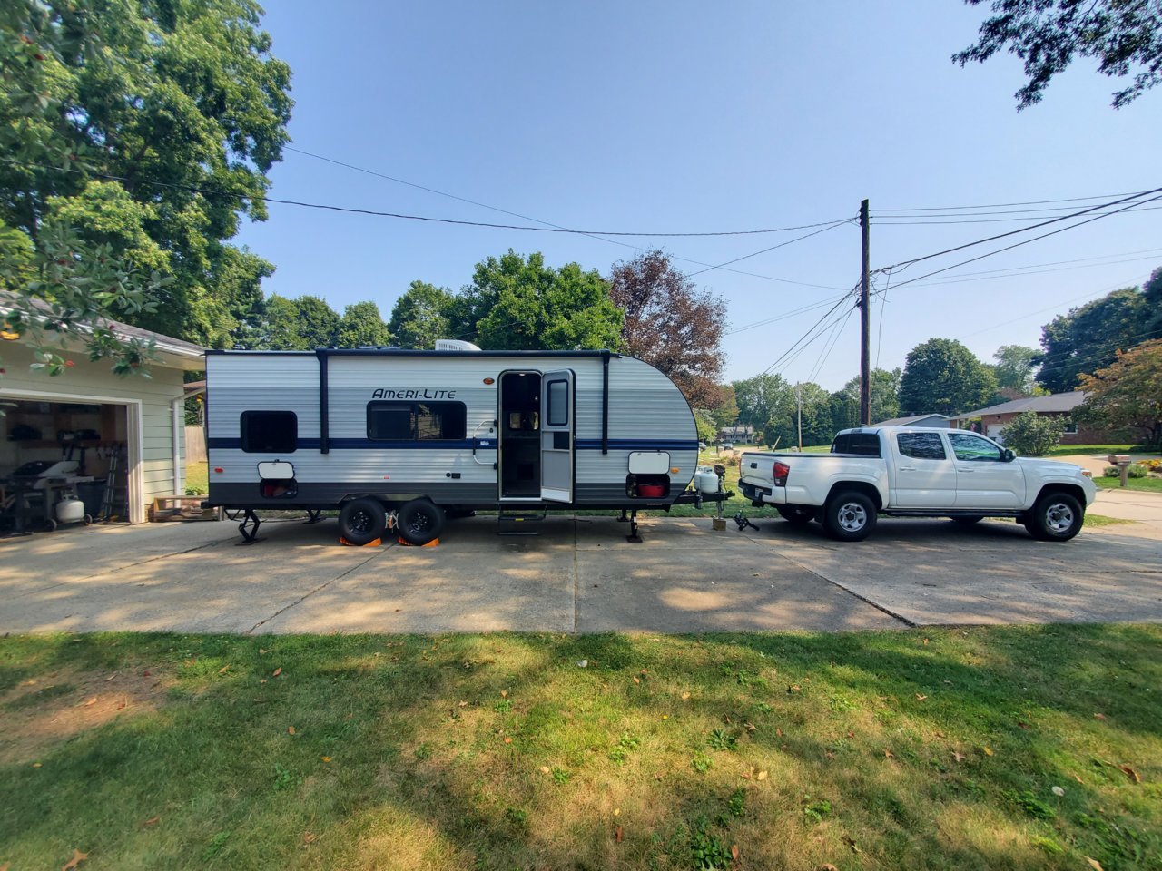

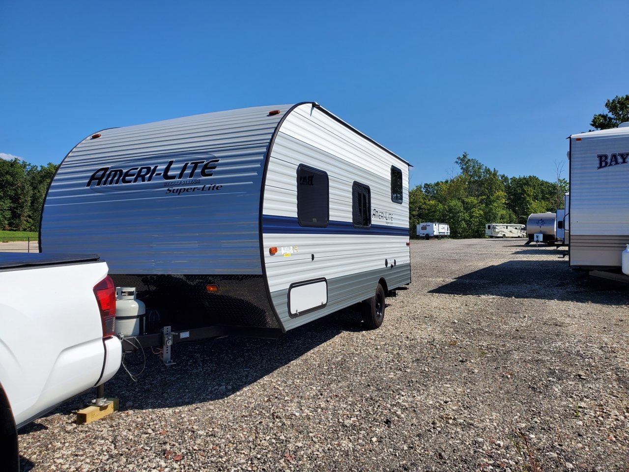

    I was towing a 2021 Gulfstream Ameri-Lite 199DD. Last time I had it weighed with all my stuff I was at 3720. Total GCWR 9220. So about 2k under max. But just traded that for a 2022 Ameri-Lite 248BH with a dry weight of 4200 but it has tandem axles. Figure we add 500 max but length will be 27' vs my 21'. The Tacoma handles it well...actually more than pleased. The only mods I've done is Timbren helper springs and Cooper RTX 265/75R16 tires with a higher load rating. And the hitch is a Husky Centerline 600/6000.

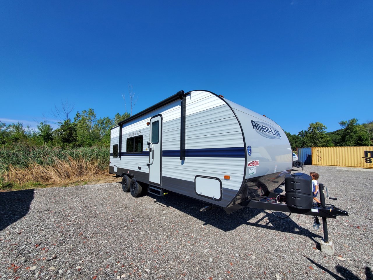

    First trip out with the newer...longer...heavier camper. I estimate I'm probably around 4800 lbs...27' long. No sag when hooked up. It was a good weekend to test as it was pretty windy. Have to say it for sure tows better than the lighter, shorter single axle I had before. I was a bit unsure but after this weekend I have no regrets at all. Obviously acceleration is slower but I'm merging onto the highway just about as fast as anyone else and I hit 70 a few times to check stability. All good...but trying to keep it no more than 65 because the tires are rated to mid 70s.
