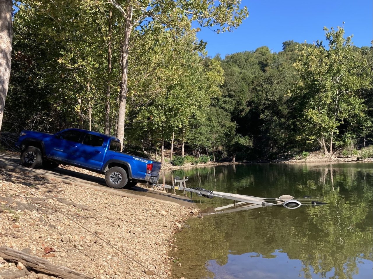

    Couldn't get the MT into 1st gear on the ramp to pull the 19' ~3500 boat+trailer out of Table Rock Lake. I had to drop it into 4Lo. The ramp had three sharp S-curves and the only way out was keeping it in 4Lo for ~250 yards. I made the turns as gradually as possible, and nothing bad happened with the drivetrain.
    So what exactly are the risks and limits of 4Lo on pavement when towing up steep ramps and then backing the boat up my steep(ish) driveway?
    Unfortunately the 3rd Gen 6MT lacks a plug-n-play 2Lo mod like 2nd Gens :_(

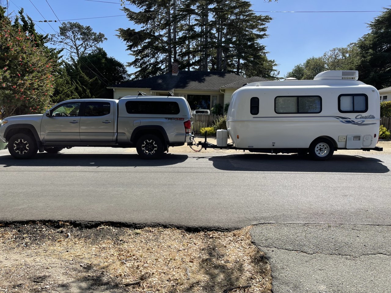

    Towing newbie here. Just got my first trailer and had my first towing experience (approx 250 miles RT, included highway and 6-7% grades up and down). Overall the experience was fine. The engine never seemed stressed out. MPG didn't take a huge hit as I kept it 55-60mph (I know my and my trucks limits....plus no brake controller installed yet and the tires are different brands/psi ratings which sketched me out). I was around 14 mpg.
    The rear is definitely sagging, and feels soooo soft when I lower the trailer on the hitch. I don't like that. And then while towing at lower speeds there was definitely a good deal of bouncing/porpoising. Also don't like that.
    Obviously I need to get a brake controller and new trailer tires asap. And I think I'll go with the Anderson WDH route to aid with the sag and also to provide the necessary safety/stability/comfort I'm looking for as the majority of my towing will occur on winding hilly coastal CA roads and in the Sierras. I understand WDH's may be overkill for a trailer that's only 2400#'s empty, but I think it's probably the right first step in my case....to help with sag and stability in my terrain, where simple sway control bar alone may be problematic.
    If the WDH alone doesn'[t resolve my sagging issues, I'll look into helper springs. Open to suggestions on that approach.

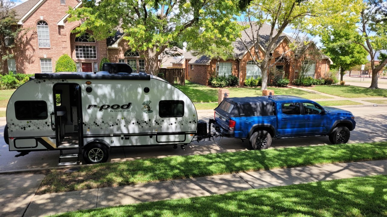

    Recently rented RPOD 190 from Outdoorsy for a camping trip:
    Stats: RPOD 190
    UVW: 2950
    GVWR: approx - 3832
    Hitch Weight: 332
    My Tacoma:
    2017 TRD-OR DCSB -
    OEM Tow package
    Stock suspension
    Falken Wildpeaks A/T3W 265 /70 R16 112T SL
    Added
    Tekonsha 90160 Primus IQ Electronic Brake Control
    Tekonsha Trailer Brake Controller Harness
    SuperSprings SSR-612-40 | SumoSprings Rear for Toyota Tacoma, blue
    I had approximately 450-500 lbs of passenger/gear in the truck, and maybe 150 lbs of food/gear in trailer, plus 30 gallons of fresh water. Regular hitch. This was my first time towing so I was cautious and mostly traveling flat to hilly terrain in Texas and Arkansas. The truck handled this trailer weight with ease with only a few instances where I felt it pushing or porpoising over rough road surfaces. Never felt sway issues from wind or passing trucks, although I pretty much kept it around 60mph on the highway. Truck would cruise mostly in 4th/5th gear and around 3000-4000 rpm depending on terrain. Uphill giving it gas it always seemed to have plenty of power for me, but these were short duration inclines in Arkansas "mountains". Got around 10-11 mpg on the way to AR and camping. However, on the way home, I emptied all the RV tanks. That made a noticeable difference in both feel and mileage. MPG on the way home jumped to 14-15. I definitely would not bother with carrying full fresh water tank again since we were always using city water at parks.
    Summary:
    For me, brake controller and sumo springs I think are a must for towing/carrying any significant weight. Really helped provide good control for braking and the sumo springs did a great job of handling the extra hitch weight, reducing sag, and overall ride quality. I will say ride quality with sumo springs without towing/hauling anything seems a little more harsh over bumps around town than stock bump stops.
    I may buy travel trailer in the future and I think the Tacoma sweet spot for me is trailer GVWR not greater than 4000lbs. I would also get a WD hitch as well. If I were driving really long distances or over the Rockies, I might consider additional trans cooler, but I tend to think Toyota engineered it beyond its documented capabilities.
    rybern, tigernut, Yota.jr and 2 others like this.
