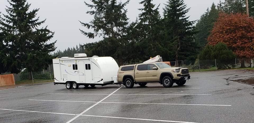

    Just purchased a new to me 2010 Shadow Cruiser S195WBS. Can’t decide if I want to do Air Bags or an AAL.7D32EC15-D8D5-479E-BA6C-4AB17014C0AB.jpg

    Do you have a WDH?

    Not yet…that is my next purchase. Along with a brake controller.

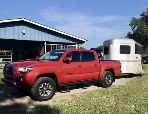

    I wondered about an Anderson hitch for a horse trailer, since they are so low that other WDHs are too low (I tried a couple and bars only 4 inches off pavement). The one thing I read somewhere is that the action of an Anderson can confuse the truck's built in sway control function and you should turn it off. Anyone experience a problem with this? I am towing a 13' stock trailer that weighs 2300 pounds empty and in the pic I have 1000 pounds of sheep in there. It towed well like this without a WDH, but I could potentially add another 1000 pounds or so. This was only 9 lambs and there's room for another 10 easy. Downhill with this load the air drag was enough to hold me back in 3rd. Mileage over 300 km round trip with some decent hills was 17 L/100 km (sorry, not sure what it is in mpg). Truck is a 2017 with towing pkg. Brake control works really well. Trailer is 6'6" wide (above fenders) so mirrors were sufficient. Definitely takes up the lane, almost 8 feet wide at the wheels.
