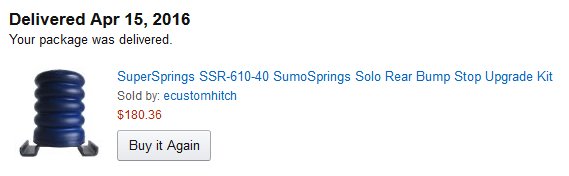

    While this post is not strictly about towing, it might be interesting to those considering air bags or helper springs. I put in SumoSpring helpers ( http://www.amazon.com/SuperSprings-SSR-610-40-SumoSprings-Solo-Upgrade/dp/B00O4GD38M ) for towing. Today I picked up about 800 lbs of dirt to fill a garden bed. I measured the height from the ground to the bottom lip of the rear fender before loading (36 1/2") and with the load (35 1/2"). I plan to tow with around 550 lbs of tongue weight so these SumoSprings seem to really do the job. Easy to install ( about 30 minutes) and no hassles with airing up bags. Smooth ride either with or without the load. That's my 2 cents.

    Wow , I think there has been a run on these sumos since about a week ago because of TW. I went to Amazon to buy them after a thread on TW that day . Ecustomhitch had 5 sets of them on Amazon for $193 with shipping,(I bought 1 set) . By the next morning they were all sold out and the next two lowest sellers were sold out also . Now they are $244 ! Mine are on the pile of goodies waiting for my DCOR LB . It is supposed to be at the dealer this week . Now if only someone would make a good set of Towing mirrors .

    How wide was the trailer ? I may have to get these until someone makes non clipon ones .$180 is what I paid also with 12.95 Shipping for the sumos
